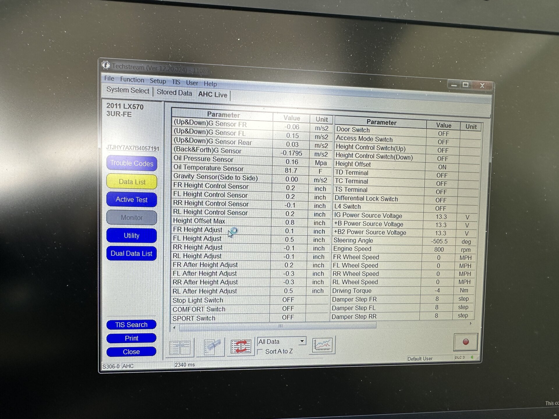

If you look at the AHC Datalist in Techstream, the AHC ecu actually tracks the speed at each wheel. I suspect the dashboard gets a single speed from one of the ECUs (Guessing the ABS/Skid Control) that probably uses the 4 signals to generate one speed (i would assume whatever the lowest speed is). This probably complicates using something like the inline speedometer calibration tool to work on the AHC ECU.

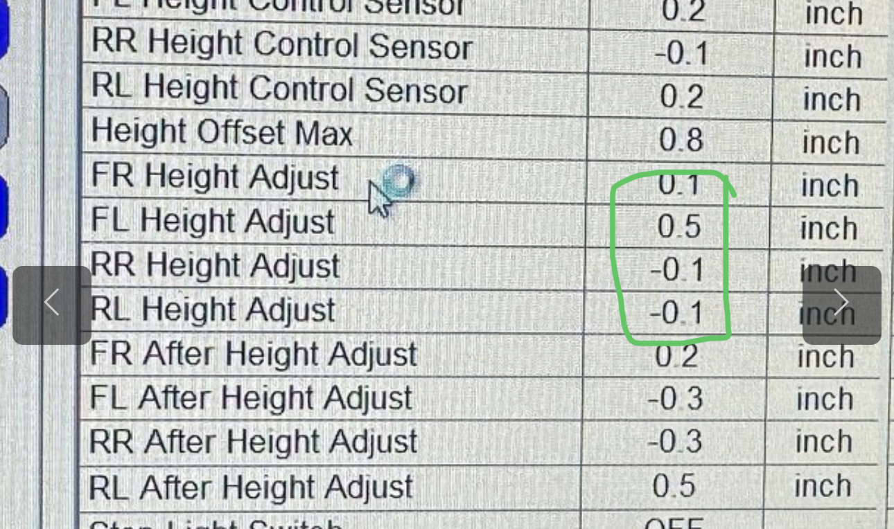

Hi @radman is the value Step 4: Start HOU. Select FL, enter measured value of "4.5", enter standard value of "4.0" standard or would it vary?
I would like to do it to mine and I have these measurements currently. N on neutral ground
@radman
Forgive me, just got a 14 LX and don't want to screw it up, I ender my calculated 4.x value and a stock value of 4.0 on this popup, right?
