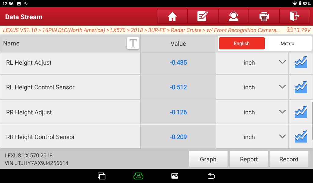

Can someone help me understand this. This is the output for the AHC height control. I believe the "XX Height Adjust" outputs are the current offsets programmed into the truck(I am using a Launch X431 tablet, not Techstream) as they do not change as you raise and lower the truck, but they do change when you change height offset. So, since +0.8" is the maximum offset possible, and my current highest Adjustment is a RR at -0.126", does that mean I can add 0.9" to all sensors to get the RR to +0.8"?
Can someone help me understand this. This is the output for the AHC height control. I believe the "XX Height Adjust" outputs are the current offsets programmed into the truck as they do not change as you raise and lower the truck, but they do change when you change height offset. So, since +0.8" is the maximum offset possible, and my current highest Adjustment is a RR at -0.126", does that mean I can add 0.9" to all sensors to get the RR to +0.8"?
View attachment 3688685View attachment 3688684
Nevermind. I got it. For some reason the HOU was not letting me go straight to 0.9" increase on all sensors. It accepted 0.9 on RR but none of the others. For some reason I had to incrementally increase each of the other 3 corners to get to 0.9" increase. so like go +0.3, +0.3, +0.3 for a total of .9
