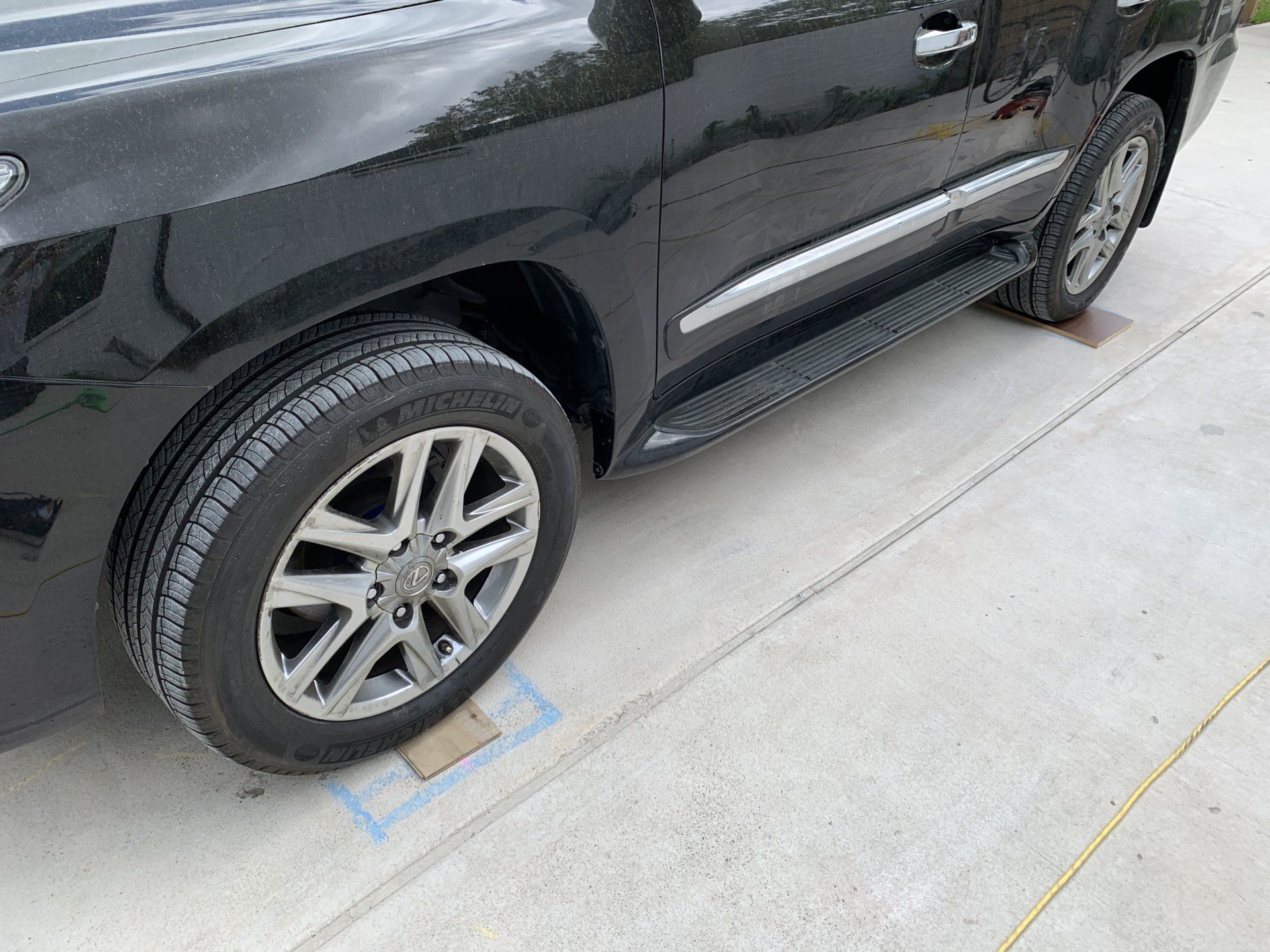

Step 1: Find Level Ground. I'm not sure how picky the rig is, so I'm within 1/4" on all 4 corners using various thicknesses of wood.

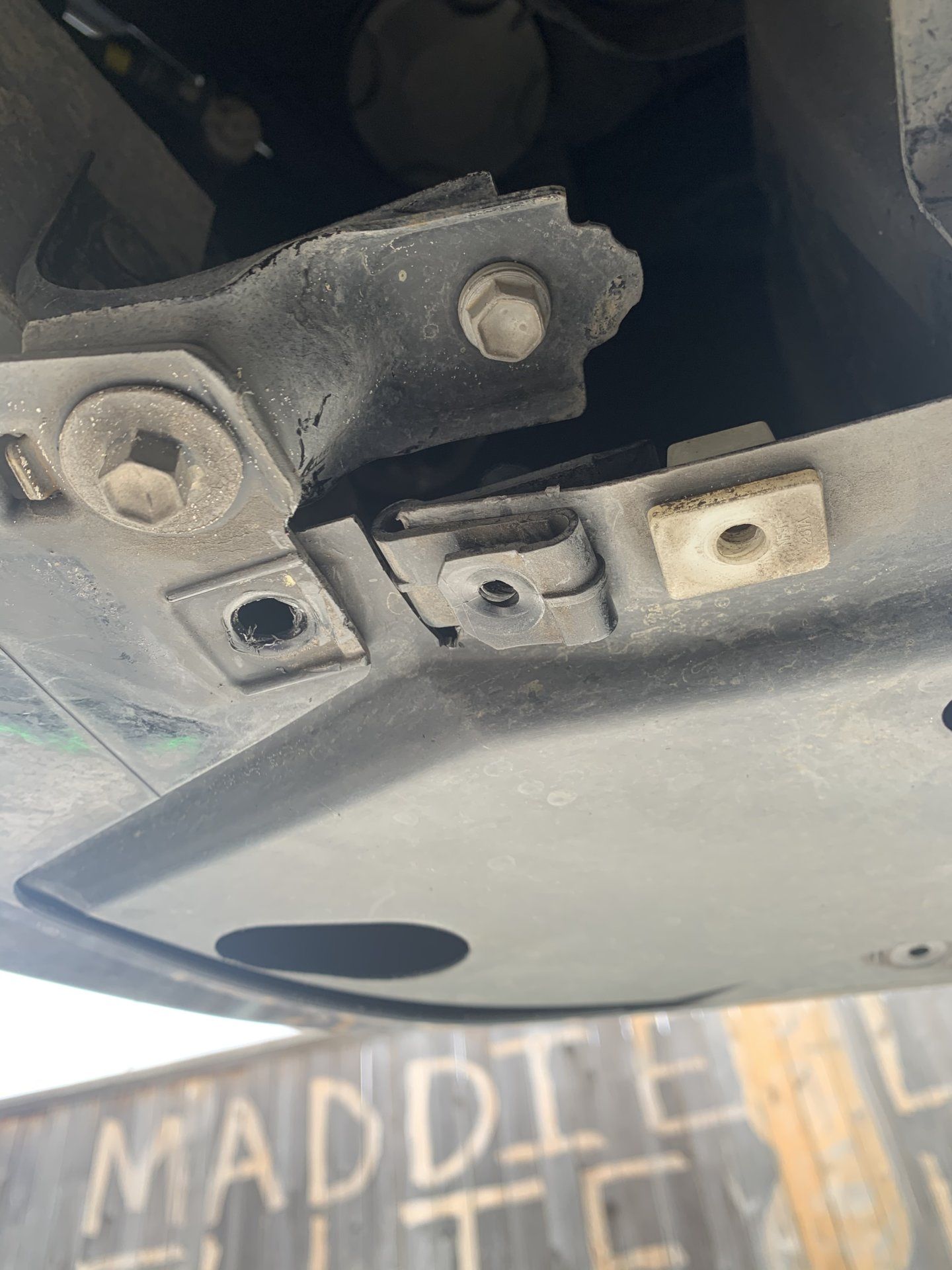

Moving the front liner is extremely easy. I was confused when I initially read @TeCKis300 and @grinchy's posts about z-clips and slots, but it all made sense once I was down there.
Here's where it sits stock. New hole drilled and slot cut with a box cutter.
Here's the z-clip in the new location. After this, just had to push it forward, line up the holes, and put the screw back it.

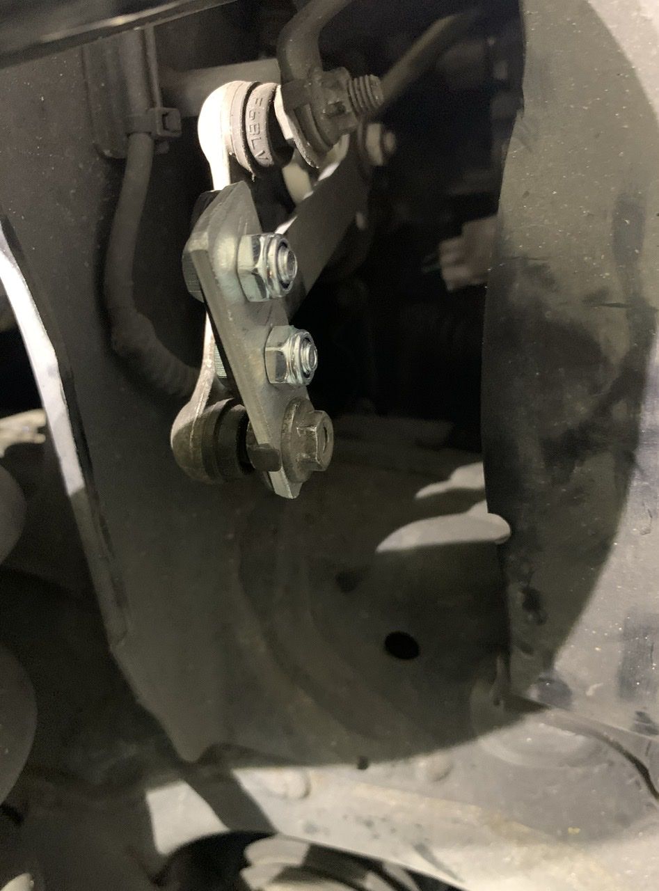

In case you need some more height, I made some simple aluminum brackets in the front to adjust the sensors more.
I had tried that myself, but in my garage and starting on only the front, it would not stay in H mode. It dropped back to N, so I assumed this wasn't going to work. Please let us know how your truck is reacting.
Mine did the same at first but works fine now. Seems like it just had to re-learn the new sensor height. L/N/H pictures below. 35/12.5/17
