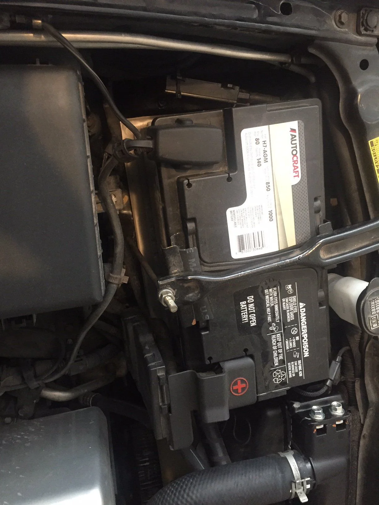

AGM battery upgrade
Keep it Simple - H-7 AGM fits great, and has more than adequate starting /reserve power
$199 at Advance Auto ( and can usually find 25% off online) 3 year full replacement, locations just about everywhere...
I've had this one in for a couple years, no issues, no special charger or alternator changes.... Also run two of them in my diesel, starts great winter and summer.
When you changed out the battery, did you put something underneath the H7 battery to bring it up to the proper height to meet the stock battery brace? I have the same battery with the same diode mode, i'm about to fabricate a top bracket, but thinking that putting something underneath the battery to raise it up to the proper height might be an easier solution. Thanks in advance. -Mark
