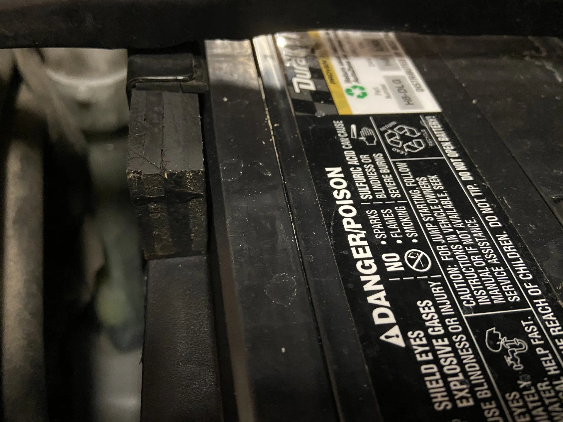

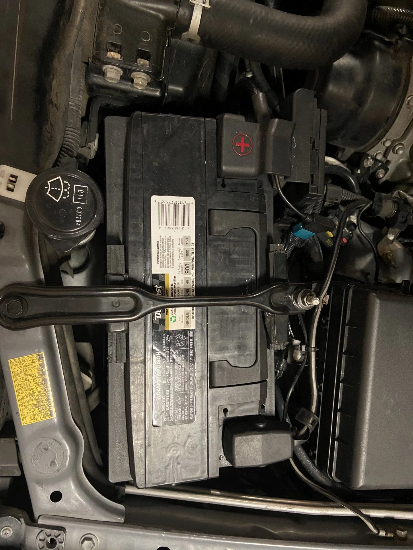

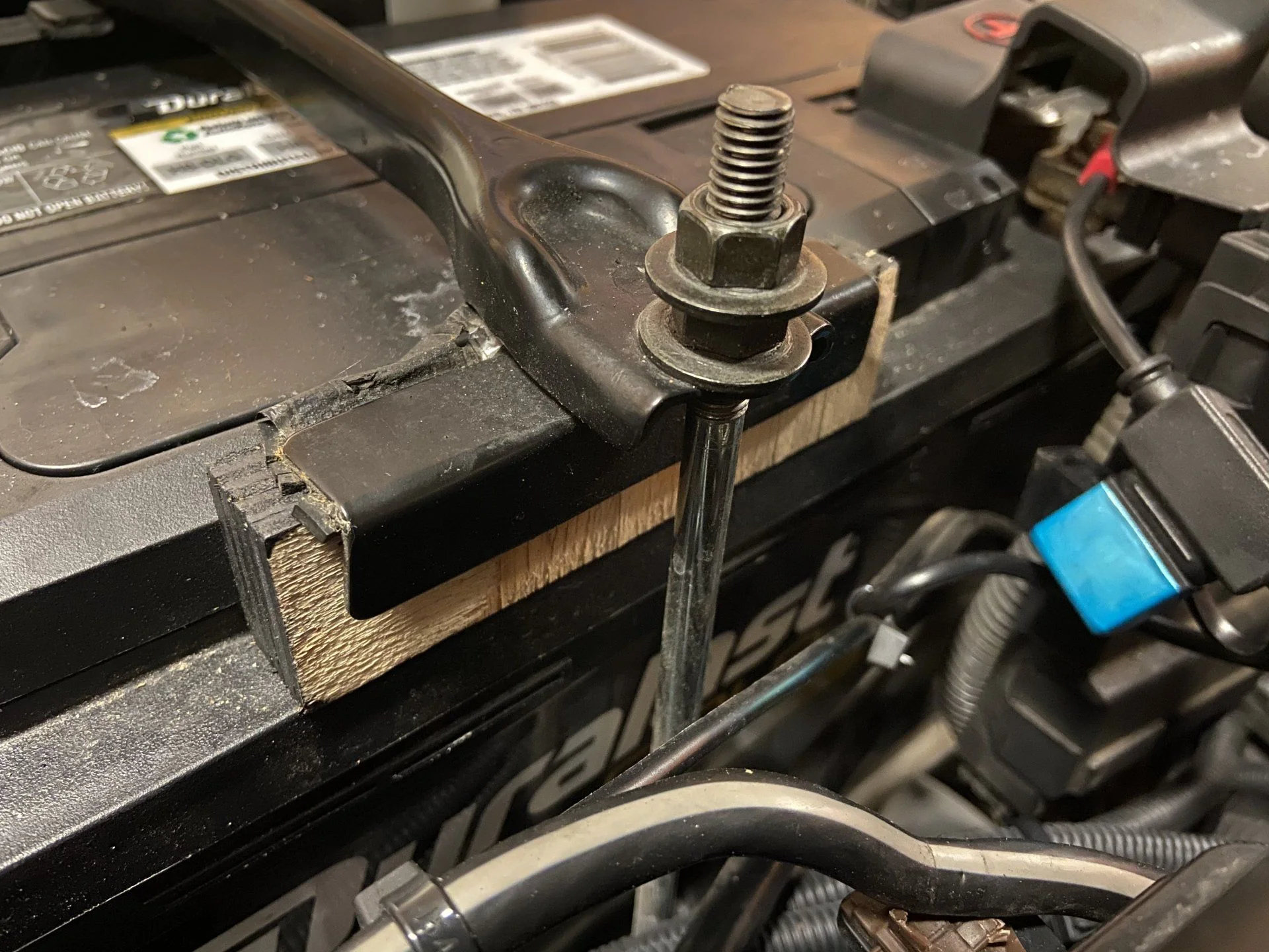

for me I used a Group 49 (NOT an AGM battery = SealedLeadAcid) and made some plywood blocks (with a shot of black spray paint) to take up space on the stock battery hold down. Rated CCA is 900. I am also holding out for Lithium prices coming down substantially some time in the future. Love the BattleBorn units (Lithium), but can't stomach the price at this time.

for me I used a Group 49 (H8) and made some plywood blocks (with a shot of black spray paint) to take up space on the stock battery hold down. Rated CCA is 900. I am also holding out for Lithium prices coming down substantially. Love the BattleBorn units, but can't stomach the price at this time.

Ahh I see, that's an easy fix. Whats the advantage of this battery/method over a 27 or 24 group?
sorry, should have noted the biggest thing I notice is during cranking (no hesitation like the 27 I had in it) and although Reserve Capacity states 150...it seems like more. I do keep a Noco GB40 as a Jump Pack...just in case (only running one battery). @geanes may have some feedback for his experience(s).
Higher cranking amps and a bigger reserve.
