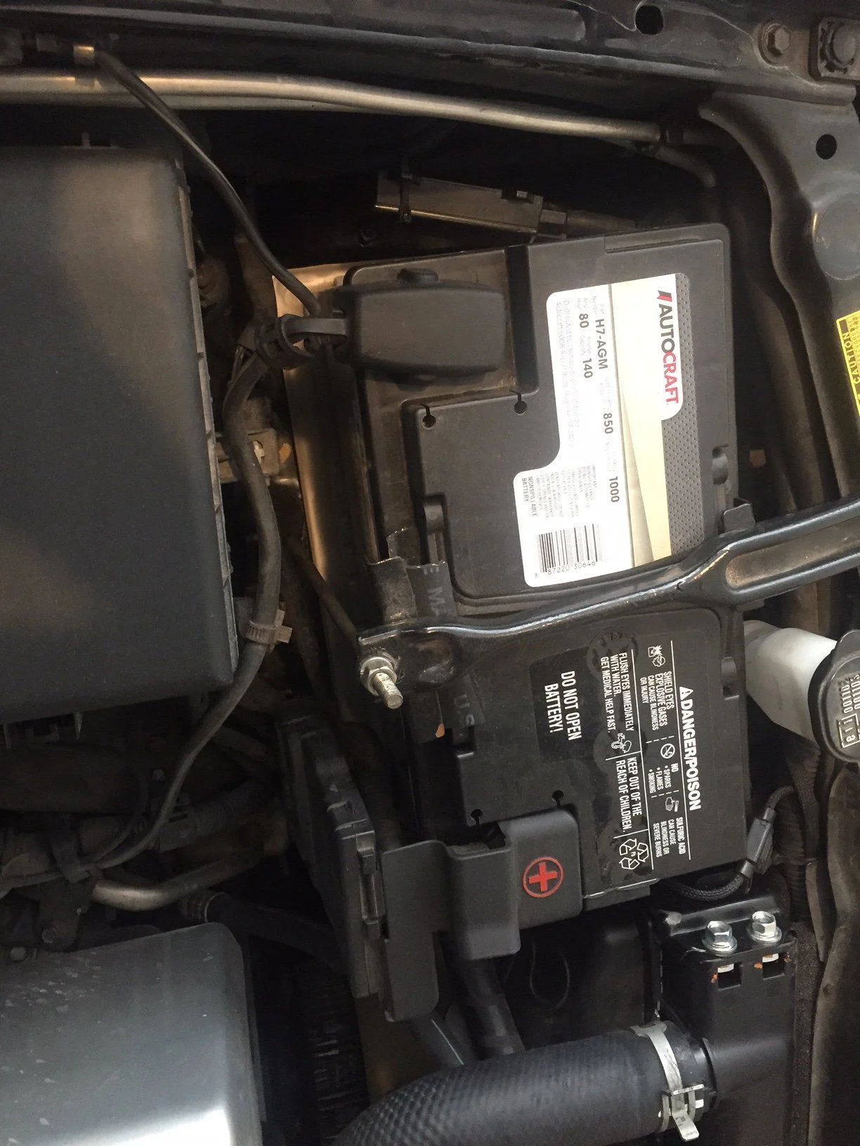

I have had good results with the AGM H7 starting battery and H5 house battery from Advance Auto. I chose the H7 battery instead of the H8 because it is not quite as long and gave me a little more room for winch and dual battery cables. The H series batteries are shorter than the stock Group 24/27F and I needed a spacer to raise it up to utilize the factory battery tie down. I used a generic group 34 plastic spacer.

Keep it Simple - H-7 AGM fits great, and has more than adequate starting /reserve power
$199 at Advance Auto ( and can usually find 25% off online) 3 year full replacement, locations just about everywhere...
I've had this one in for a couple years, no issues, no special charger or alternator changes.... Also run two of them in my diesel, starts great winter and summer.
