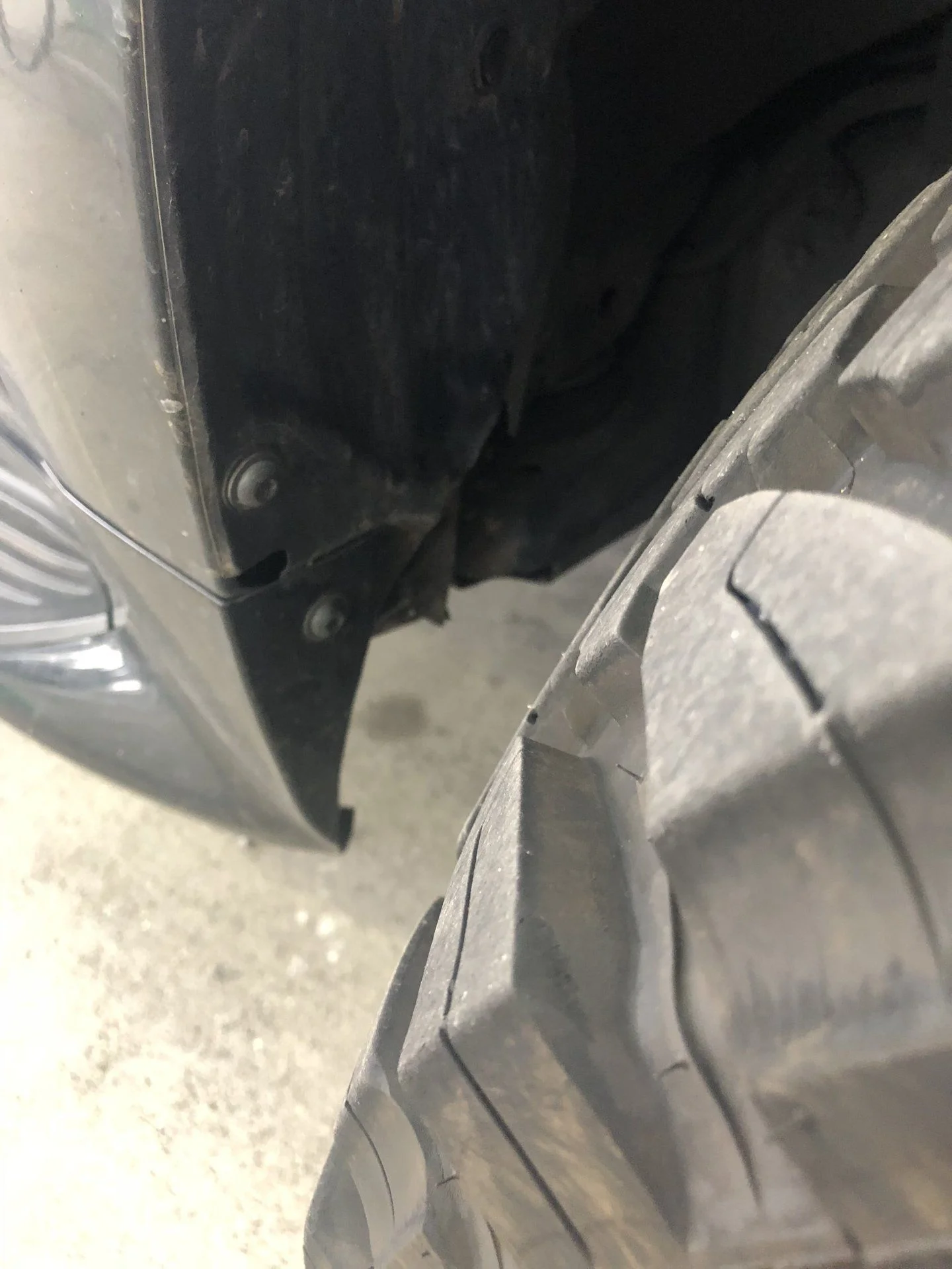

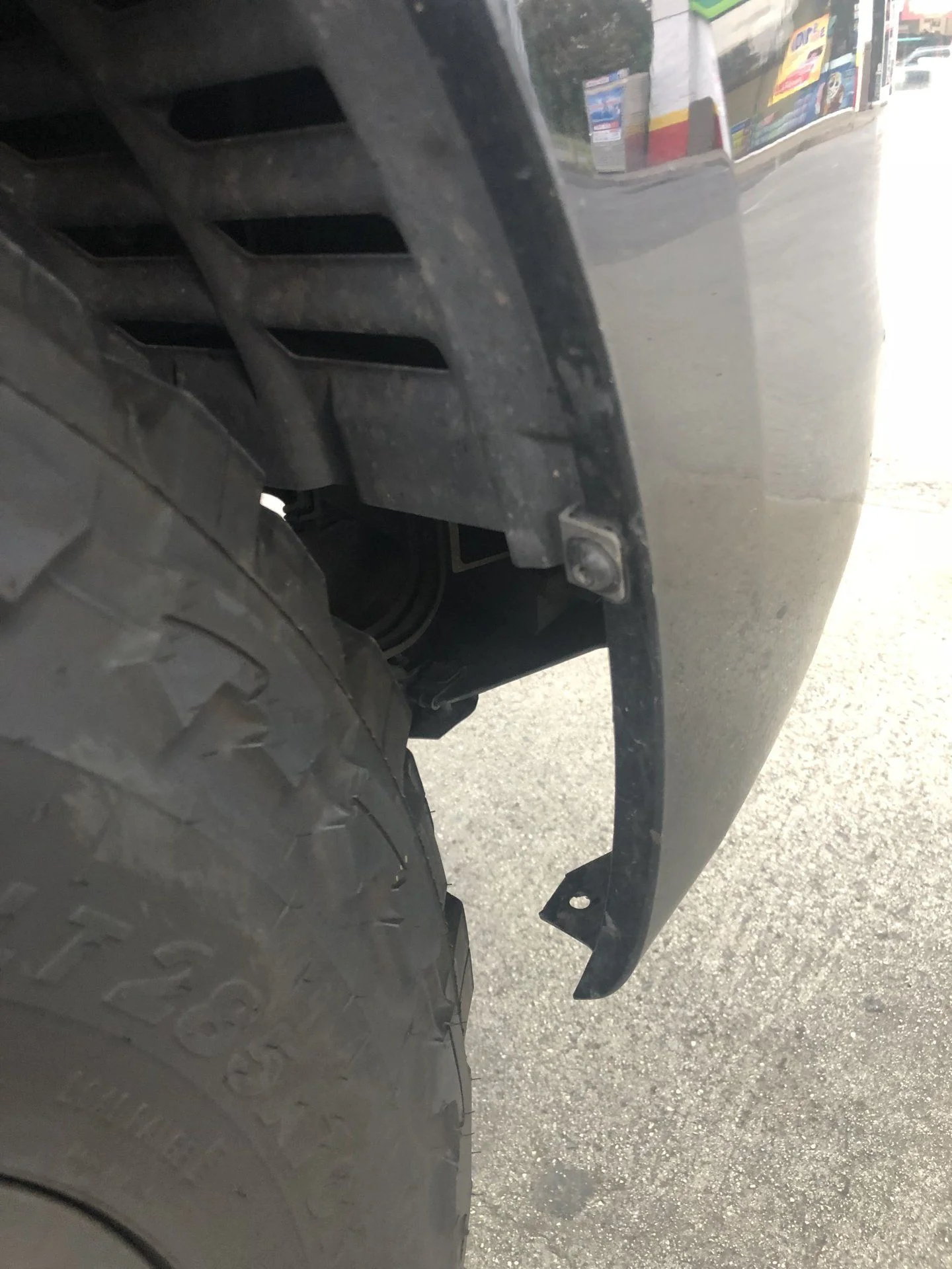

Looks great! Any rubbing with that setup?
I took it to ACC Garage to have sensor/techstream lift. Removed mud flaps and had to trim a bit.

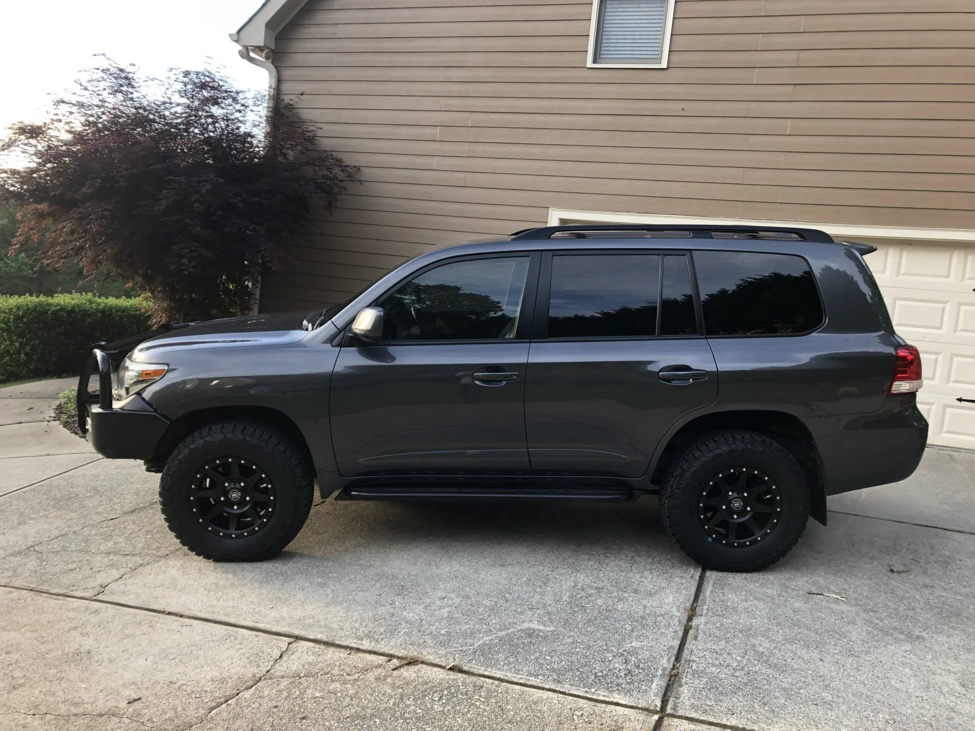

Gotta a little something in the mail earlier this week:D....
Dropped off the cruiser at Cruiser Oufitters to get a little something installed so that the above little somethings would fit....:D:D
Hit the tire store this morning, and made it all happen. Pretty darn happy so far!
what wheel is this? Specs? I like! :geek:

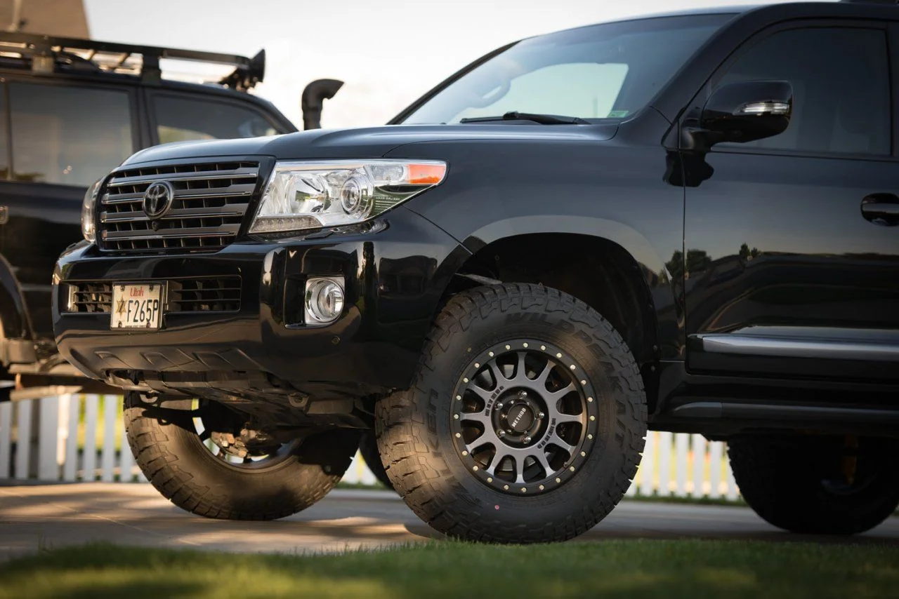

Looking for 17" wheels for my 2015. Almost certain it will get a standard OME 1.5" lift. Not being able to find Rock Warriors, I started talking ot my shop about the Icon Rebounds which have a +25 offset, and seems several here are using without issue. He suggested the following Method's which I liked better and he said had the same specs:
Which I did like better due to the lack of the fake bead lock. But they are a 0 offset. He claims they should work fine, but I feel like they will stick out too much and potentially cause problems when flexed.
Which leads me to these which I think look better with the +25 offset
Thoughts? I had methods on my last build and liked them, but haven't seen a lot of cruisers wit hanything but the NV's.

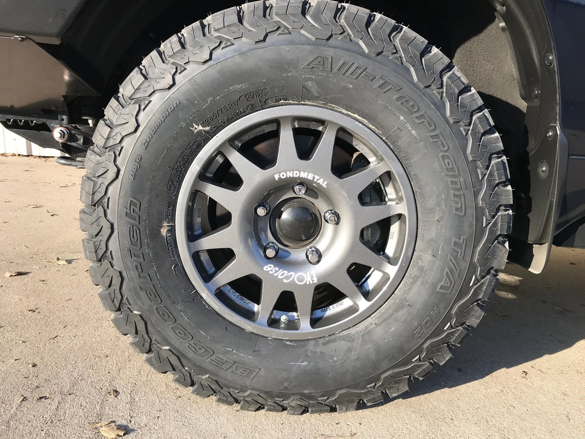

Is anyone running the 18 inch Evo Corse wheels on a 200? I have searched high and low and all I see is everyone is running the 17's. I was thinking about swapping out my SCS wheels (no issues) to the Evo's and wanted to reuse my tires.
The 18 inch DakarZeros might not be available yet (new product). Even availability of the 17’s has been slim.
I have some on order. I initially ordered 17's in January but they still hadn't arrived when the 18's came out. I switched the order to the 18's and was told 2-3 weeks plus shipping. That was five weeks ago. I'm hoping to see them before the end of the month.
I’m in the same boat, but I have 17’s on order. Also hoping to see them before the end of the month.
Def post pics when you get them in!!!! I am thinking that I want to make the switch to them.
