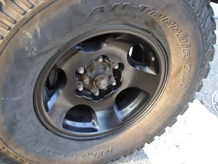

If you like your stock wheels you could just paint them black or look into having them powder coated- it might be cheaper than buying new wheels.
just paint them black.

Just painting alloys is a chip off nightmare (i've done it before)
Honestly, mine have not chipped at all, except scrapped where i hit them on rocks while wheelin'. But as far as road debris chips, i have none. Been painted for about 2 months.
plus rattle can is easy to touch up :)
I painted my rims. About $20 or so at Home Depot.
A heck of a lot cheaper than $200 for new rims or close to that for the powder coating.
And like others have said, Rattle can is super easy touch up.

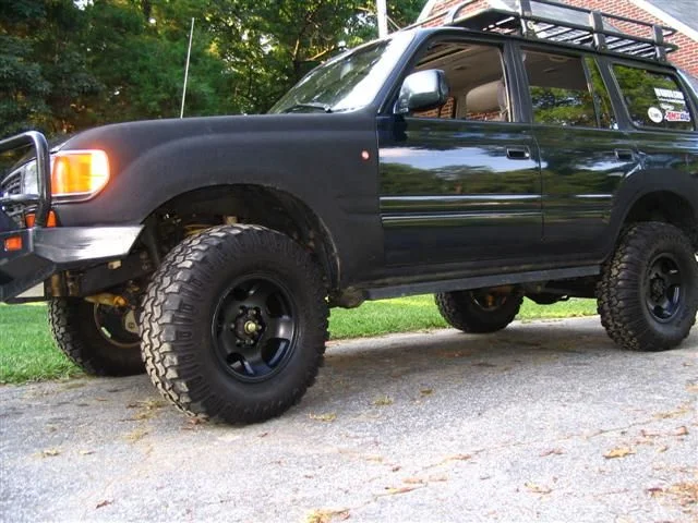

If you check out my sig you can see the blackies I just got for my 80. I picked them up at Les Schwab, I THINK they were Ultra's, but I can check my invoice if you think they might work for you. I've been really happy with them, they take the rocks pretty well.
