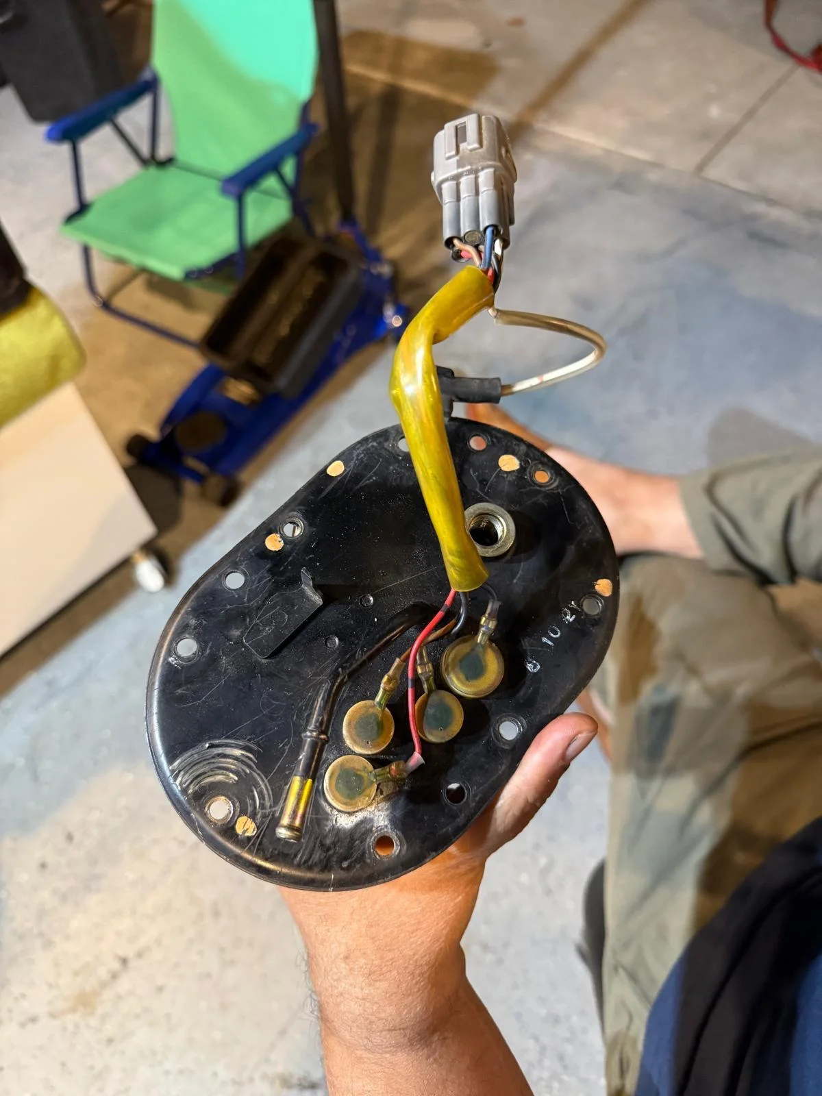

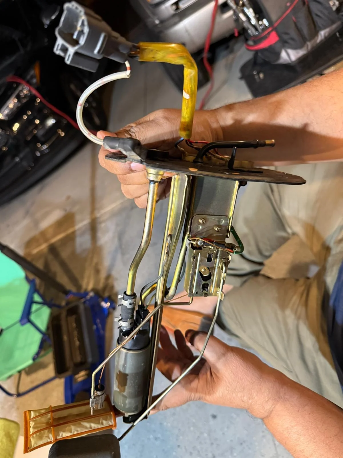

The fuel pump is acting up. Intermittent. Shuts off randomly. Are there any recommendations for an after market pump? OEM is around $375. Thanks.

I'm running the Denso v8 4Runner fuel pump and it works great. You need to change the electrical plug (included in the kit). It is an easy change.

might not be the pump. Check under those plastic caps on the assembly for possible corrosion.
