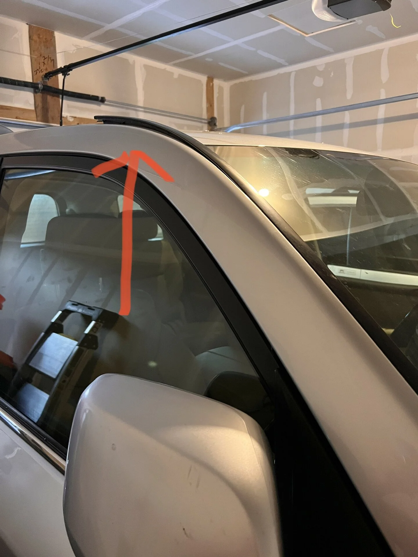

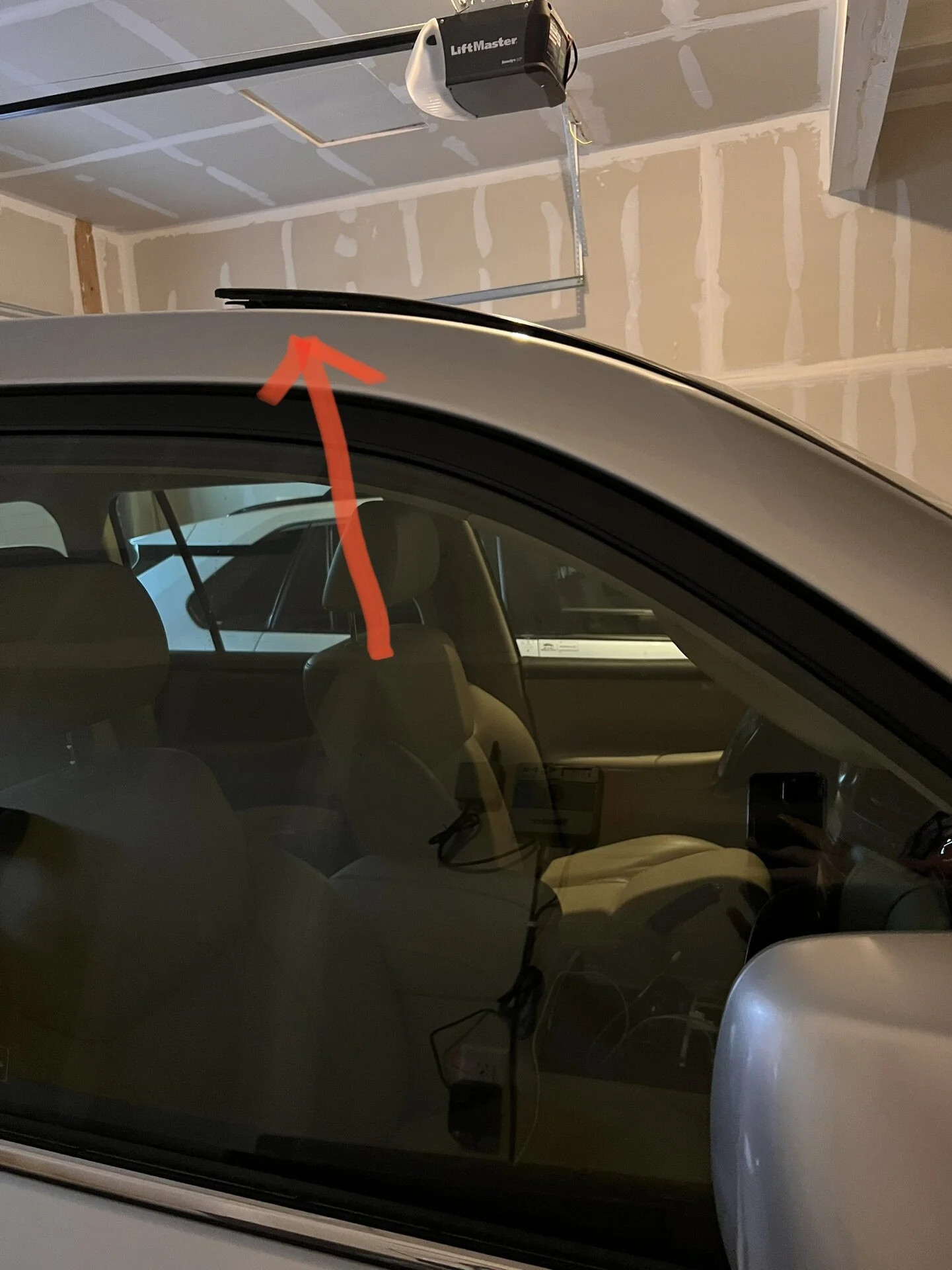

The windshield molding on my 2008 LX 570 is hanging and is no longer sealed on top of the windshield/roof. The molding itself is intact and appears that it just needs to be re-sealed with an adhesive. The molding does 'click' back into place on the roof, but it comes loose again after 30 mins of driving. Does anyone know the correct adhesive to use and any tips/tricks to consider when re-sealing? Thanks for the help folks!
Either the clip got bent or the trim plastic deformed that is no longer held in place. Depending on how good of a fix you want you may just glue it, but not sure what adhesive will work, or troubleshoot and see if the clip or the trim are the issue and fix/replace.
Factory service manual calls for the stainless clip to be bonded to the channel in the body with “flexible epoxy”.
I had the same issue when I got my 200. I found a product made by Total Boat for fiberglass boat repair on Amazon when I did my windshield trim and it has held up great for over 90k miles through a subsequent windshield replacement and trim removal. The glass tech thought the clips were factory installed because they didn’t pull off when he removed the trim.
Personally I’d get new clips and use the above product. Note that you need to clean the channel very well. There may not be room without removing the trim completely.. and that may destroy it. If you remove the trim, definitely get the white clips that hold the trim to the windshield frame.

Had this same problem for over a year on my '09 LX. I would pop it in, and later on it would pop back out. My fast fix for a roadtrip was Gorilla taping it down to the rubber trim piece behind it. I think all the popping in & out wore down the plastic on the molding, so that it wouldn't stay in the clip.
