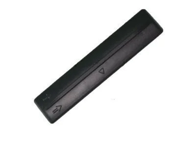

Hi there -- just purchased an '11 LX and trying to figure out exactly what the roof gutter molding should look like on a stock vehicle. Mine seems to have gaps every so often, and I can't seem to decipher the parts catalog diagrams to figure out if that's normal or if my LX is missing some pieces. Thank you in advance!
I think you might be missing the molding finishing covers:
Part number​
7559635030
There should be no gaps. Just rubber, roof rack feet, or the plastic cover shown above, from the top of the windshield all the way back to the spoiler. If the cover above is missing there will be a metal bracket remaining. If it's not that, it's one of the rubber/metal strips.

Anyone have the parts diagrams/number listing for all of them?
LC and LX, after the windshield trim, rubber parts front to back
a. 75551-60110
b. 75551-60110 (same)
c. 75555-60020
d. 75555-60020 (same)
e. 75554-60040
Each roof will also have one plastic 75596-35030 per side.. the location (between a&b or b&c) depends on whether it's a LC with the longer rack or LX with the shorter one.
