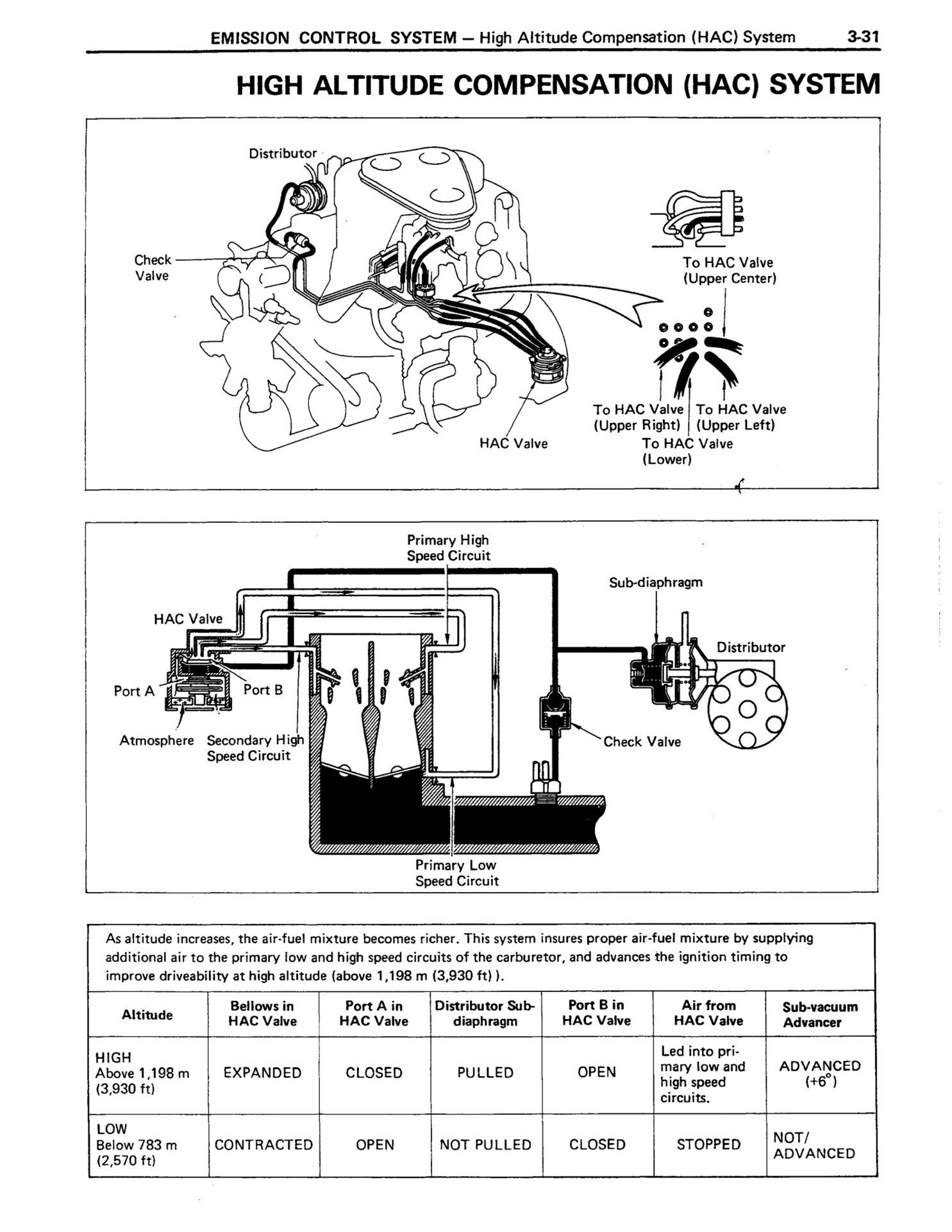

I’ve got a completely desmogged truck now with a jimc distributor and a city racer carb.
I’ve got the red HAC pod and nothing else. Where should i start to add the HAC back to my truck? Can i have the hac be switch or manual valve operated when I reach elevation?
I’m driving into CO in September and I’d like it to be all in order.
