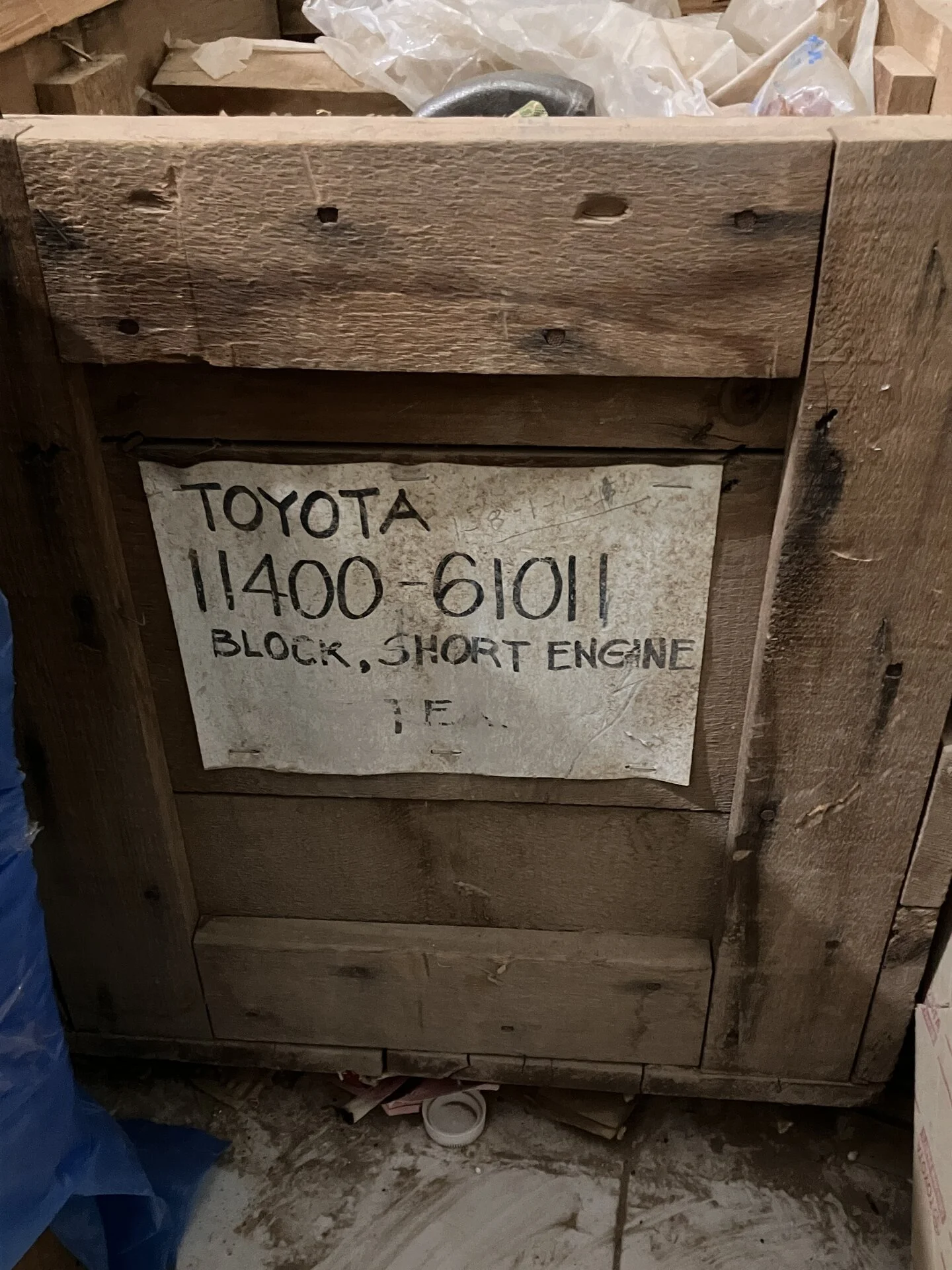

wonder if this is still available, last new 2F I recall
