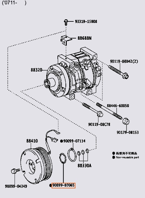

The diagrams show 88410-6A090 as the part number for the clutch assy on a 2011 LX
90099-07065
90099-07114
88335-14020
All look like small parts you should probably get to do the job.
90099-07065
90099-07114
88335-14020
Not sure if any kind of puller or whatever is necessary

@bloc Thanks for the part numbers. Definitely going to give this a go.
