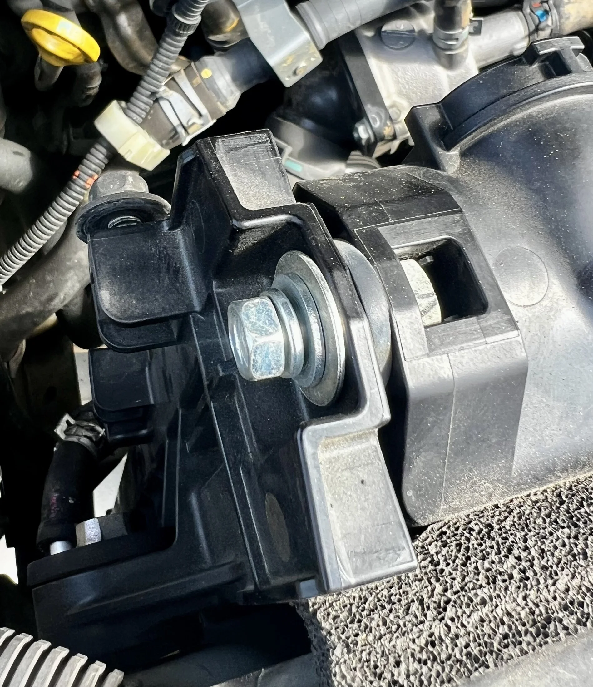

The 5mm allen head on the tensioner likes to round out, even without corrosion. A new bolt and a bolt extractor bit would be good to have on hand. I ended up finding one at Ace that was a few millimeters too long and just ground it to size, but there is an official Toyota part number.

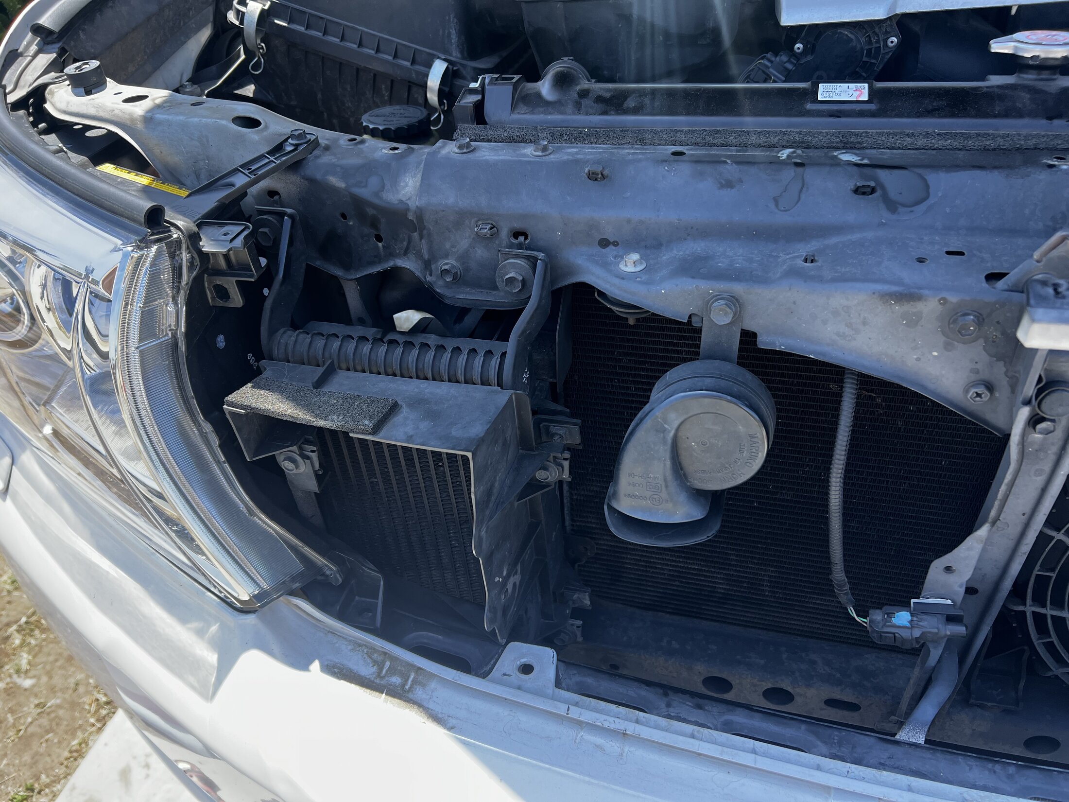

Cant for the life of me get the lower passenger side radiator bolt off, cant even get socket on it
Got extensions, got swivels, can’t get past the AT cooler for the life of me.
FSM says it has to come off, and as does the front bumper, but many here said the bumper doesn’t have to come off. Did yall have to remove the AT cooler?

Being a stubborn SOB and refusing to accept defeat, went and took another look at it
Puzzled as to why folks and FSM struggle with the main bolt rather than the easy access ones on the bracket, thought they’d be a catch/reason, but I figured I’d try that route rather than taking even more stuff apart I didn’t have to.
Had it out in 5 mins, with no damage.
Hmmmm
Yeah…. Not sure what I’m missing, but this is an asston easier:

It depends on the year, mostly. On my 13 LC I can stare right at the front of that bolt through a lower grille opening. So I didn’t know why some respected users here were swearing up and down that what you did was easier. Turns out…
Ahhh.. gotcha..
You’re AT cooler must be in a different spot. Mine is totally blocking that bolt, and seems like quite an ordeal to remove it.
Thanks for info. Now I don’t feel so dumb
