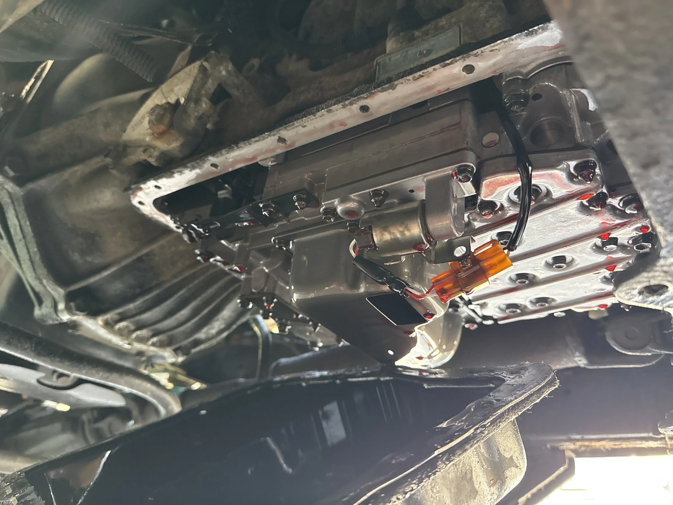

I bought 4 transmission solenoids from Cobra Transmission. They said they were for the A440F AND A442F or whatever the FZJ80 has haha. I tore my tranny apart and found 1 cylindrical solenoid that I have no idea how to remove too. No videos or write ups on it that I could find. I wanted to verify if part: 85420-60010 is what I need and how to go about changing it out? I made a post on my symptoms a while back but here's what's been happening (and it's gotten much worse over time) Hoping to the good lord this can fix it -

The only solenoid in the A440F (91/92 FJ80) is for cruise control unlocking of the torque converter in certain conditions. In reality it does nothing of any consequence and will not effect shifting as it is 100% hydraulic.

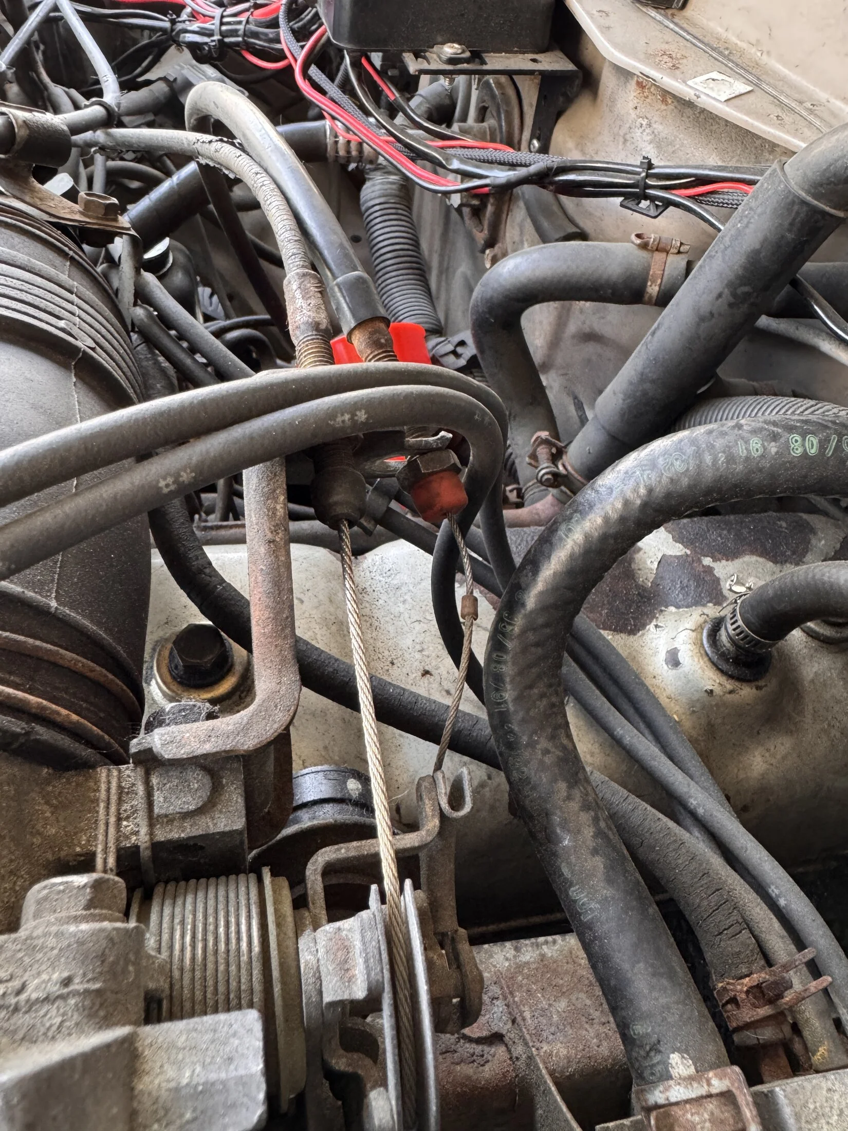

So here's what the cable looks like... The little metal cylinder on the wire should be much closer to the orange stop no? I'm at max tightness
and it's still SUPER loose. How do i get it to retract?
your kick down cable needs adjustment, its way off!! Should only be 1-2mm from the stop.

So here's what the cable looks like... The little metal cylinder on the wire should be much closer to the orange stop no? I'm at max tightness and it's still SUPER loose. How do i get it to retract?
That looks like the cable is disconnected at the transmission end. There's no way it should be that loose.
