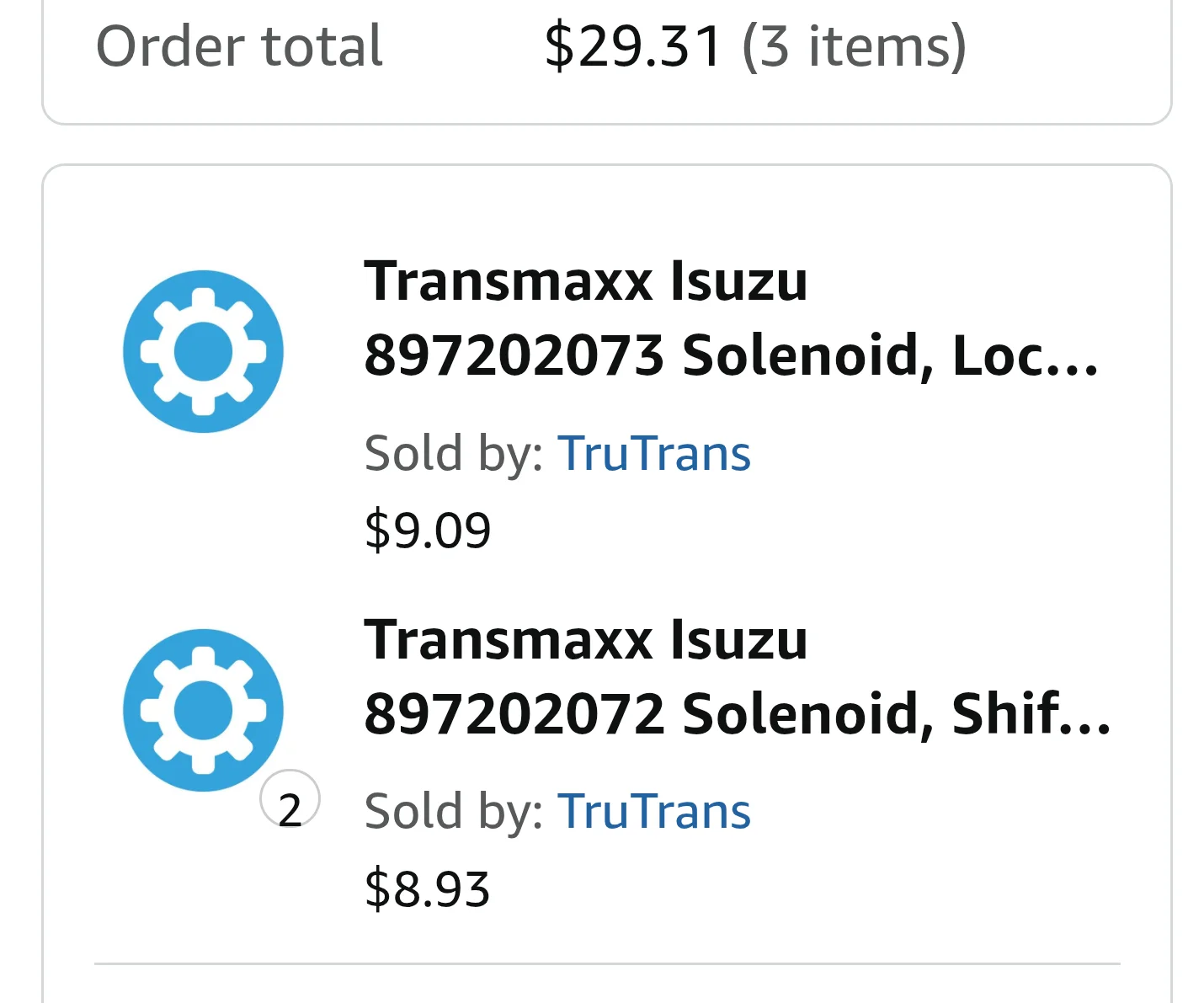

Mine is a 1993 and bought mine off Amazon. Same part used on Isuzu.
Not sure if csn use for your 97...

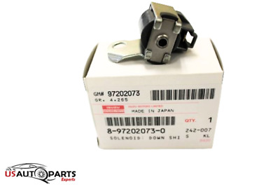

AW450-43LEIsuzu NPRToyota A442F
Qntydescription
21-2 shiftD49422A8-9720272085420-60050replaces85420-60020
1Lock-upD49425A8-9720273085420-60060replaces85420-60030
1TimingD49421A8-9720274085420-60070replaces85420-60040
