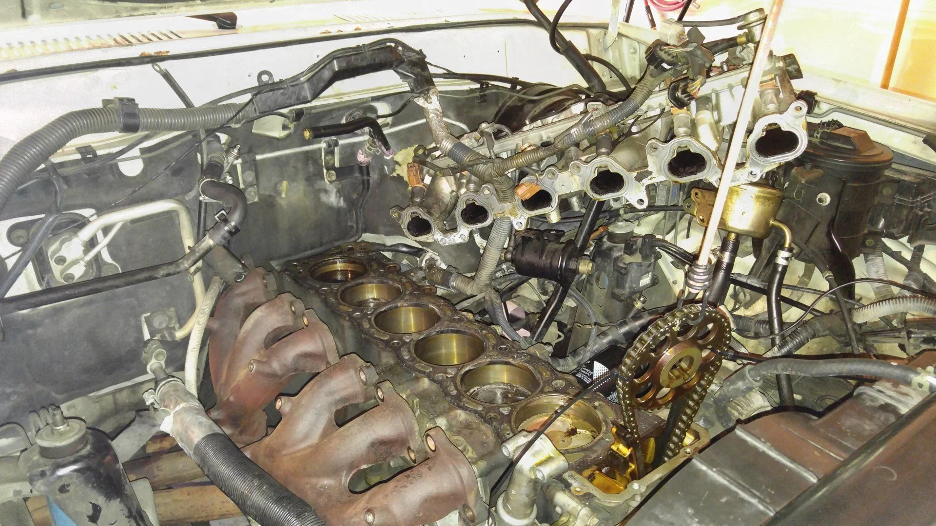

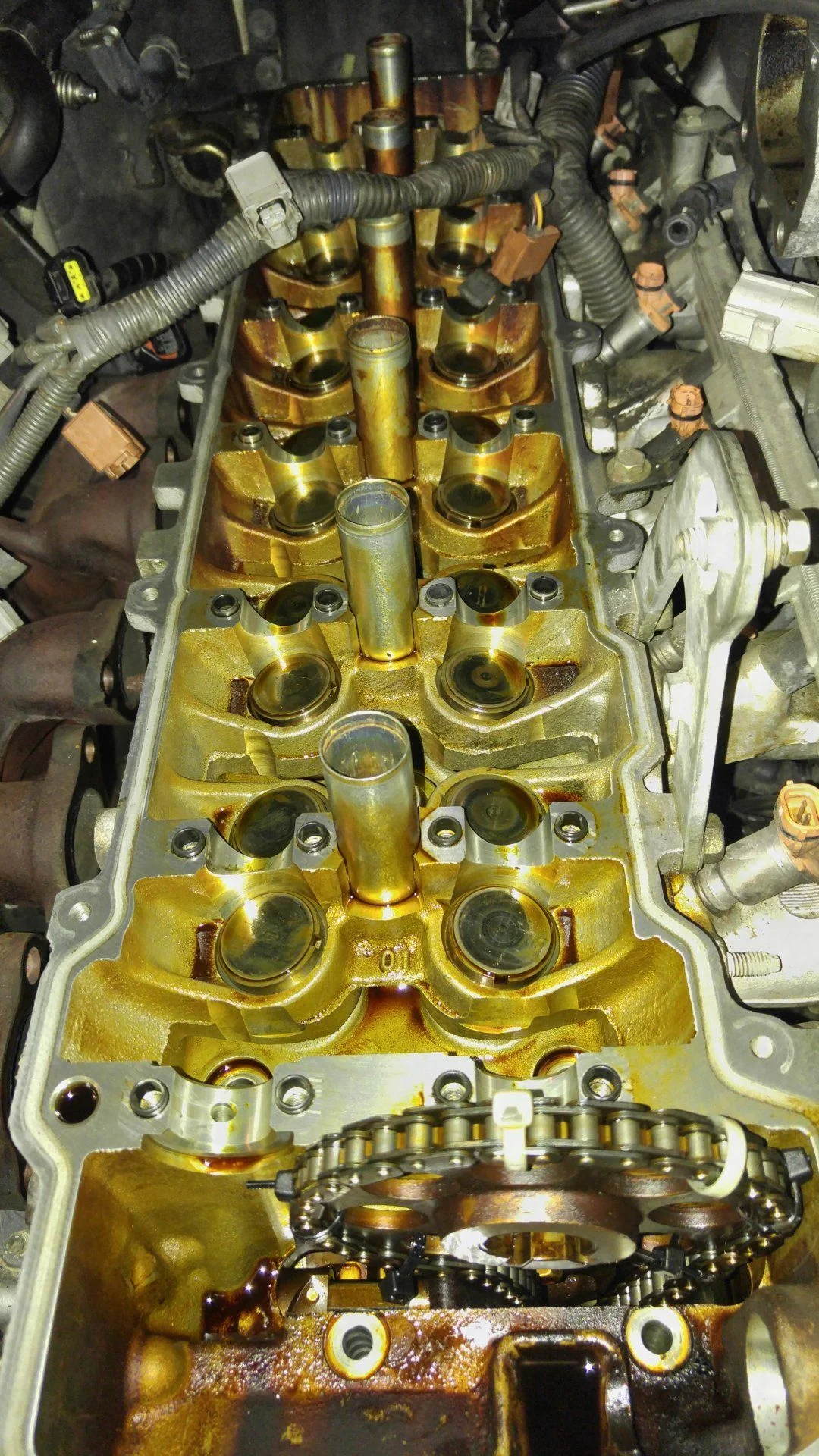

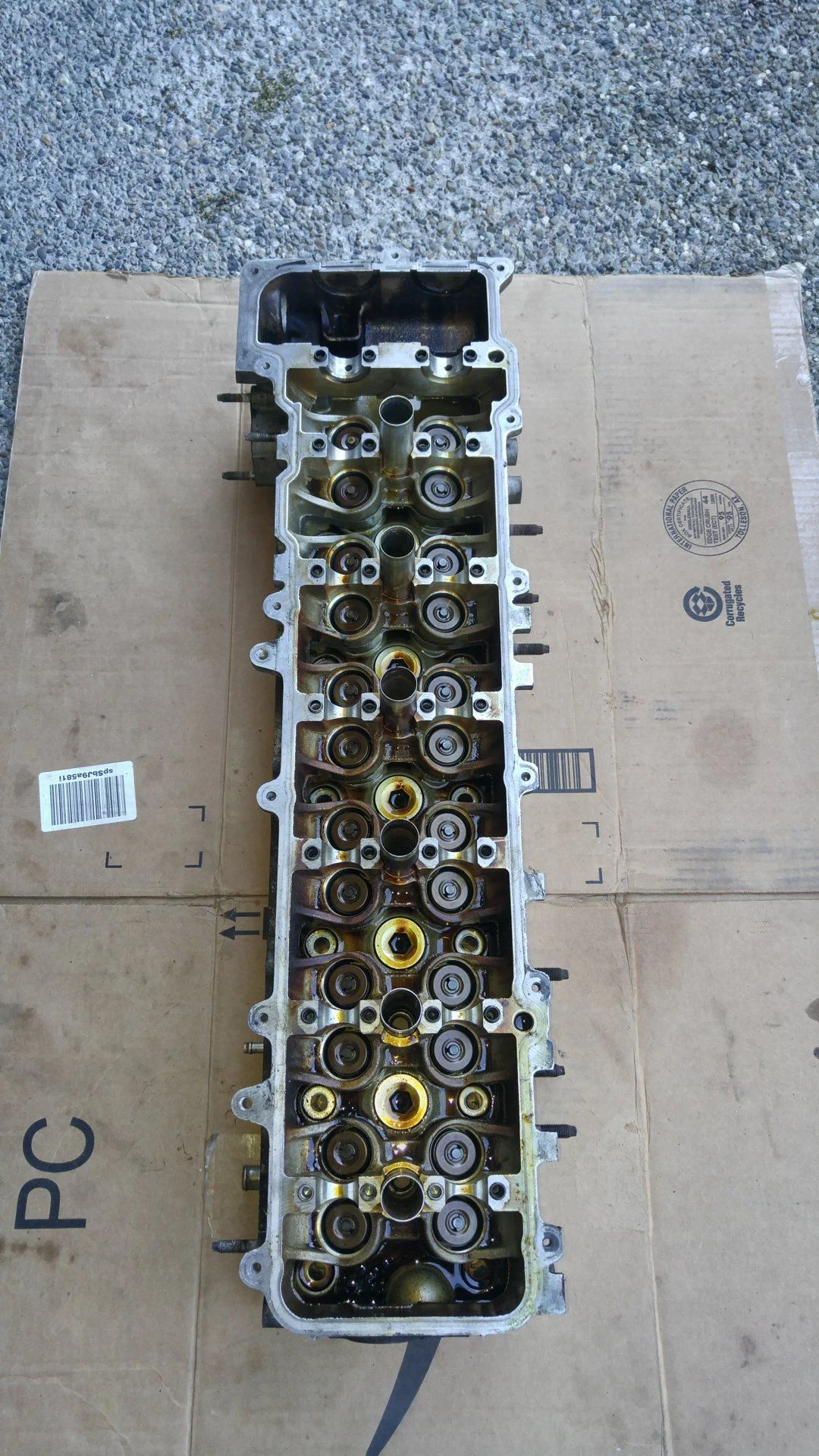

Ok after vacation with family and inlaws and getting buried in work I finally got the head off. What do you all think/see?
The block still has cross hatching but I'm no expert. Curious to what others think.
Old trick, I always replace the head bolts, take a couple of old ones and cut the heads off, now grind a slot in the ends. Clean up and install the studs loosely in the block, now drop your gasket on, you will find it is now easier to slide the head on, the gasket stays in place, now simply use a screwdriver to remove your guide studs.
Regards
Dave
How's the block deck look?
When i just did mine i had some pitting that i could have probably thrown on a gasket and called good, but ended up doing a full build after decking the head and block.
I was also a :banana: maybe :banana::banana: mechanic before but spending hours reading on here and using the FSM and THINKING through i was able to do a full engine build and am now driving it daily.
Pull the old gasket and snap some photos of underneath. Rule of thumb is if you can catch your nail in it, probably needs to be decked.
Good progress, I'm sure it feels good to be near the turning point of going from pulling things apart to putting things back together.
Only tidbit that I'll add, which I didn't see mentioned above, is that you should replace the head bolts with new / OE for the reinstall.
