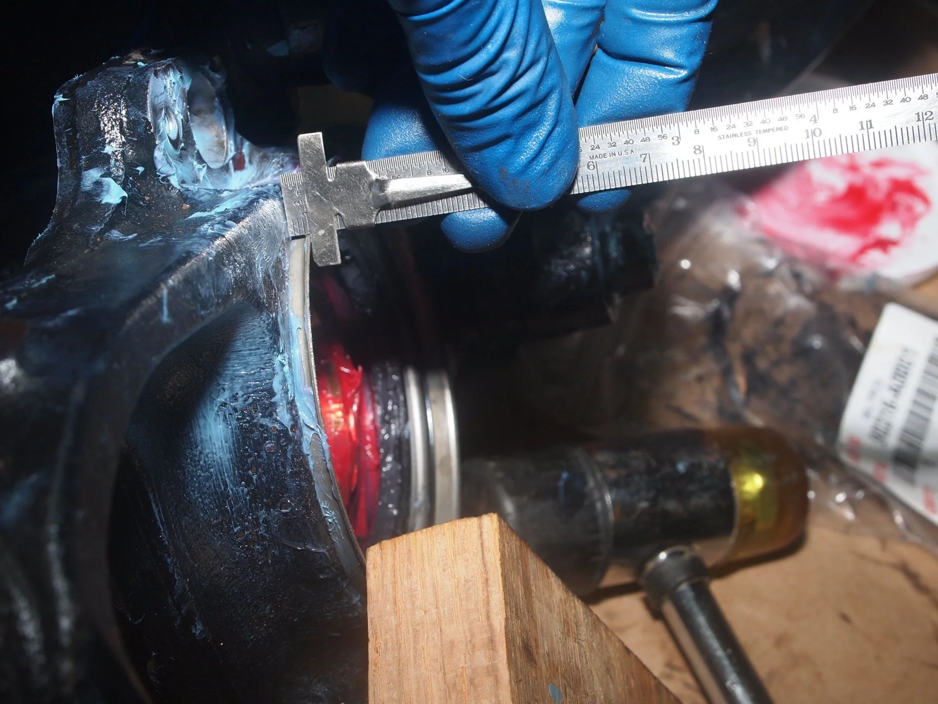

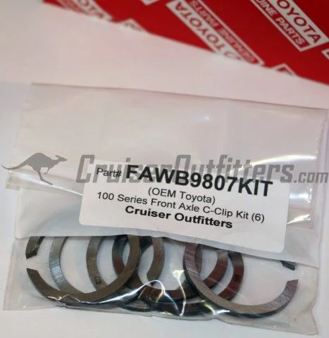

Did you verify that the bearings were not worn before re-packing? Also, any chance that you are hearing the spindle bearings? Were they greased as well? Did you verify the play on the snap ring? At 186K I would expect that you need a thicker snap ring.
Where does one source a new snap ring for the axle? Mine are a little loose and I'm not entirely sure where to buy a replacement one that's a little thicker.
They shouldn't cost more than 2$ each.
90520-31005 2.8
90520-31006 2.6
90520-31007 2.4
90520-31008 2.2
90520-31009 2
90520-31010 1.8

I bought them all as I didn’t know what size would be needed. Just make sure to keep them in the plastic bag so you can return the unused ones.

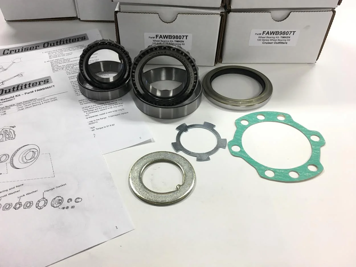

Toyota. Different thicknesses are available in 0.2mm increments. Cruiser Outfitters sells a set of all common sizes.
We do offer a pack of the 6 sizes :D
As well as the full bearing service kits:
More on both: YWST: Wheel Bearing Overhaul Kits for the 100 Series (LX470)

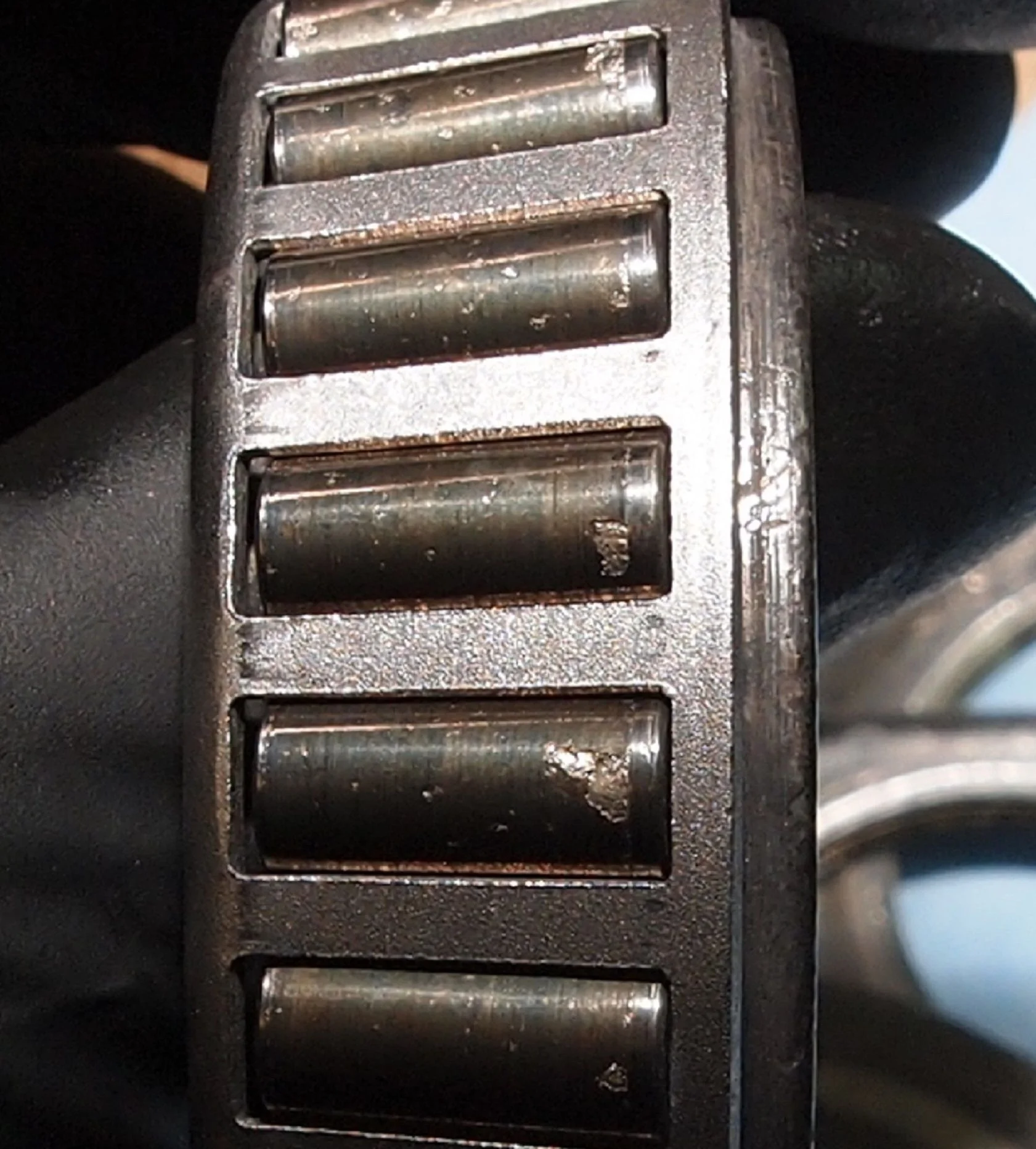

Wheel bearings and races must be cleaned to properly inspect. Here's a picture of a bad wheel bearing that needs replacing at 350K miles. It's very rare to see bad bearings and races. Our bearings are incredible tough.
This same rig had the first axle needle bearing that concerned me so I replaced. Grease was blacken, spindle blued from heat and needle bearing once cleaned revealed blue/overheating in cage.

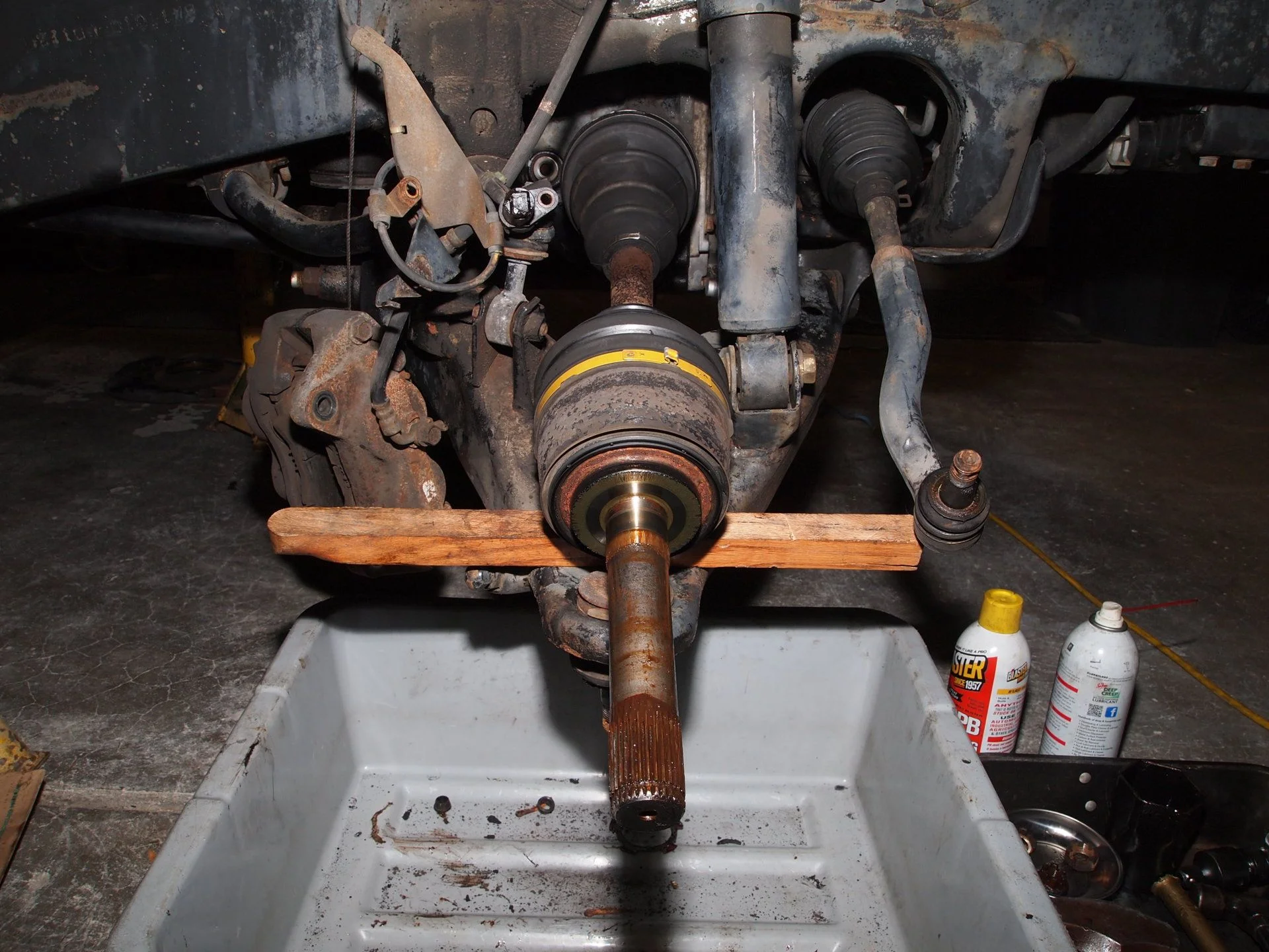

:hmm:Number one reason I see for unusual sounds after wheel bearing service is the dust seal of front driveshaft gets bent. It then rubs on back side of steering knuckle. This dust shield is thin metal that gets bent just by weight of front driveshaft (FDS) lying loose on LCA. I place a 1" by 1" piece of wood across the LCA for FDS to rest on keeping dust seal from touching it.
You can raise front tires off ground and inspect by looking at dust seal as you turn the tire/wheel.

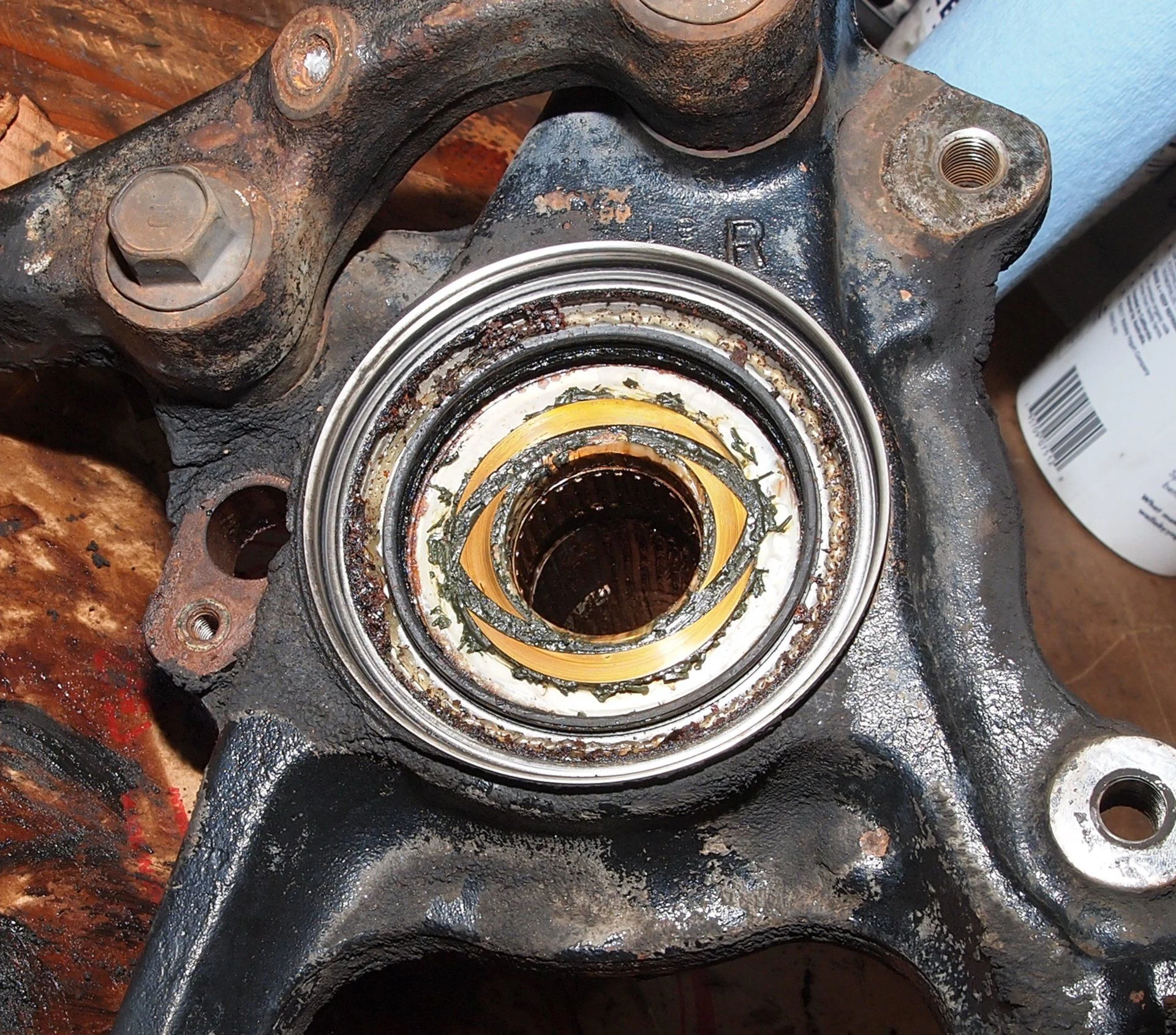

Not seating or bending oil seal in back of knuckle can also produce a sound.

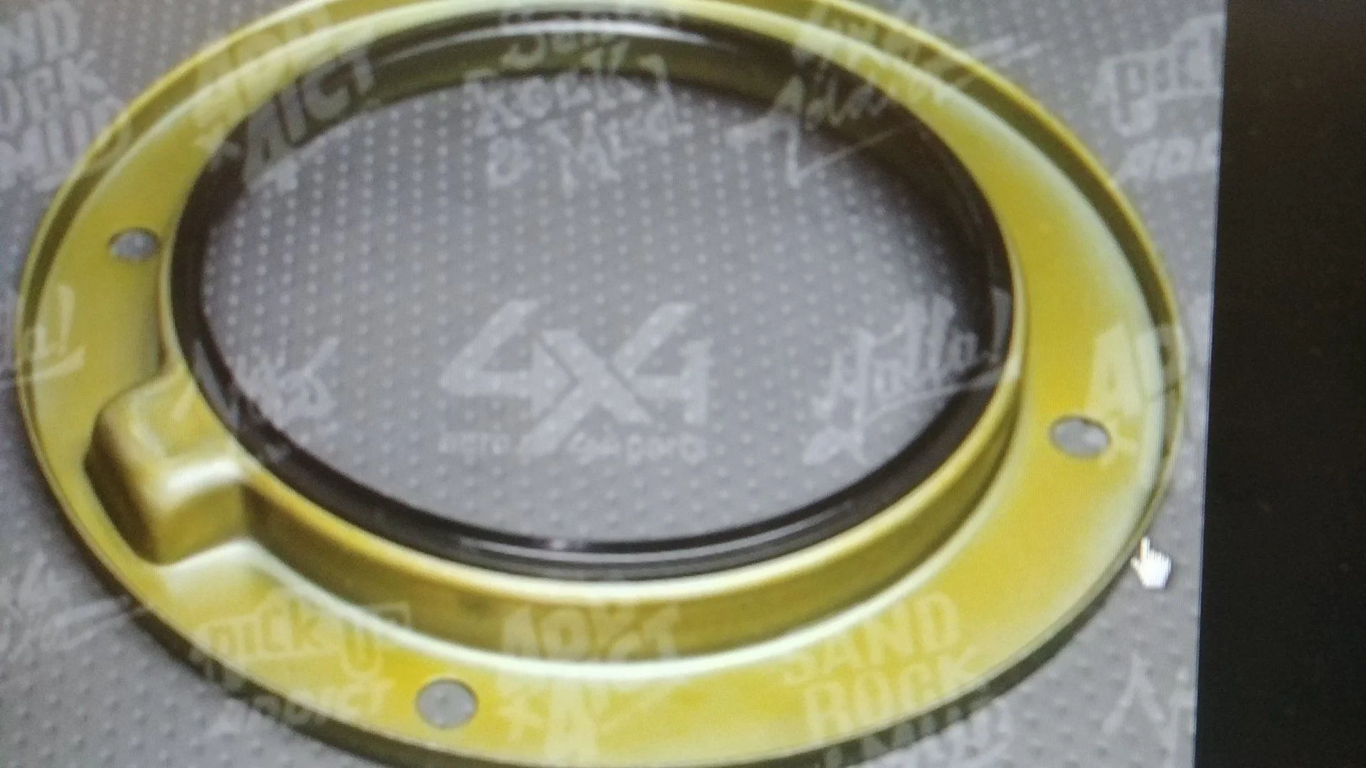

Seems like lots of ppl are flattening their grease caps flat for wheel swaps with no issues... Another question, how important is the gasket on the dust cover behind the rotor/bearing? Mine is toast.
Yep, one needs to really beat in the grease cap before it rubs on axle.
Great question on the large dust seal. Factory calls it non reusable. My feeling has been, if rubber of seal in good condition it's okay to reuse. For those running their rig in sand or water crossing it's probably better to replace ever ~120K or 10 year max.
