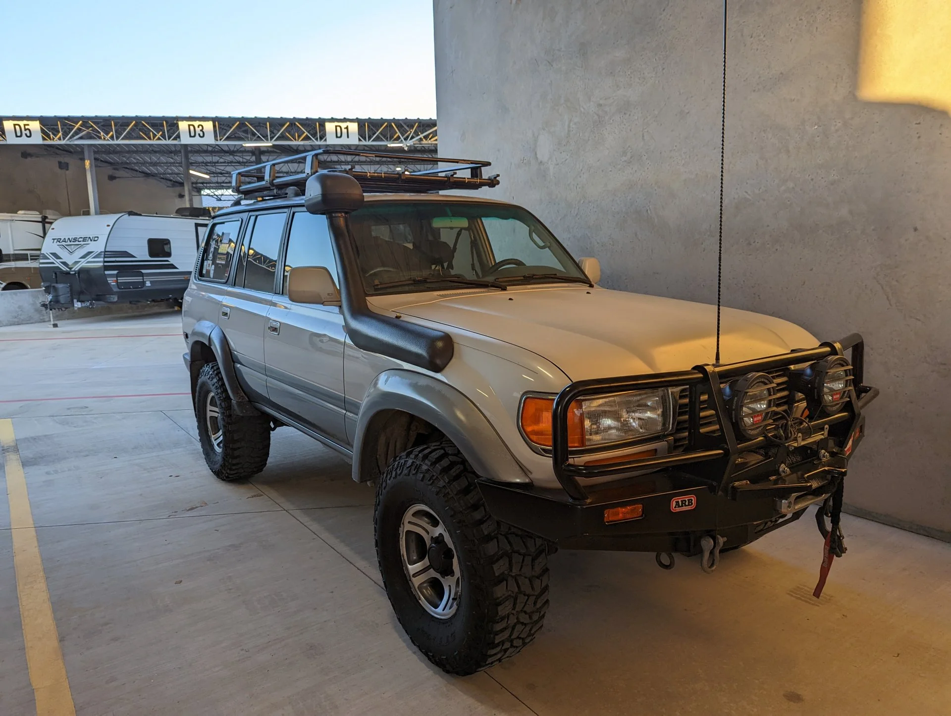

I picked up my next toy yesterday from an owner in Kyle, TX. I overpaid for it given the condition. But I think it has good bones. There's lots of maintenance that has been put off by previous owners that needs attention, and it needs some major cosmetic love. The photos look way better that it really is in person.
Some things that I know need attention so far are:
- front axle and birfields
- valve cover gasket
- radiator, water pump, thermostat, coolant hoses, heater control valve, and related hoses and clamps, etc
- oil pump gasket/oring
- I think front main seal needs replacing.
- needs all three belts replaced
- interior needs a LOT of love
- dash is cracked, not sure if I want to mess with that or not. Thinking about it
- and I'm sure I'll find more as I get into it
The good:
- triple locked, and it all works flawlessly
- OME J lift with caster correction, and dampener. and it actually drives well
- new tires and an extra set of OEM wheels

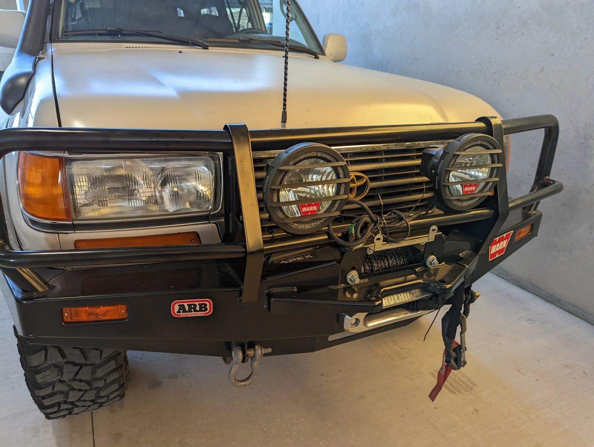

- new ARB front bumper and a badlands winch and lights that's installed but not wired up
- rear tire carrier, not sure if I like it. May sell that setup
- no rust and has only had 3 owners
As per my usual routine, I'll be documenting the build in detail along with lots of videos. I'll start with a full video of the current state of affairs in the next few days. Wish me luck!!
I have to be the only 80 guy who thinks the ARB bumper is awful looking
Would not have paid whatever they were asking...with a JEGS sticker on it. lol
The roof rack bolted to the factory rails is comically dangerous. Hope that's a re-do.
The rear tire carrier is actually not a inexpensive kit. Not sure I like it either tho. Adds a bit of overhang.
Otherwise nice rig. 👍
Agreed on all points. Some not so great decisions were made by previous ownership. I'll be addressing it all one by one.

Oh and...I'm no expert on snorkels but...the head on that thing is enormous.
lol
What else you keep in there?
lol
Dude. Ya... Yes....... I may take it off completely. I hate snorkels.

Isn't that the Toyota snorkel? I think those are expensive or unavailable now. I actually like the look more than the Safari/knock-off versions.
The paint and body on that rig look really good. I love that color combination. I'm also not an ARB bumper fan, and the spare carrier is silly to my eye.
It looks like a great rig.
:meh: It could very well be. No idea.

So to speak. Love it. Same color combo as my 97 back on my farm. The Wilco tire carrier is just fine for anyone who doesn’t wheel hard and can afford to have low things hanging off the rig. It’s also a good temporary measure while waiting for a rear bumper w/swing outs. They’re solid too so if you get rid of it, sell it for a solid deal. Plenty of people seem to use them as an in-between solution.
