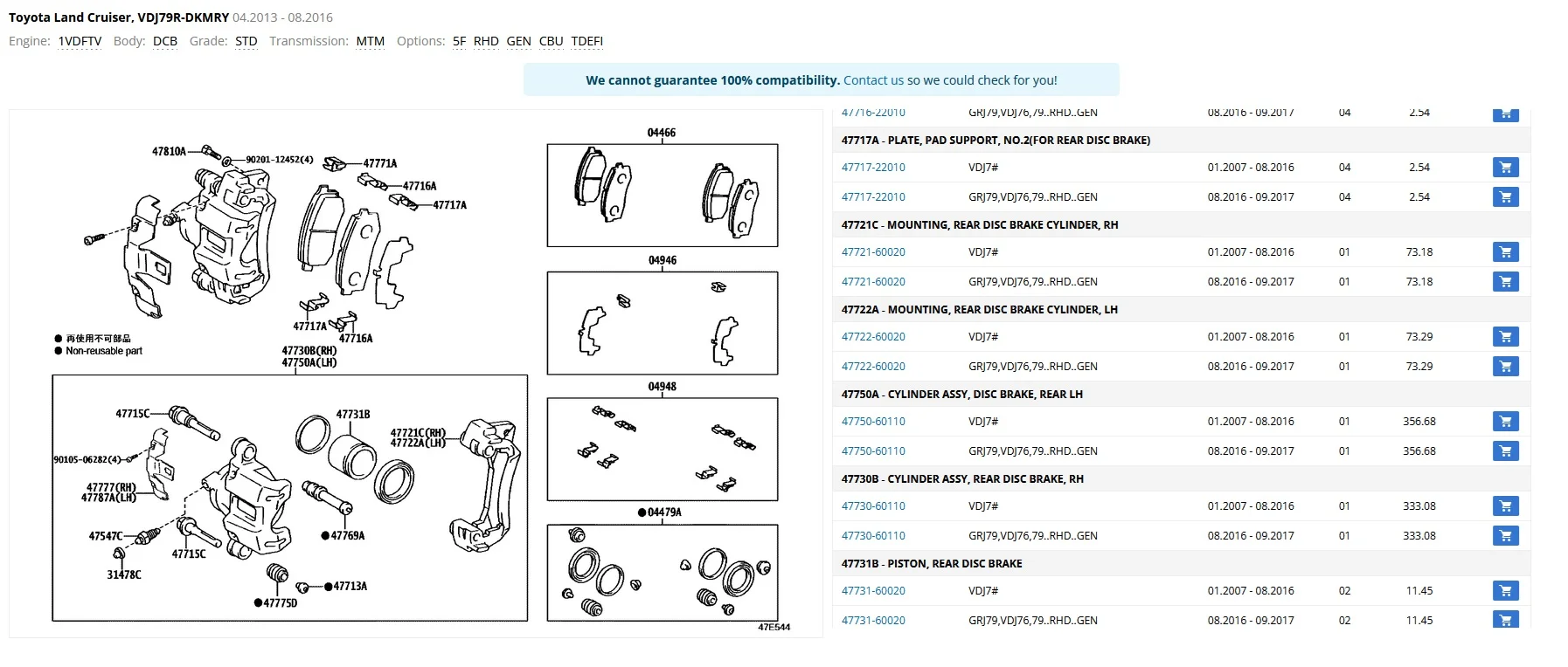

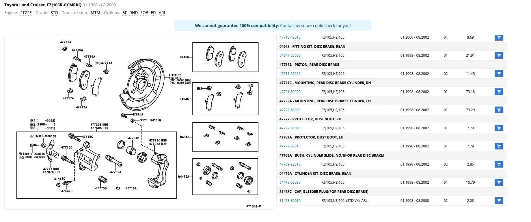

VDJ79 + FZJ105 use the same caliper mounting bracket. Looks like it's the same mounting bracket for 80s as well. I'll have a dig through DBA's site and pull up rotor sizes, you may be able to make it work on an 80 without much hassle.
EDIT: 105 rear rotors are almost identical to VDJ79 rotors, 0.5mm difference in height. I'm thinking it should work relatively simply.
47721-60020 RH
47722-60020 LH
