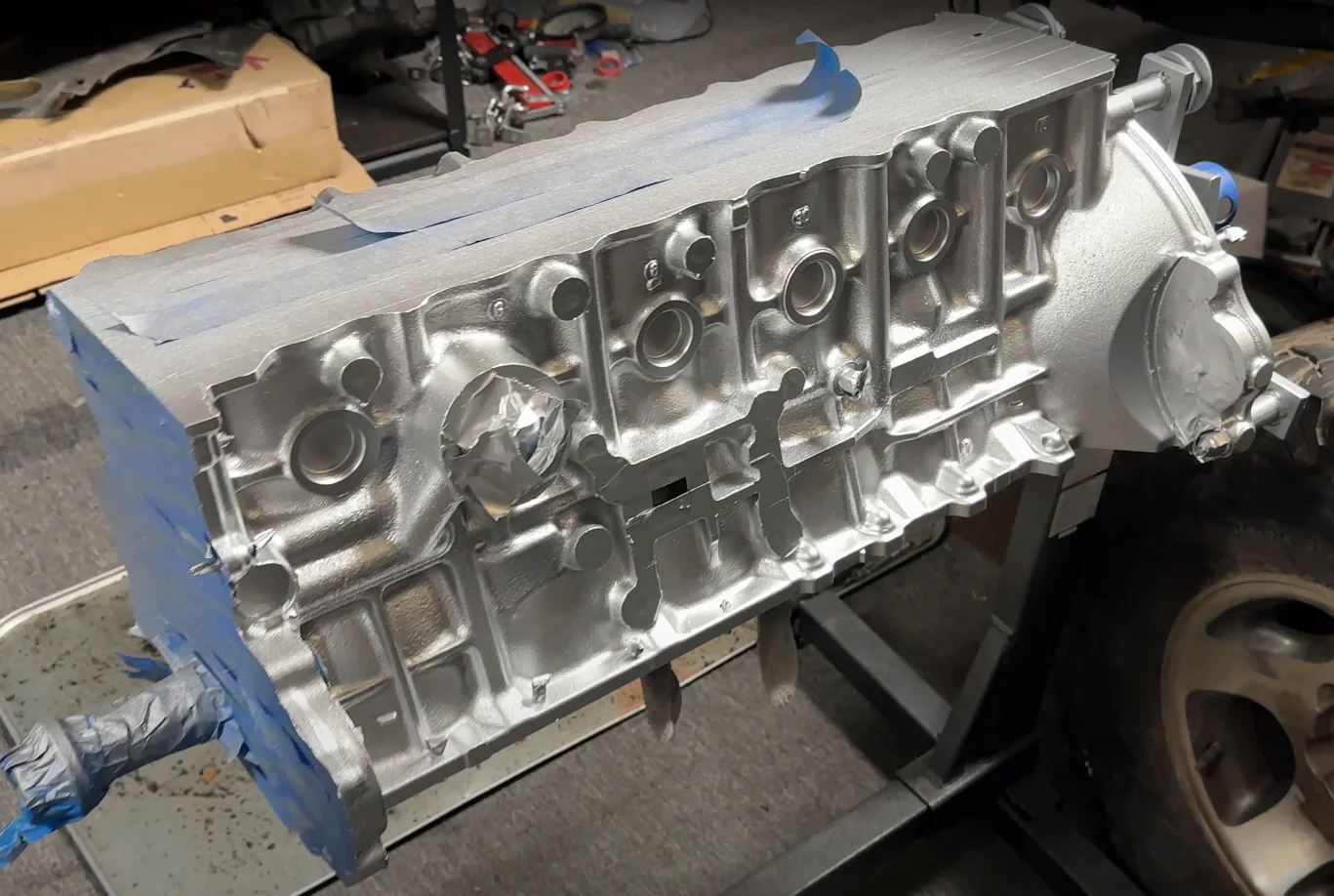

Got the block cleaned up as best that I could. Degreaser, scrub, rinse, brake cleaner, rinse, brass wire wheel, blow off with air, spray down heavily with denatured alcohol, blow off again, then finally go over it with a MAP torch to dry up anything else remaining.
Then primed and painted. Used Rustoleum 600f engine primer, then followed with Rustoleum 600 ceramic enamel paint. Used the "cast aluminum" color, but in hindsight I really should have gone with a darker color. I thought it would be a mild gray tone, but it turned out to have a TON of metallic flake in it and is very bright. Almost looks like slightly polished metal in a way. Oh well, look 100x better than before.
Looks great, I can do my eyeliner in the reflection. Wait, wrong forum. You’ll be able to see any discrepancy very well!
Haha, love it! I guess at least this way I can see when there's a leak easily. Maybe I should paint the axles white too 🤪

Time to move on to the short block. We got the rods pulled, inspected the rod bearings, and we're going to order new OEM rod bearings. Also pulled the main crank bearing caps, and they look great. Washed and degreased the block. Started by pressure washing. Then went through 5 cans of degreaser with with brushes. Then used 4.5 cans of brake cleaner to get all the surfaces clean and remove any of the left over degreaser. Then finally used the high pressure air nozzle from the compressor to blow out all the holes, blow out all the fluid hiding in various spots, and get it all clean and ready for next steps.
Here's the short video of what we did.
Spent a bunch of time prepping the short block for paint after the last round of cleaning. Started with wire brushes on the drill to knock off anything on the surface. Then a spray down with denatured alcohol. And lots of blowing off with the air compressor in between rounds of cleaning. Then masked off all the surfaces that I didn't want paint on. Primed the block first with Rustoleum enamel primer. Then put down several coats of Rustoleum ceramic 600f engine enamel paint. In hindsight I would have gone with a darker gray color, but most of the short block will be hidden under other things, so the bright silver shouldn't be too much of a bother. Overall, well worth the effort while the motor is out.
