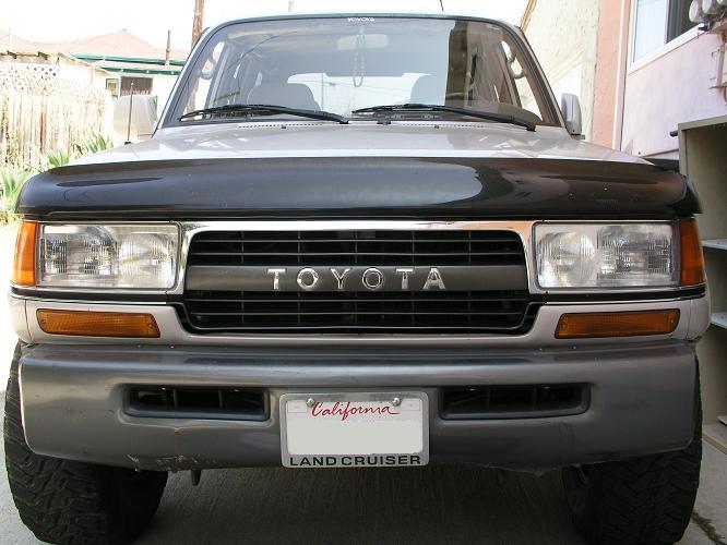

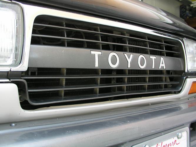

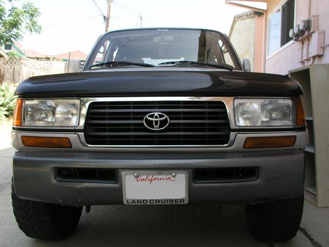

I have read a couple of threads about grill swaps. I purchased a very well used (broken) grill from the guys at Cruiser Parts. They were very honest about the condition of the grill, it was broken in about (6) places, was beat up and looked pretty much like ****. For $35 I thought I would see what I could do. I hate the gold emblems on my 80, especially the "sombero" on the grill. Here are the results of a days labor, one tube of plastic epoxy and Dupli Color. Had to grind (2) small places on the '93 grill to get it to fit properly. After that it fit like a glove!!

I spent about 5-6 hours sanding, scuffing and fixing the broken parts on the grill. I was able to fix most of the from the back so the cracks are not visible from the front of the grill. Taped up the chrome letters and top and then painted with three coats of Dupli Color. It was really that easy, not hard just time consuming and tedious.

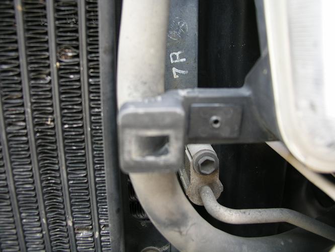

I had to grind about 1/4" off the lower mounting tab on the '93 grill. Also drilled and tapped the lower center hole into the existing brace. Dremel tool and a few tries and it fit perfect. I maybe spent 30-40 minutes grinding and checking, then a little more grinding. It was nice outside today though so I was in no real hurry. Anyone could do this, on the banana scale it doesn't even register.

I could swap back to the '96 grill in less than 5 minutes no problem. It was super easy and for about $48, I am liking it better than the gold "bling".

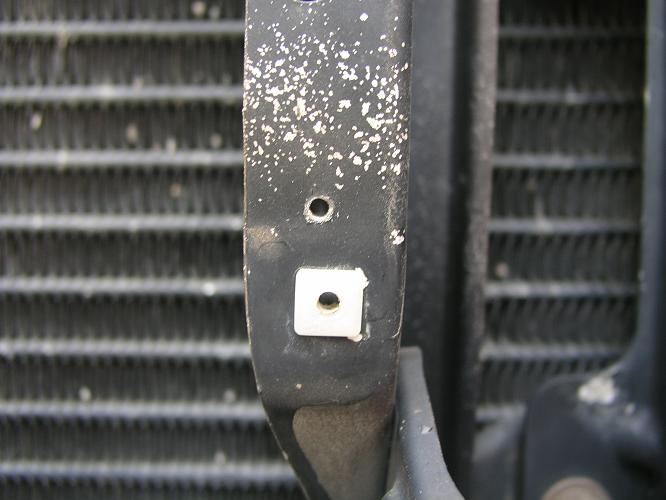

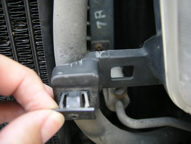

I assume the valence is somewhat different on the older LC's. The gap is the only thing noticeable. In the pictures below you can see the new bolt location and the old one. The old one is not used and is for the '96 grill. Pop in the plastic retainers and insert the screw, it's that easy. The area I had to grind was right behind where the '96 mounting location is located. I purposely removed the material from the '93 grill instead of the mounting tabs so if I ever want to switch back the mounting tab is still there and still strong.

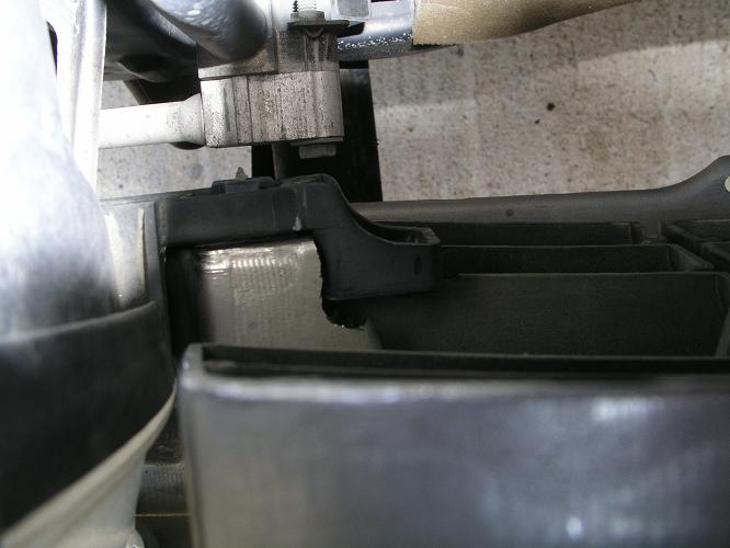

Since the photos are missing in the first post I will share mine from today's grill swap.

Here is the tab situation, just move the block for the screw from the inside tab to the outside tab.
You can either cut the inner tabs off, but you will never be able to switch back to the newer grill, or you can notch the back of the older grill.
Last step is to drill a new hole for the bottom, middle screw.
