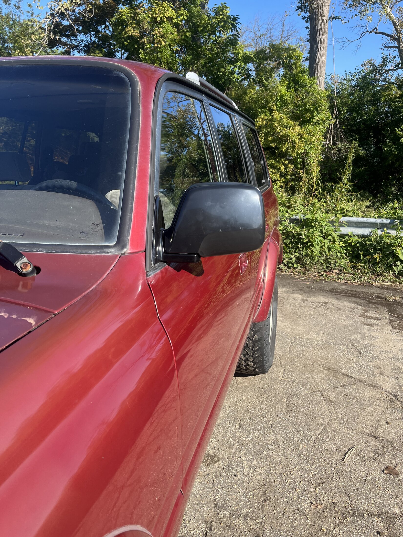

Here’s a picture to get things started

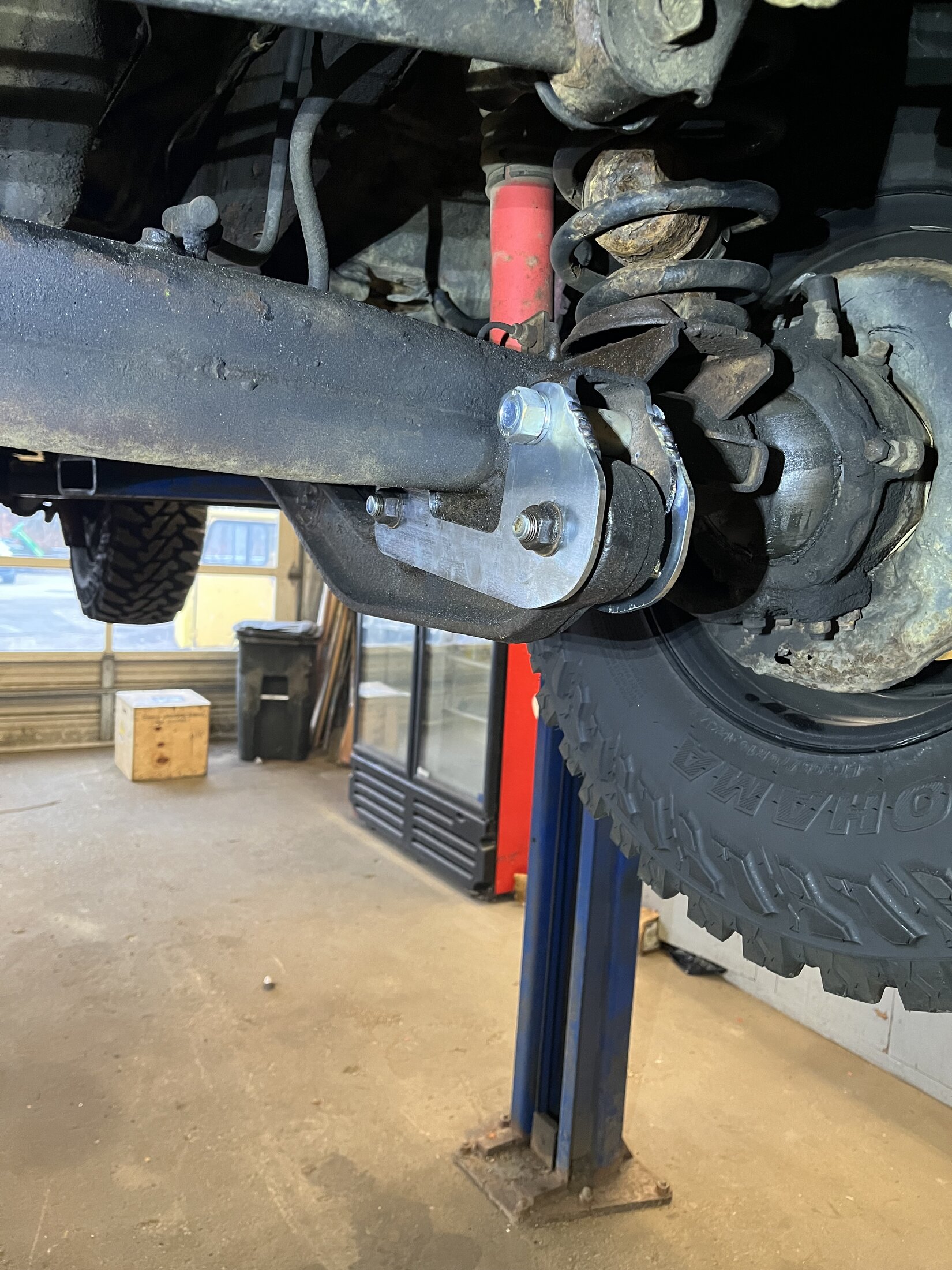

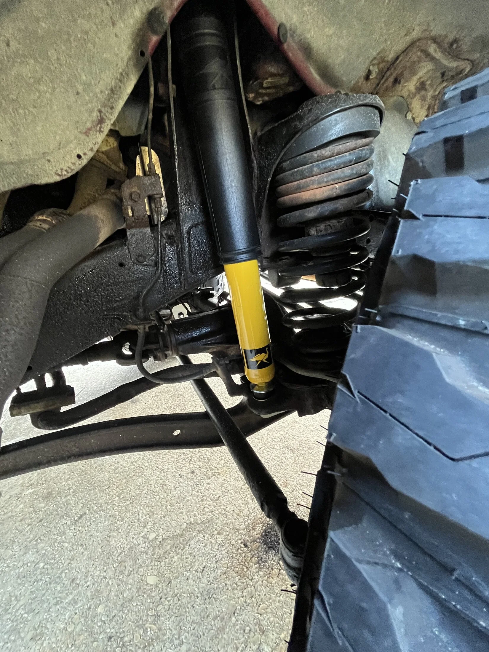

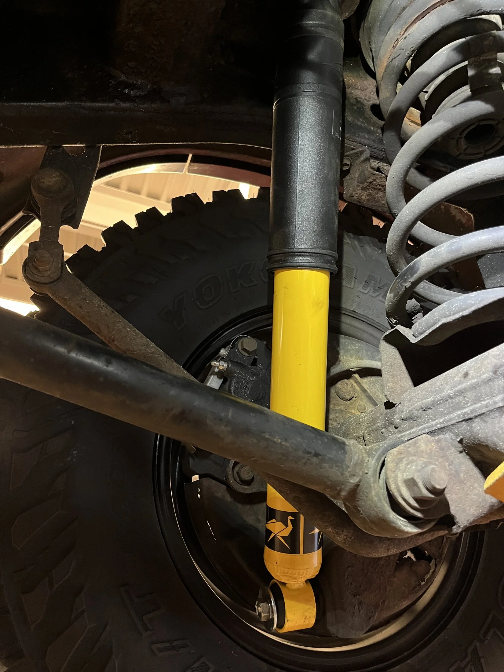

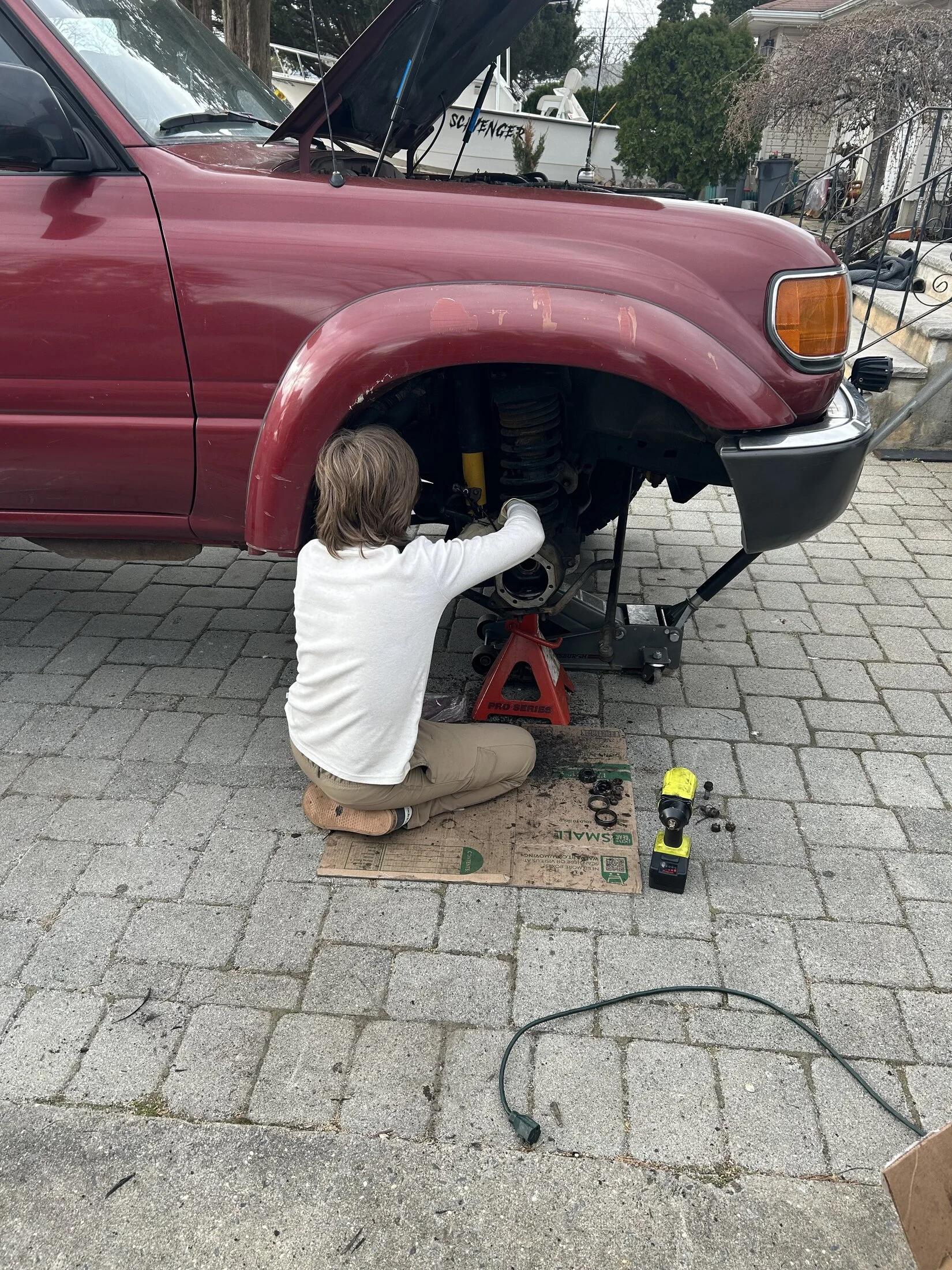

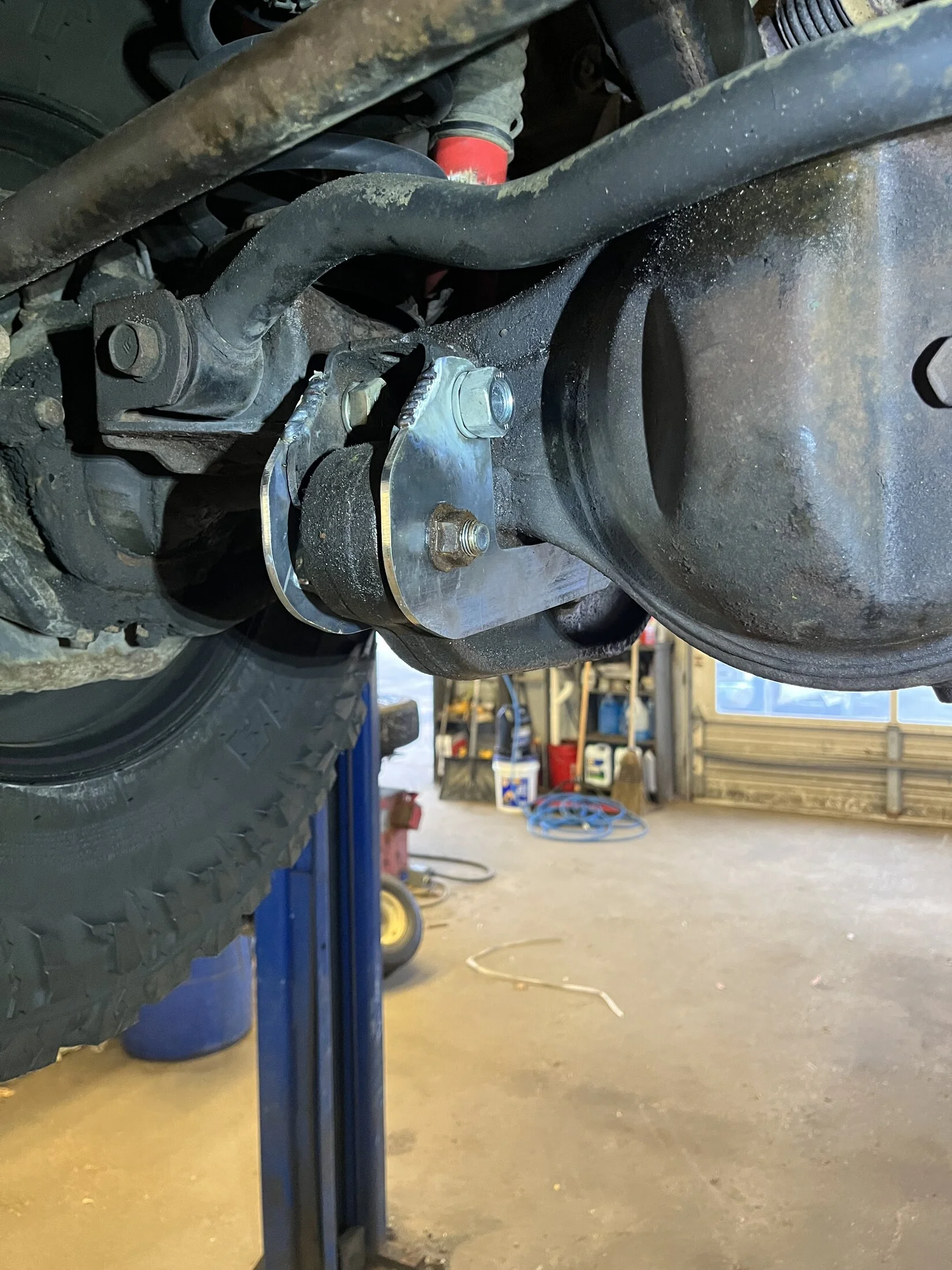

Since it already had a lift on it the caster needed to be addressed. I went with slee caster plates also order new shocks all the way around.

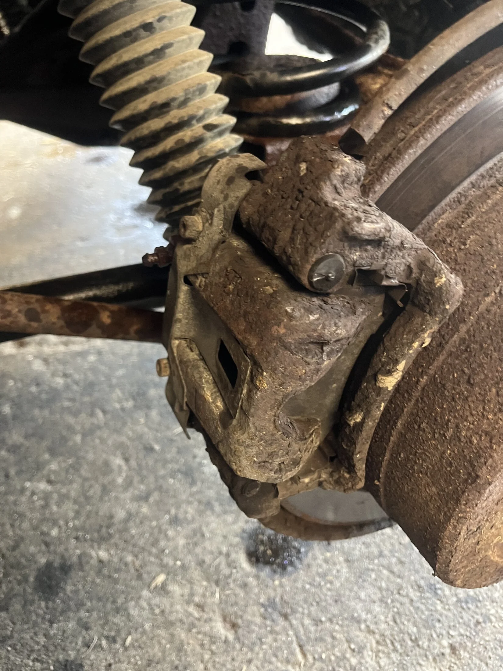

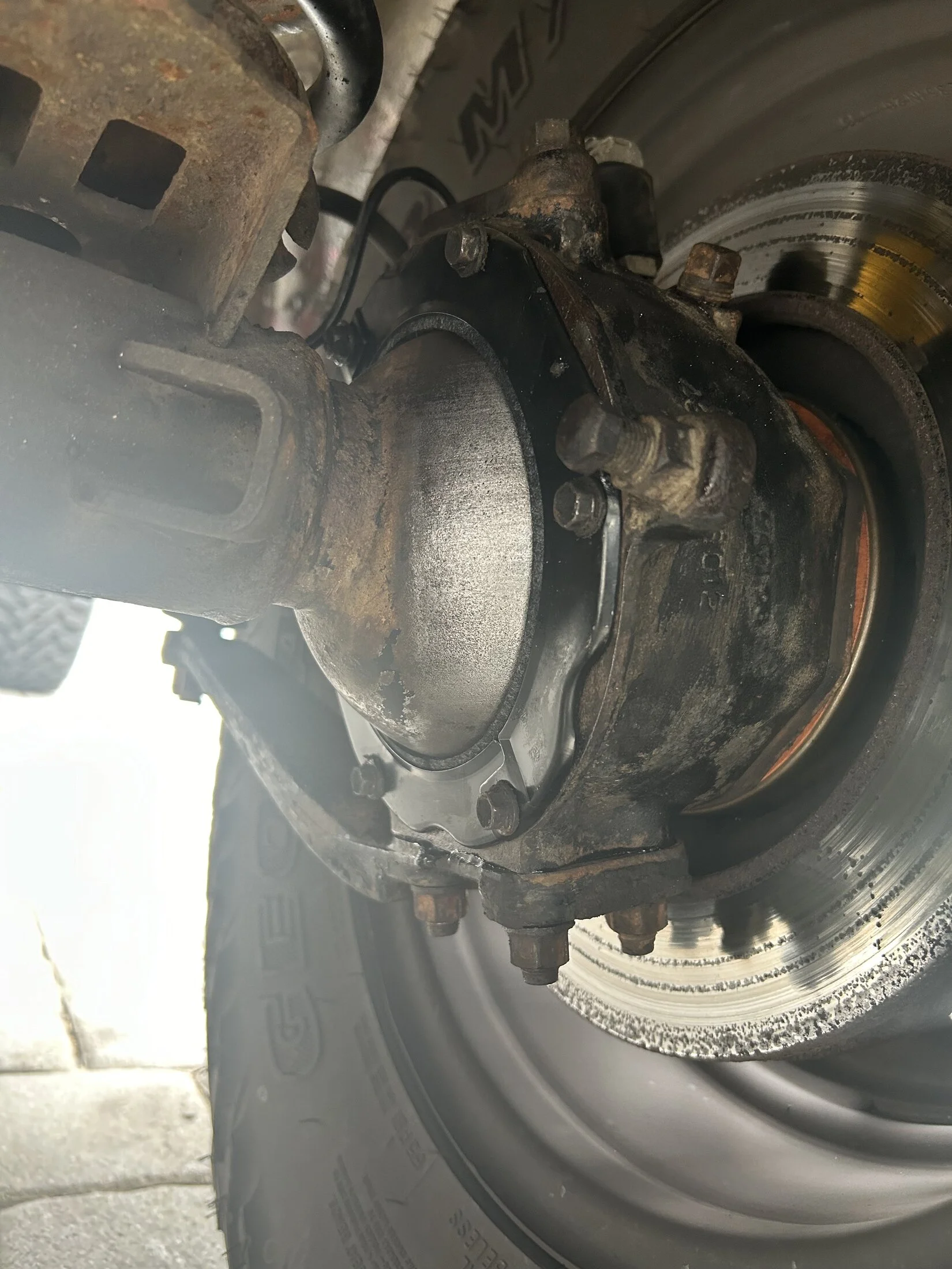

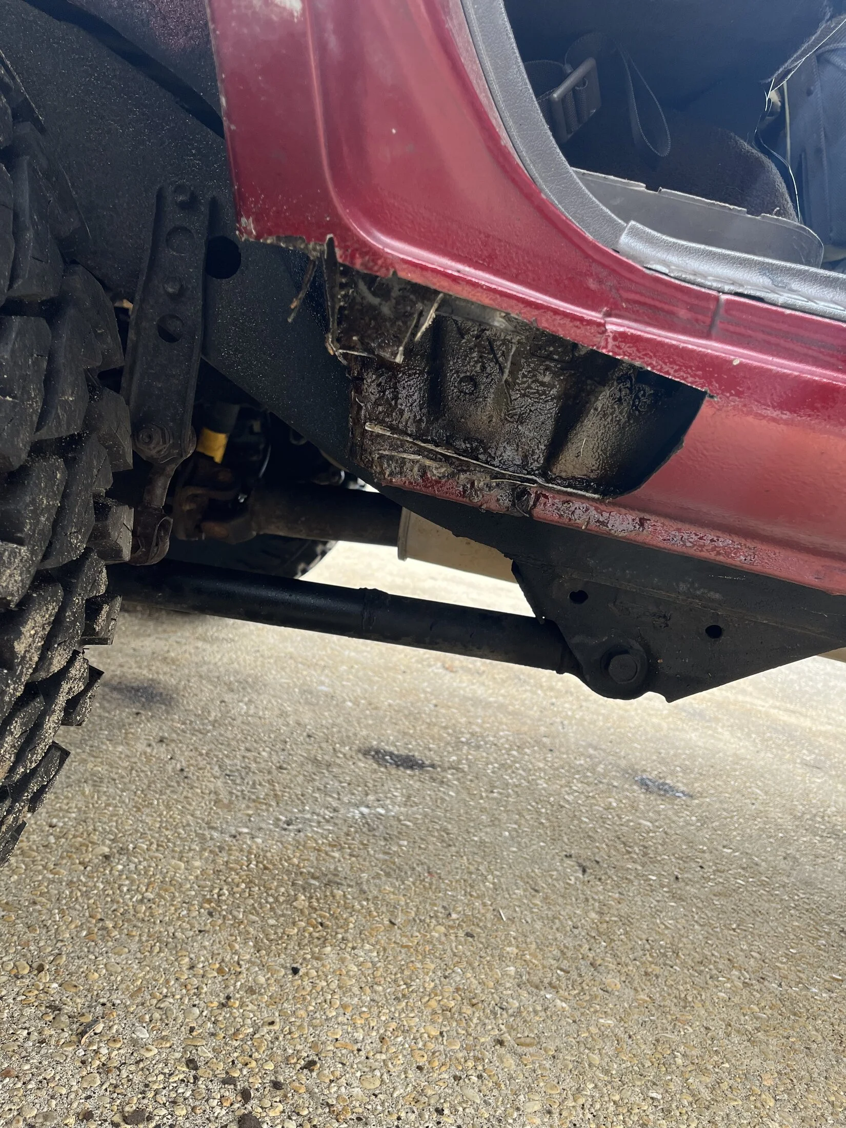

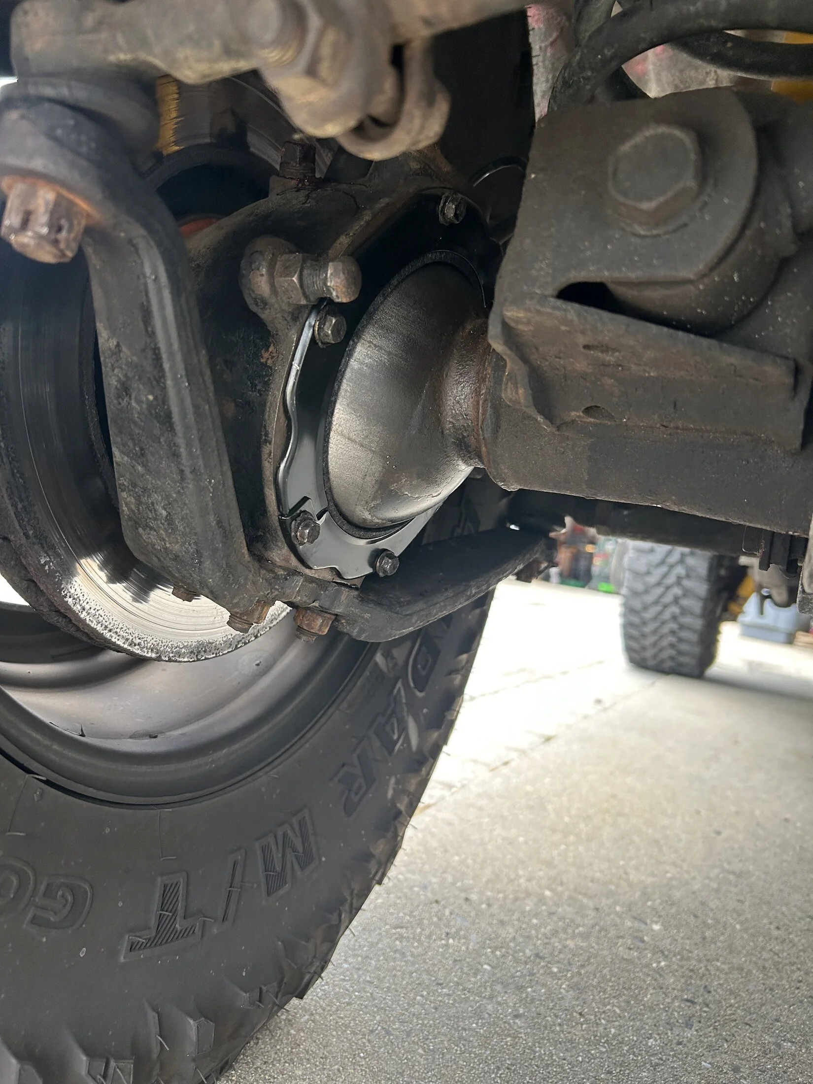

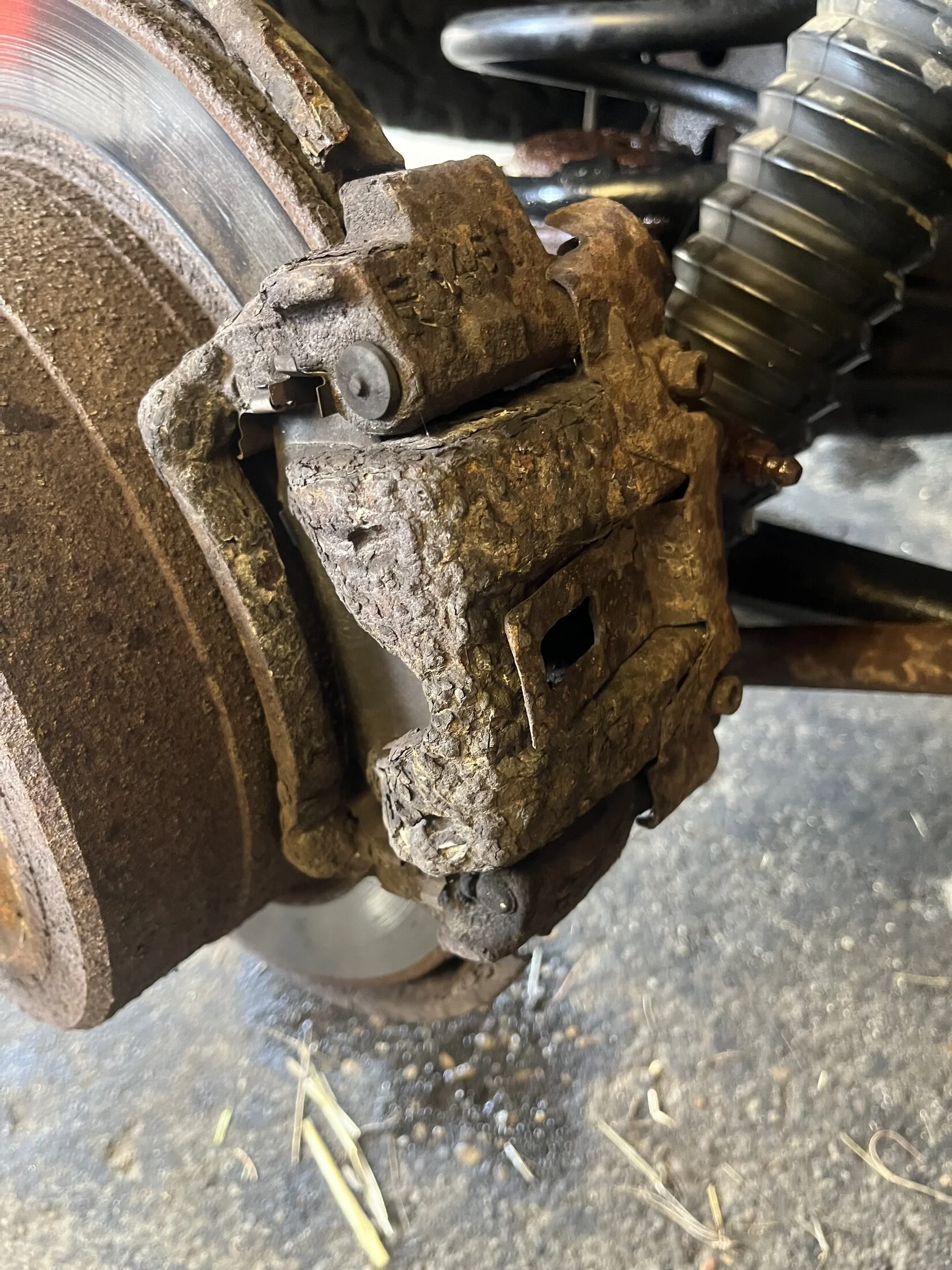

Thanks the studs are good. The rust on the brakes actually looks worse in the picture, it’s from sitting for a while living close to the ocean. The frame and everything else is pretty solid. One of the first things I did was clean up the chassis and coat with surface shield but I didn’t take pictures.

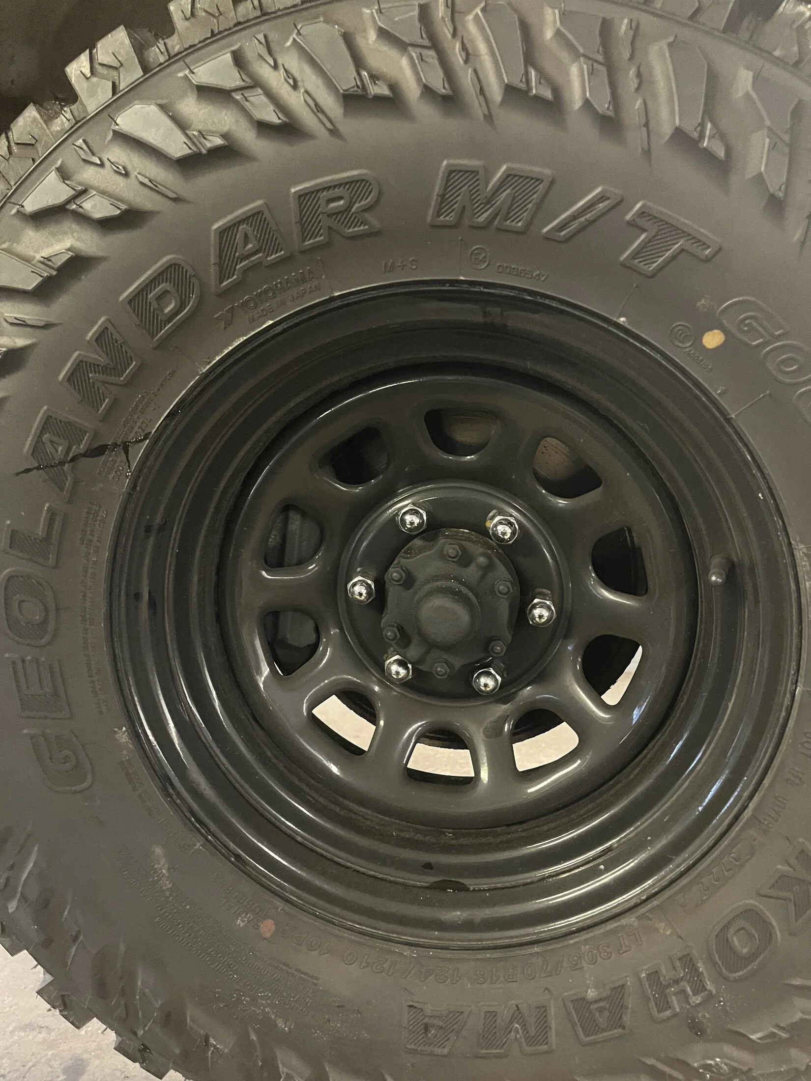

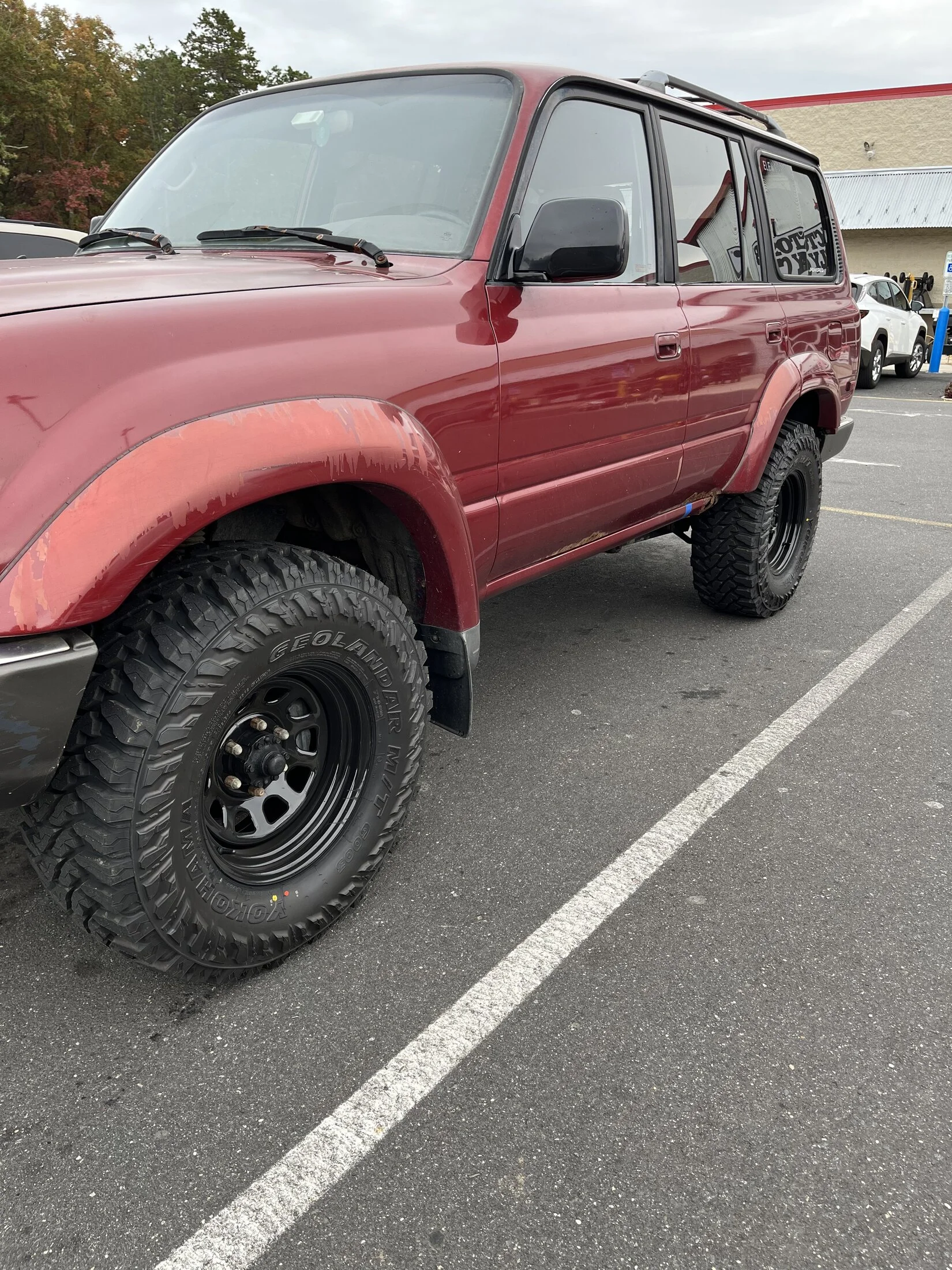

Oh and great choice of tires. I have the Yokohama MTs as well and love them. Very quiet for a MT.

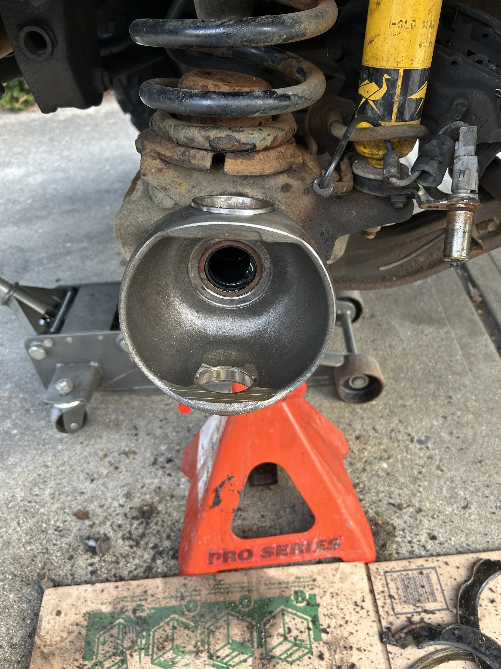

Should have done the rotors when I did the birfs but I slapped pad when I did the the rears. Definitely going for the upgrade when I need to do fronts again.
