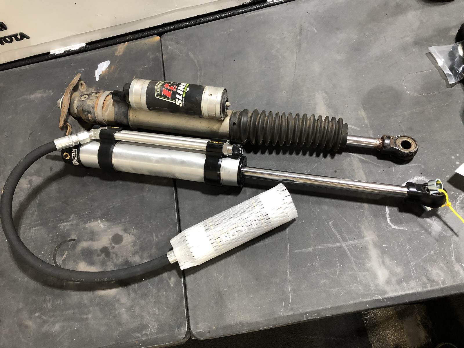

Here's an image of one of my very well used Stage 4 (piggyback resivoir) rear shocks next to the stage 5 rear shock I have now. You'll notice the extra length and the two external bypass tubes. The adjustment knobs are on the ends of the bypass tubes. On the stage4 shock the adjustment knob is on the top of the reservoir.
Stage 5 Slinky by Adam Tolman, on Flickr
