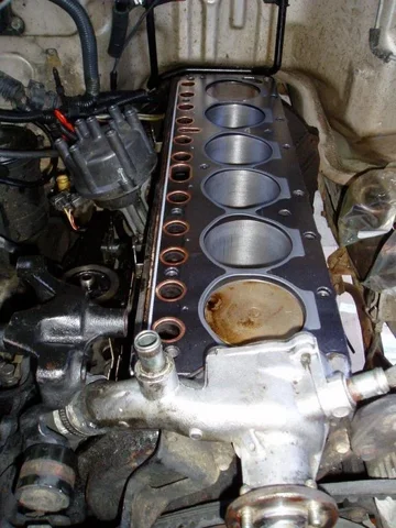

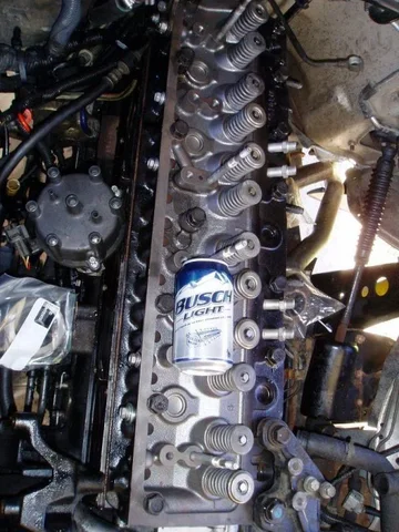

A few pics of new stuff
Correction: "Fuel Filter" it's pretty easy.
