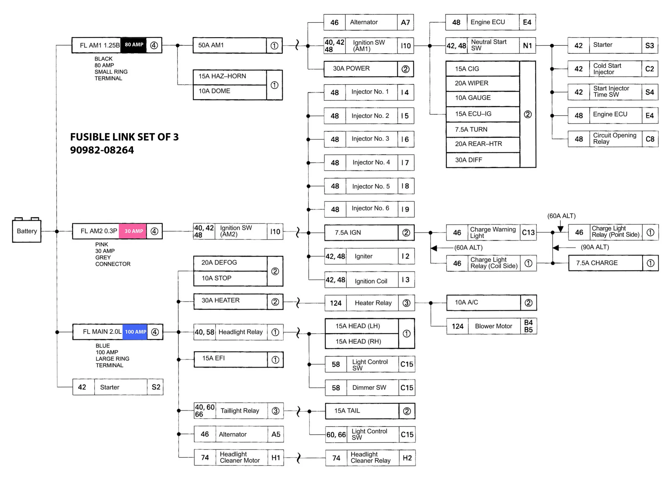

well, if the fusible link blew - that is a sign there must be something wrong with the electrical system? Likely a short somewhere?
As much as I distrust the aftermarket AFMs, I don't see how they would blow the fusible link even if wildly defective.
I agree. Something is causing that fusible link to blow, and it's VERY unlikely to be a bad AFM or other sensor. Figure out which one it is and get ahold of the EWD for your truck. You've probably got a damaged wire or connector somewhere, and an EWD will help you narrow down the problem.
The fusible link(s) are a set of 3, each feeding a different subsystem.
You need to determine which of the 3 is popping and start looking downstream into that subsystem.
Thanks everyone. You pointed me in the right direction, although I had to melt another fusible link to admit it. The Main fusible link was blowing, and once I stepped back and considered your comments that led me to investigate the alternator more carefully. Turns out the stud holding the wire running to the battery had sheared, and the wire was wedged inside one of the cooling vents in the alternator housing.
One new alternator later (and yet another fusible link assembly) and it starts and runs normally.
