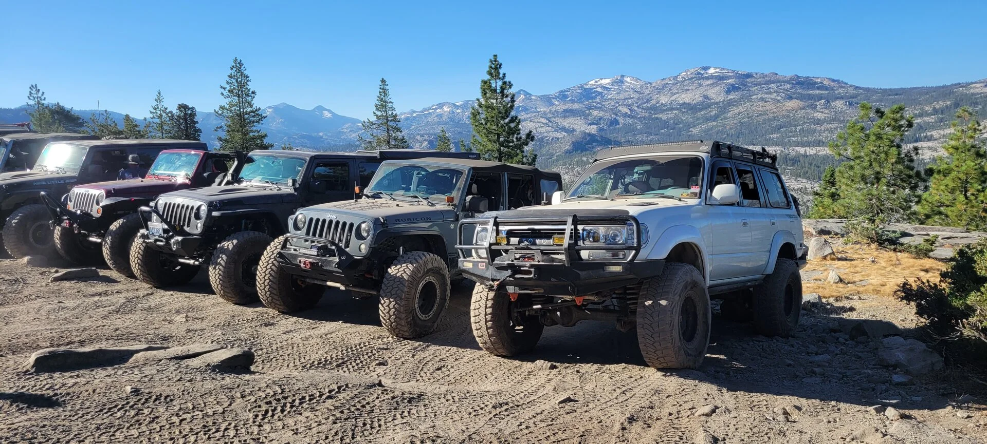

I could tell you that owning a 91 for the past 8 yrs and my experience with a 3F-E. I had the opportunity to pickup a clean bone stock 91 with less than 200k miles for a good price, 1 owner truck from San Diego. Similar to your situation, i was holding out on a 1FZ-FE with the newer motor and potential of having locker options. With that said, i still own my 91 and have no plans to replace it with the 1FZ.-FE. It really depends on your end goal and your intended use. The 91-92 is a very basic rig with a reliable motor. It is fantastic for a farm truck or safari truck that doesn't see ton of pavement or highway. However, you can make a 3F-E more highway friendly without doing a v8 swap with regearing, and upgrading the transmission valve body, advancing timing, etc. It will do 55mph up super steep grade and cruise @ 75 mph on the highway all day long.
If you live in higher elevation and tons of mountains passes, the 1FZ-FE will be a better fit between the 2 for sure. OEM parts are harder to come by and some are discontinued, but there are aftermarket support for those and not an issue for me. The motor is bullet proof if you do the basic maintenance and baselining. The past 50k miles i put in this truck are tough, hard miles, and the motor just keep on turning without fuss. It will take a bit of abuse and overheating as well more so than a 1FZ-FE IMO. Lockers are not a concern as there are ton of aftermarket options for lockers and my ARBs been fantastic to use. You do get a semi float rear axle and drum brakes for these truck, and i have yet to break an axle running 37s and lots of rock crawling as well for what it is worth.
For the money, they are hard to beat especially if you can find a clean 3F-E with good interior and straight body. You will be happy to spend that extra money for upgrades.
My 91 @ the Rubicon this yr. It will go everywhere a build JK or JL with 37s or 40s will go...
If you want a built rig and would prefer the newer motor, etc. it would make sense to wait for a FZ example already built.
Super cool shot by the way! Love to see it keeping up with the built new Jeeps
