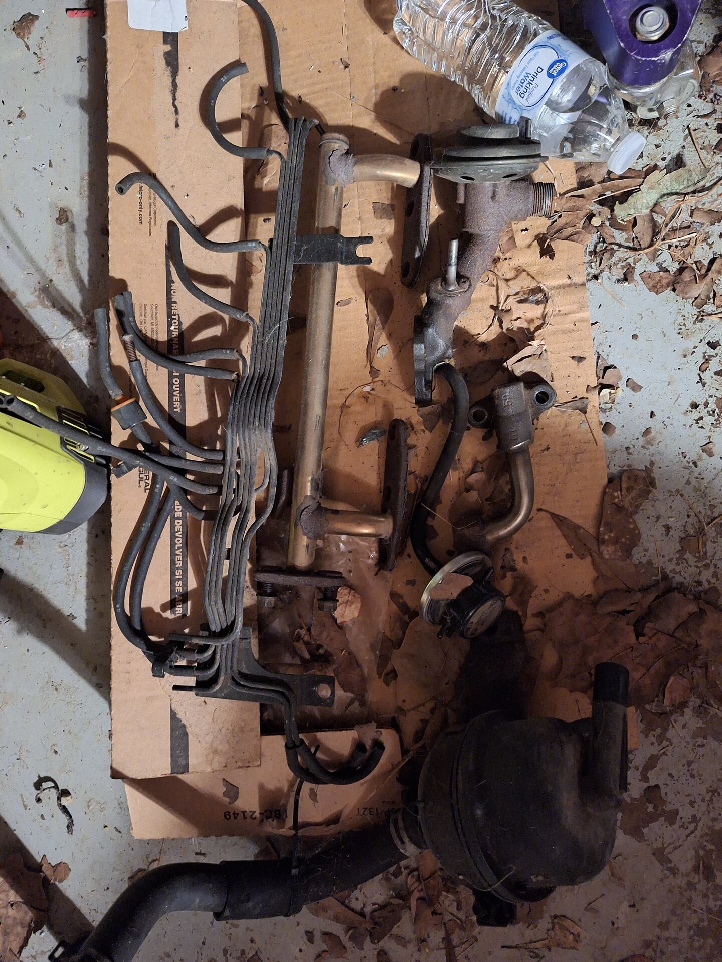

Well it was before I removed the egr system and I did it trying to solve the issue. And yes all the appropriate block off plates have been installed with new gaskets. Unless there is another port for the egr system that opens when hot. I did leave the cross over pipe behind the engine and the thing thats bolted under the intake not sure what that is called. The charcoal canister is still there and hooked up. It's a good idea about the fuel tank I'll have to look at that. I will also try and get a picture of the engine and the way I had to reroute some of the vacuum lines for things like fpr and such. It really is a good truck and if all else fails I'm considering going to a sniper efi, but that's a whole thing lol. The picture is everything I removed
Looks like you got it all. 👍 Somebody over on yotatech is probably looking for all that stuff. :p

Your throttle body vacuum hoses are goofy. Those ports should be capped for an EGR delete, not looped.
Your charcoal canister vacuum should go to the throttle body, not to the filter on the plenum. Are you missing the fuel pressure regulator VSV? It almost looks like you have the fuel pressure regulator hooked up directly to the plenum filter. Bad idea.
What Toyota says about the fuel pressure regulator VSV:
"The ECU sends signals to the fuel pressure regulator VSV to increase fuel pressure based on the intake air temperature, coolant temperature and starting signal. By this system, engine restartability is maintained when the engine is hot."
If you have bypassed the VSV you are increasing the fuel pressure to the rail.
