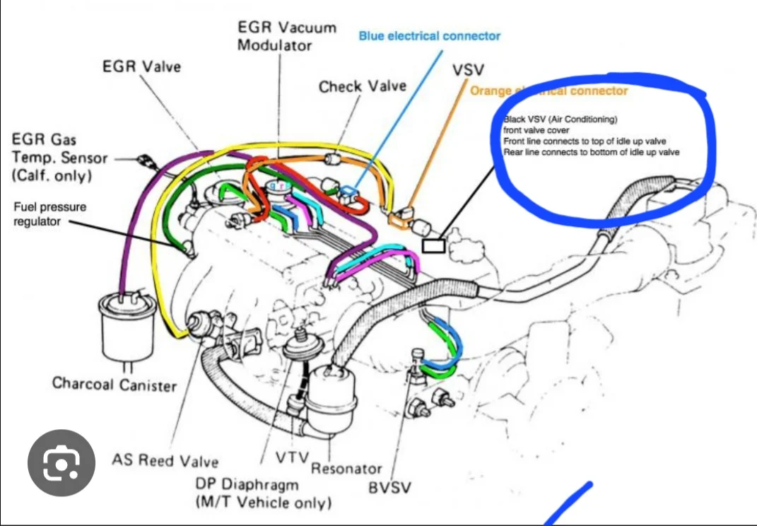

Which vsv is for the fuel pressure, red or white?
On your truck, I don't know what color it is. On my early 22re it's mounted on the rocker arm cover, to the rear near the firewall, under the EGR modulator. Mine is green, and I only have two (AC is the other). On later trucks there was a third VSV added (EGR?). Hopefully somebody with a late 22RE can answer your question.

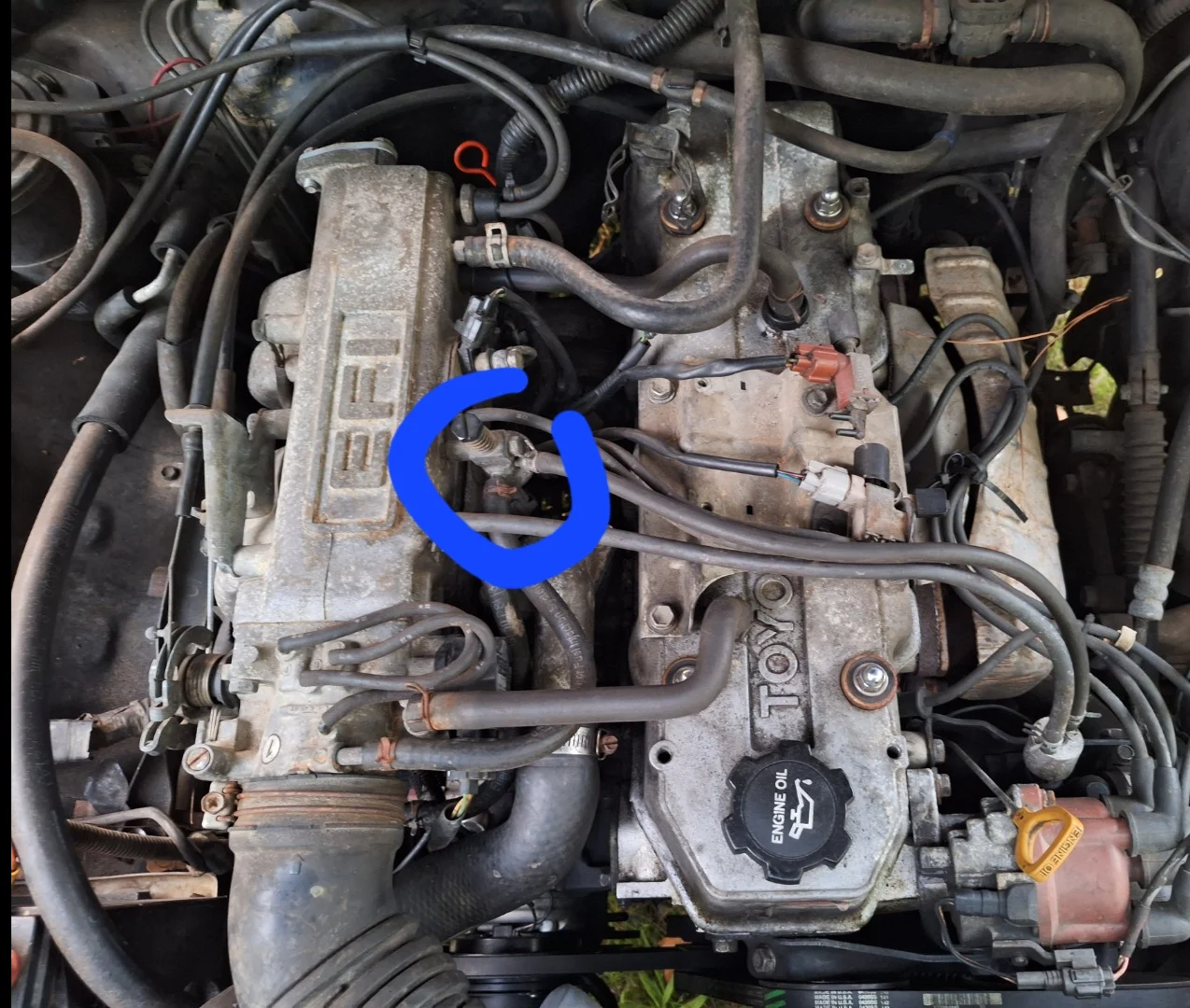

This is all I have. I've circled the VSV that I think is for the fuel pressure regulator.

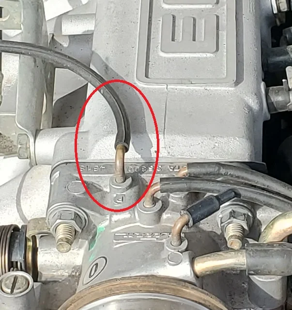

Well mine did have a black one that broke due to age and partly due to me being too rough. But I do believe the the fpr is also hooked directly to the filter with the charcoal canister. I need to go in and replace all of the vac lines and apparently run them correctly lol. Is there a thread on here detailing vac line routing post egr delete?
At this point I would hook up the charcoal canister to the throttle body, cap the extra three extra ports on the throttle body, cap all three of the ports on the filter, and cap the port on the fuel pressure regulator to keep junk out. Your fuel pressure regulator will still work, but you might have hard start issues when the engine is warm. Realistically, folks have said they didn't have any issues.
I really do appreciate the help, more than you know. Does it matter which of the 4 ports on the tb? And I will do the rerouting and capping the places you said
Yes. I believe it's labeled "P" on the TB for purge.

Ok I found this and I don't know how reliable the info is but it would make sense that the black one I thought was to the egr system is actually the ac idle up vsv. The black one on mine is at the back though and the plug is broken and the vsv is as well

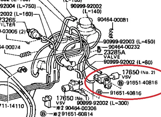

On your engine picture it appears you have the AC VSV hooked up, with the gray connector. On the JPG the VSV labeled "blue connector" looks like the one you need for the fuel pressure VSV. AZtoyman is correct, I believe they are NLA.
