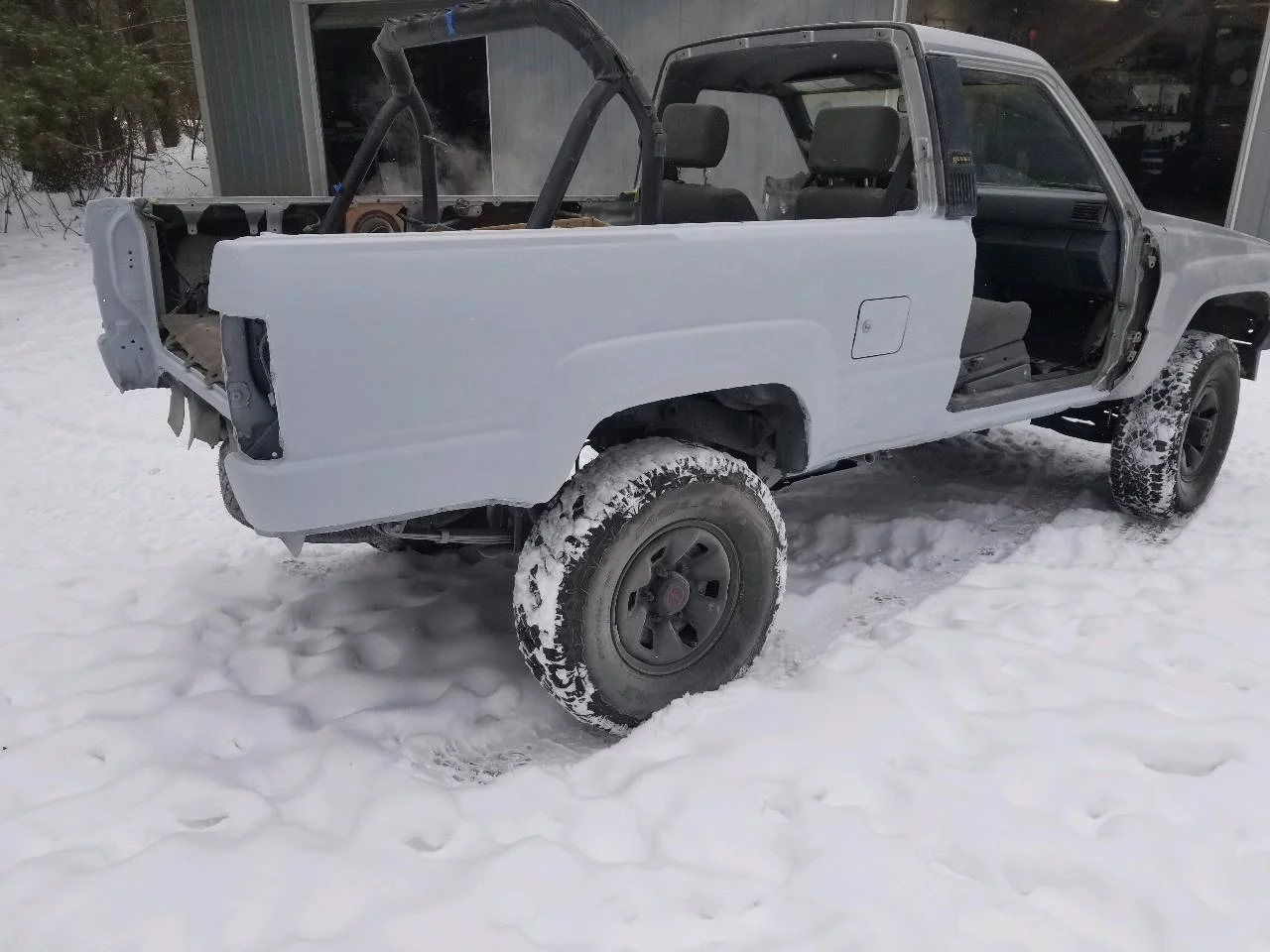

Rear quarters are done about well as I can and in primer until its warm enough to paint.
