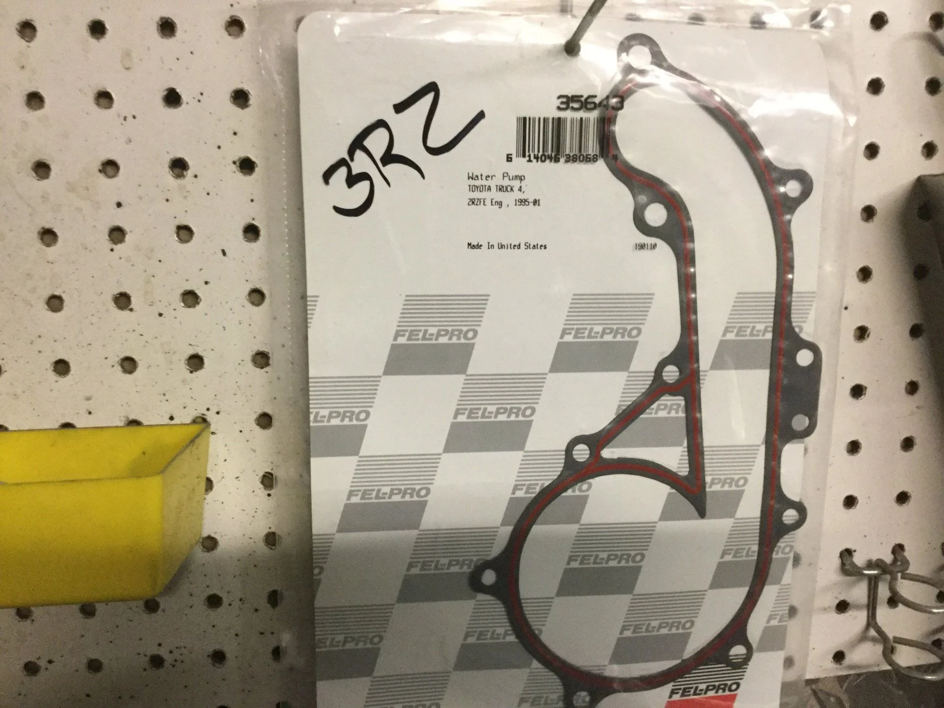

Got about 5k on the 3RZ swap. I give it a water pump gasket up.

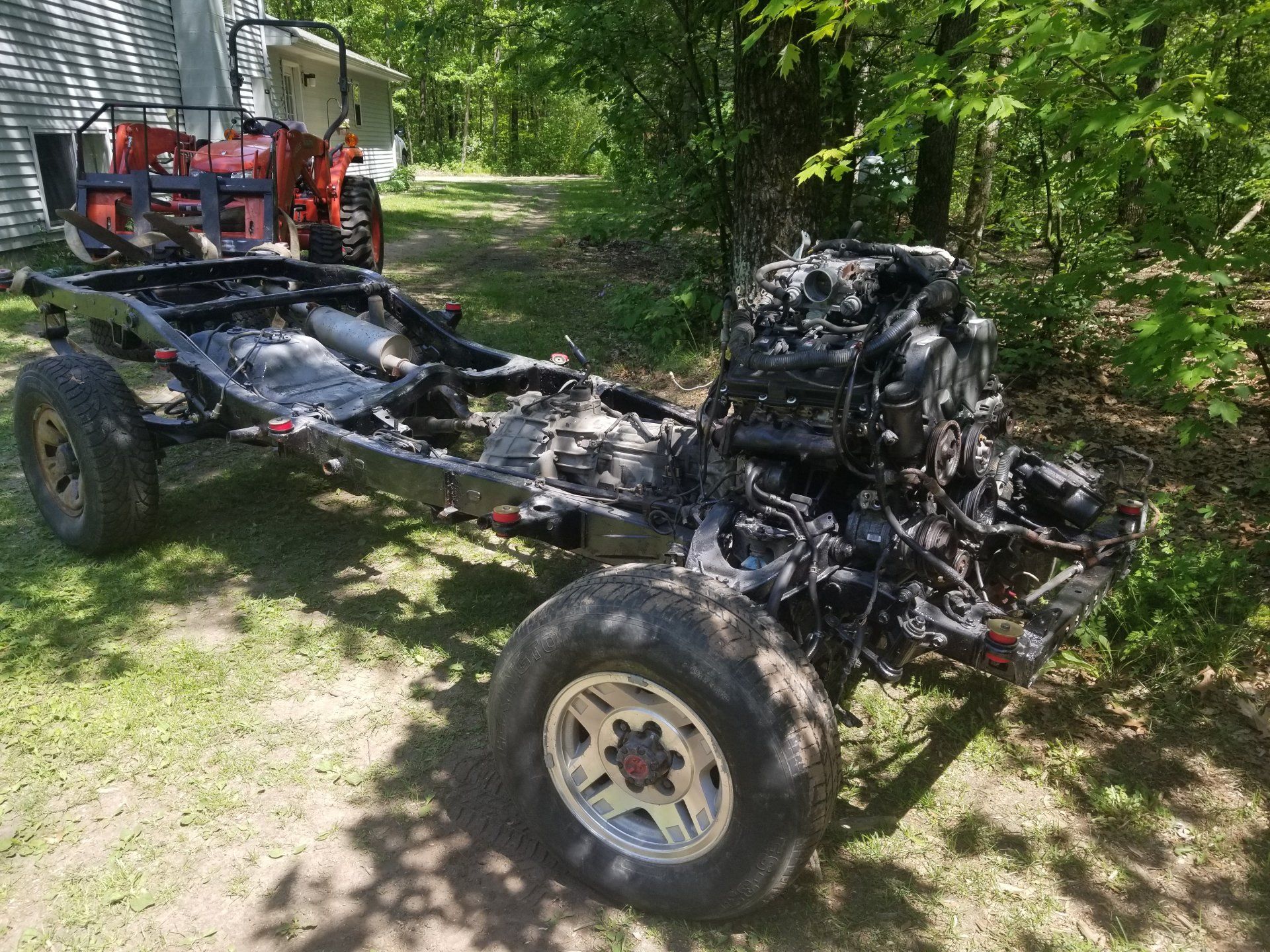

86 is all pulled apart
88 is all pulled apart
97 drive train is out

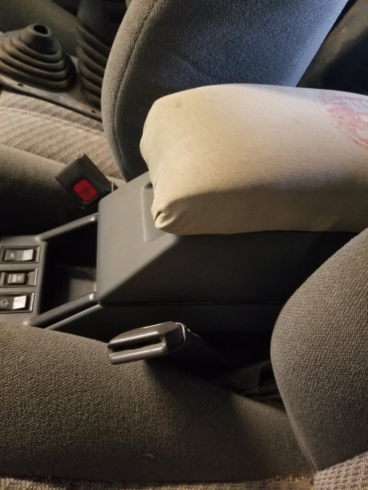

Gonna keep the gray 88 interior. The brown dash pad is uncracked, so I got some vinyl dye. Duplicolor dark gray is too light, but close enough since I bought enough to do everything. Otherwise you get clean spots, and we can’t have that. I did the center console and I’m happy with the color and coverage.

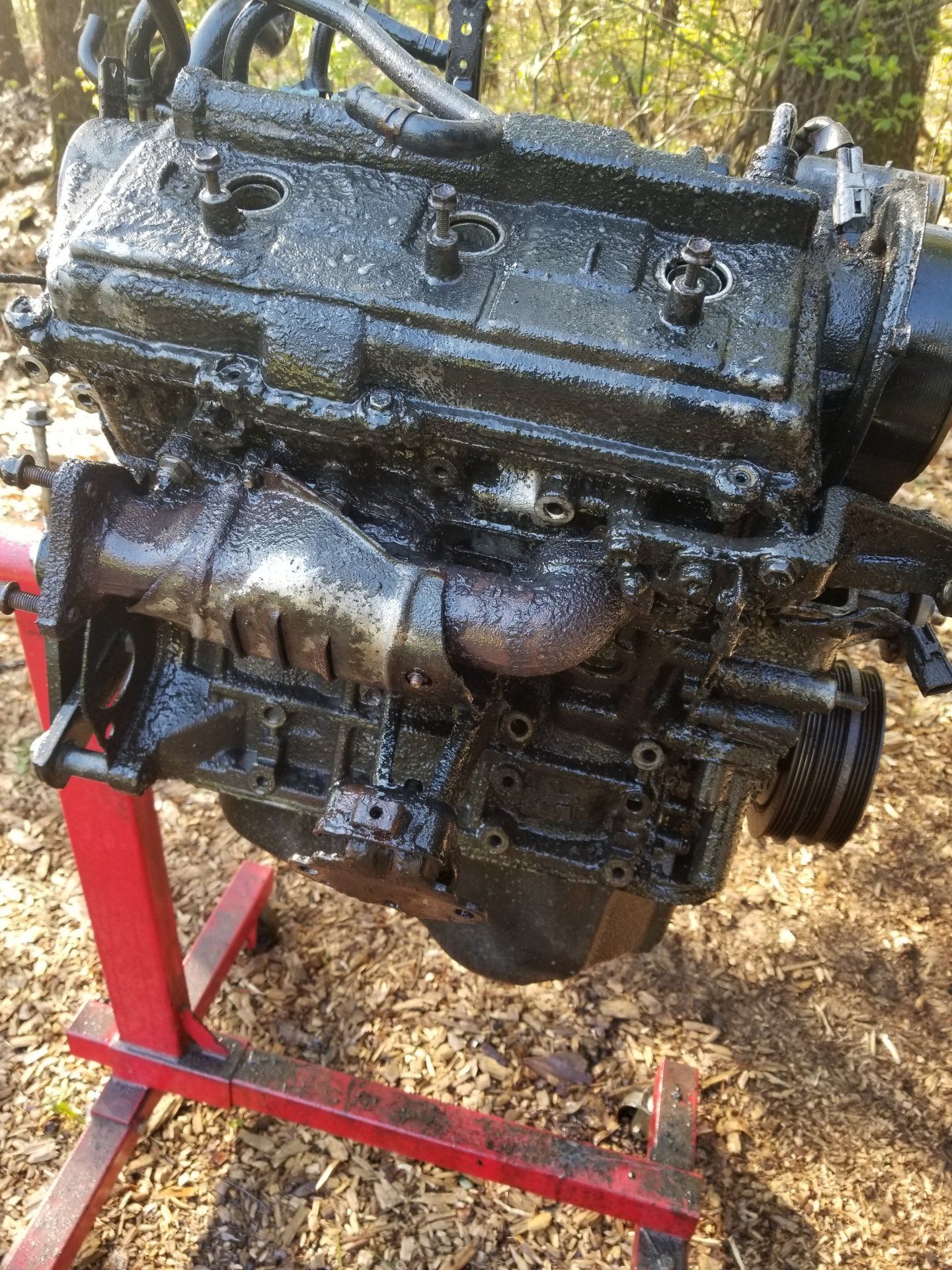

3.4 had a bunch of leaks. High mileage and plugged PCV. I was a greasy mess for a couple of days. Lots of time at the parts washer and blasting cabinet. All the parts are clean, but waiting on Amazon and Rock Auto to get me parts. Timing belt looked OK but had last been done about 160k ago. Oil pump housing has antifreeze crusties on it from a water pump at some point. Had a completely separated motor mount. Nothing unusual or unexpected. I haven’t plastigauged the rods and mains and cam bearings yet, but it ran strong.

Dyed the center console. Was brown, now gray. Still have a tan teq tshirt pad on top.

The valve cover seals were hard as a rock and split. Front and rear mains were leaking pretty good. PCV was plugged. Kept everything from rusting.

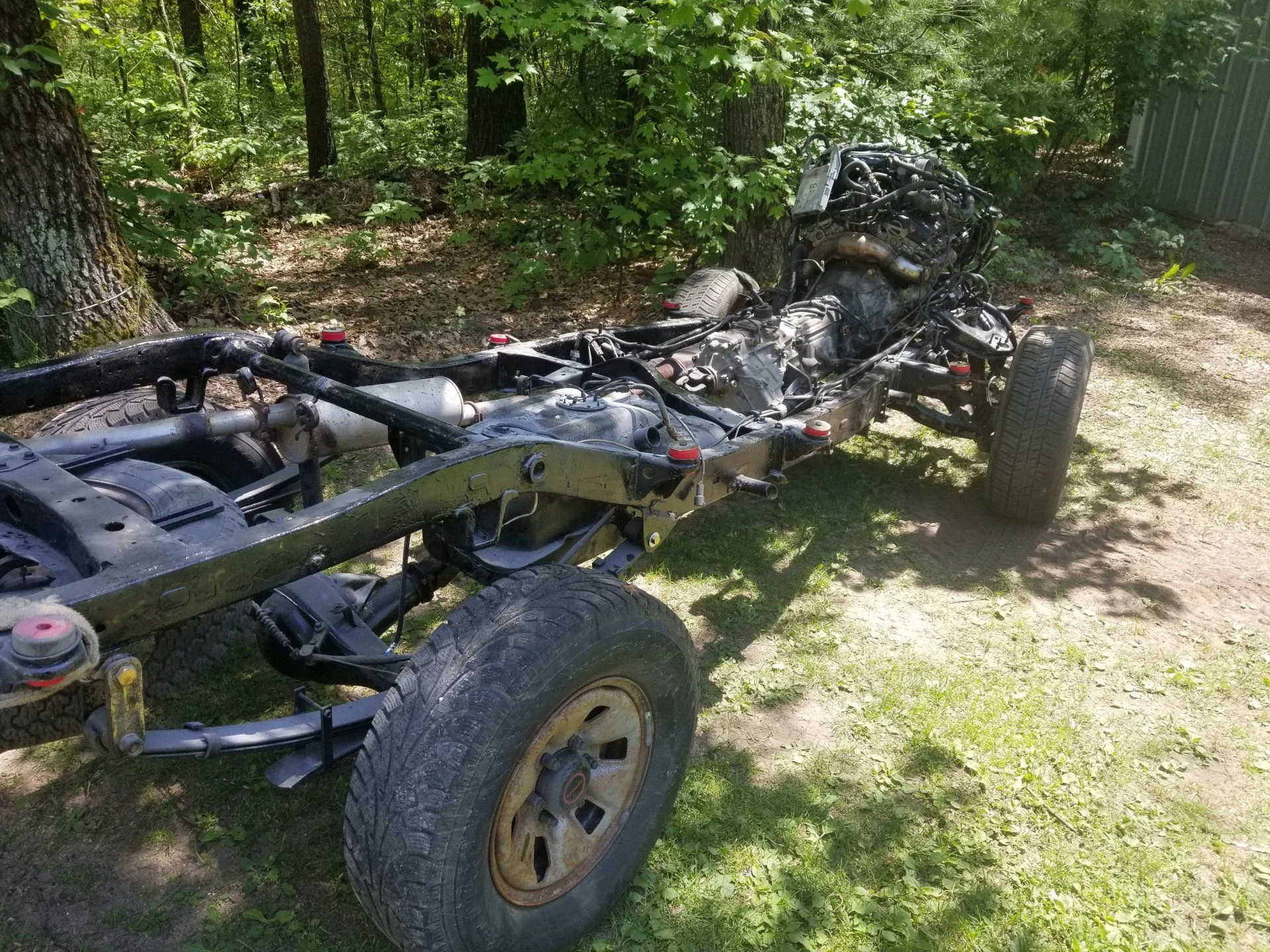

Frame springs axles, and gumby are POR15ed.

POR-15 on the frame,

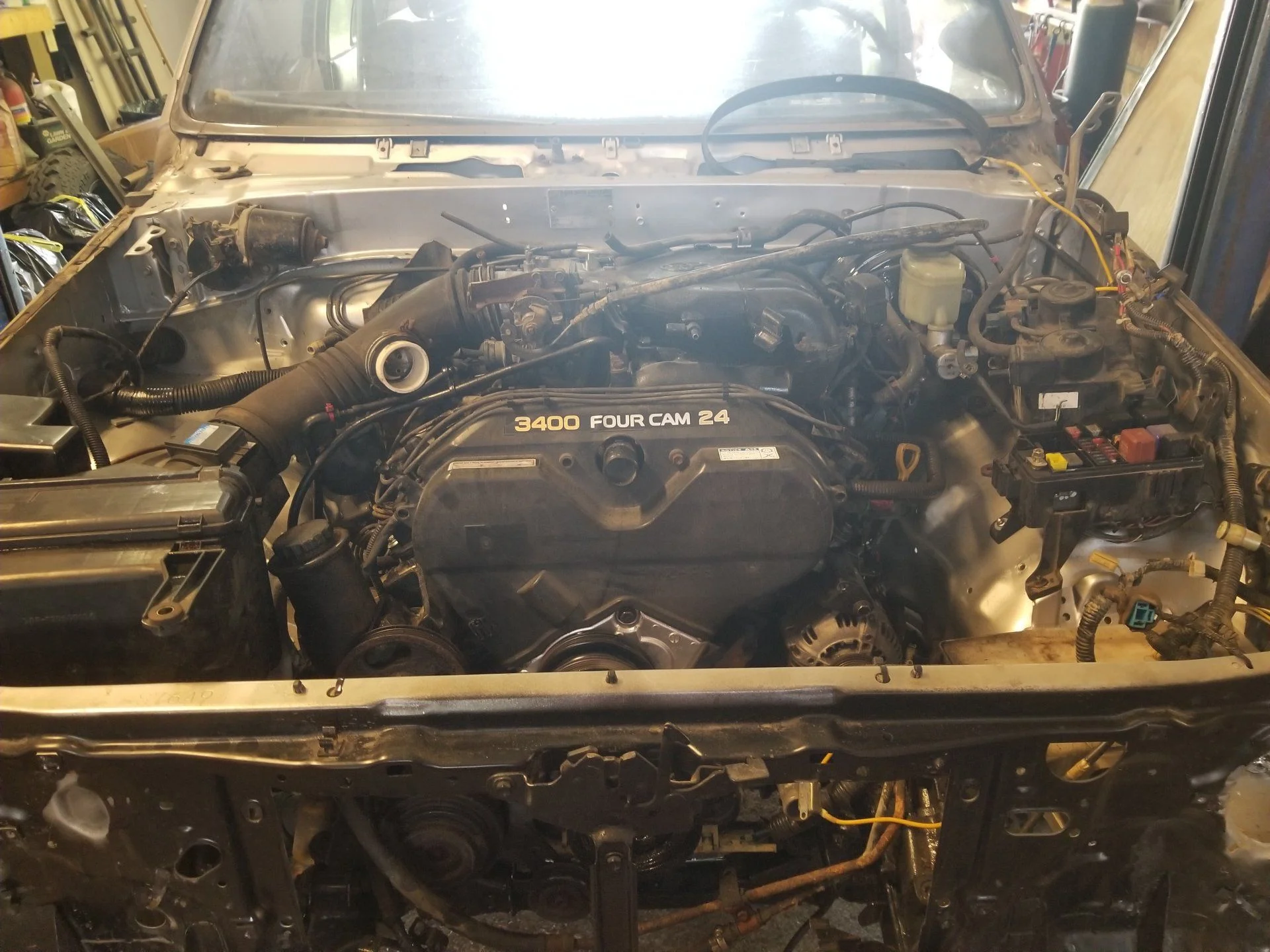

97 3.4l with new water pump, timing belt and resealed

For anybody thinking about a 3.4 swap start with a whole T100 and a 3.0 1st gen.
I built the crossover from looking at the stickies thread on Yotatech.
Kept the cat from the 3rd gen. O2s May have to be moved, but they clear the torsion bar with a little pipe tweakage.
The stock cross member is super easy to modify
The driveshaft from the T100 fit in front and the one from the 86 fit in back.
3.0 motor mounts are supposed to be shorter, but the ones I bought were the same as the old 3.4.
