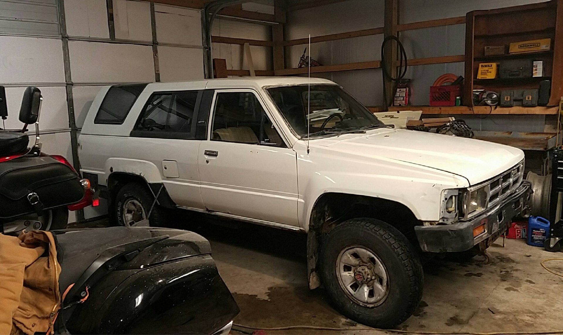

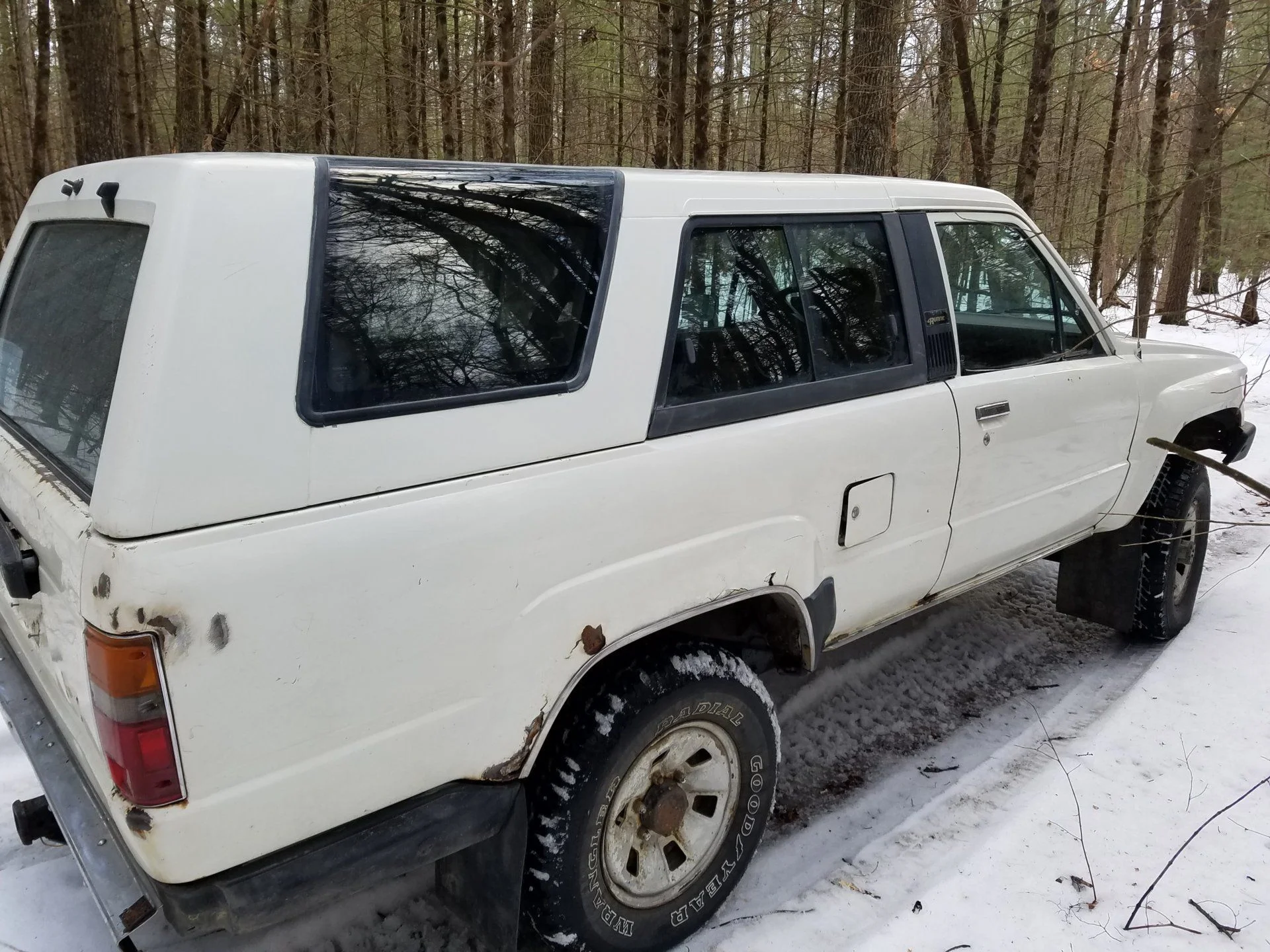

About a year ago I bought a 1986 4runner off of Craigslist. The owner said he bought it after the PO had done a HG. Then it quit running and he couldn’t get it started. I called, told the guy I was an hour and a half out and to please call if he sold it. He got lots of calls, but told them I was on the way, so I gave him full price. $600. He said some of the callers told him the no start was because he had the inlet tube off. He said if I put it on and it started, he wasn’t selling it. We pushed it up on the trailer.
It took a bit more to get it running, but not a whole lot more.
the next day I went and picked up a free body off of CL. First of lots of free parts, mostly from a group of Windy City land cruisers and Hoosiers cruisers.

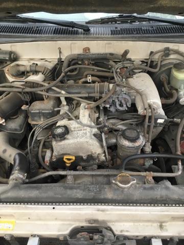

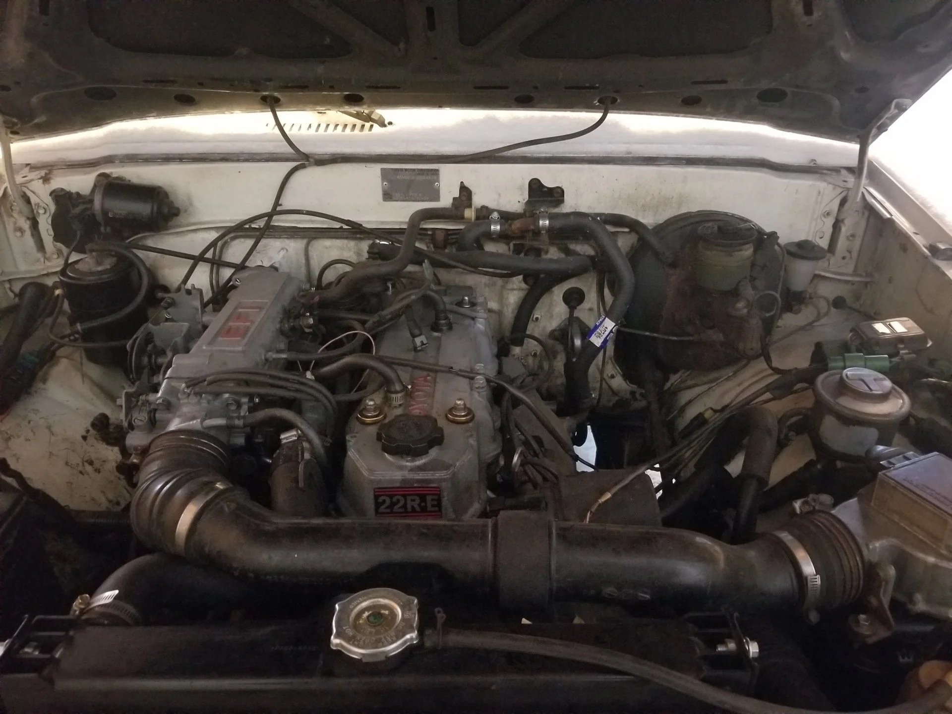

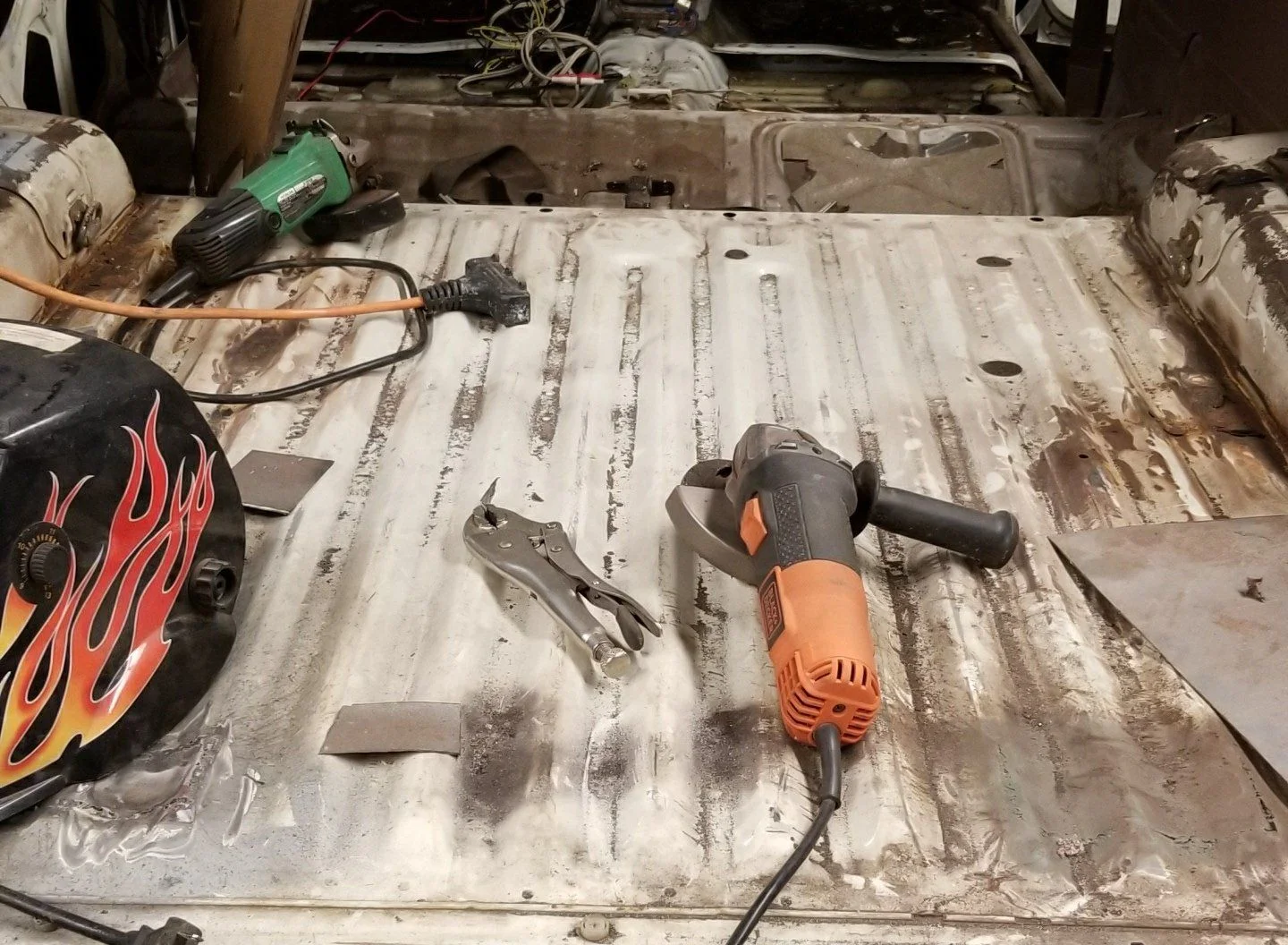

New brakes, half shafts, idler arm, timing set, plugs, wires, shocks, radiator, belts and hoses. All new fluids. Media blasted and powdercoated a few parts. Got a new 22re sticker from toyota. Lots of sorting vacuum lines and leaks, but finally got rid of the idle surge.

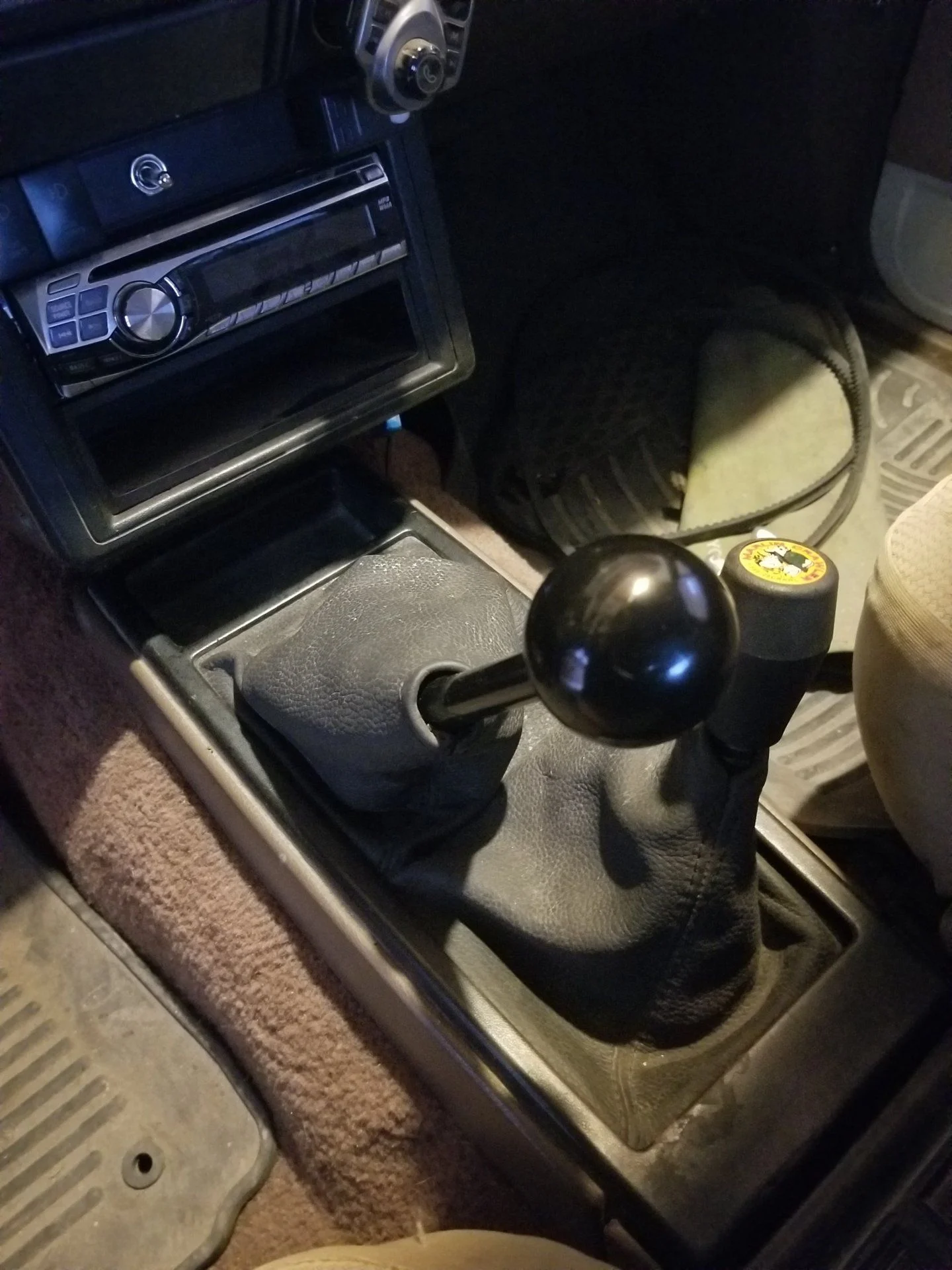

Ordered a new shifter scrotum off of eBay and installed the Marlin Crawler knob and a round generic one I had laying around.

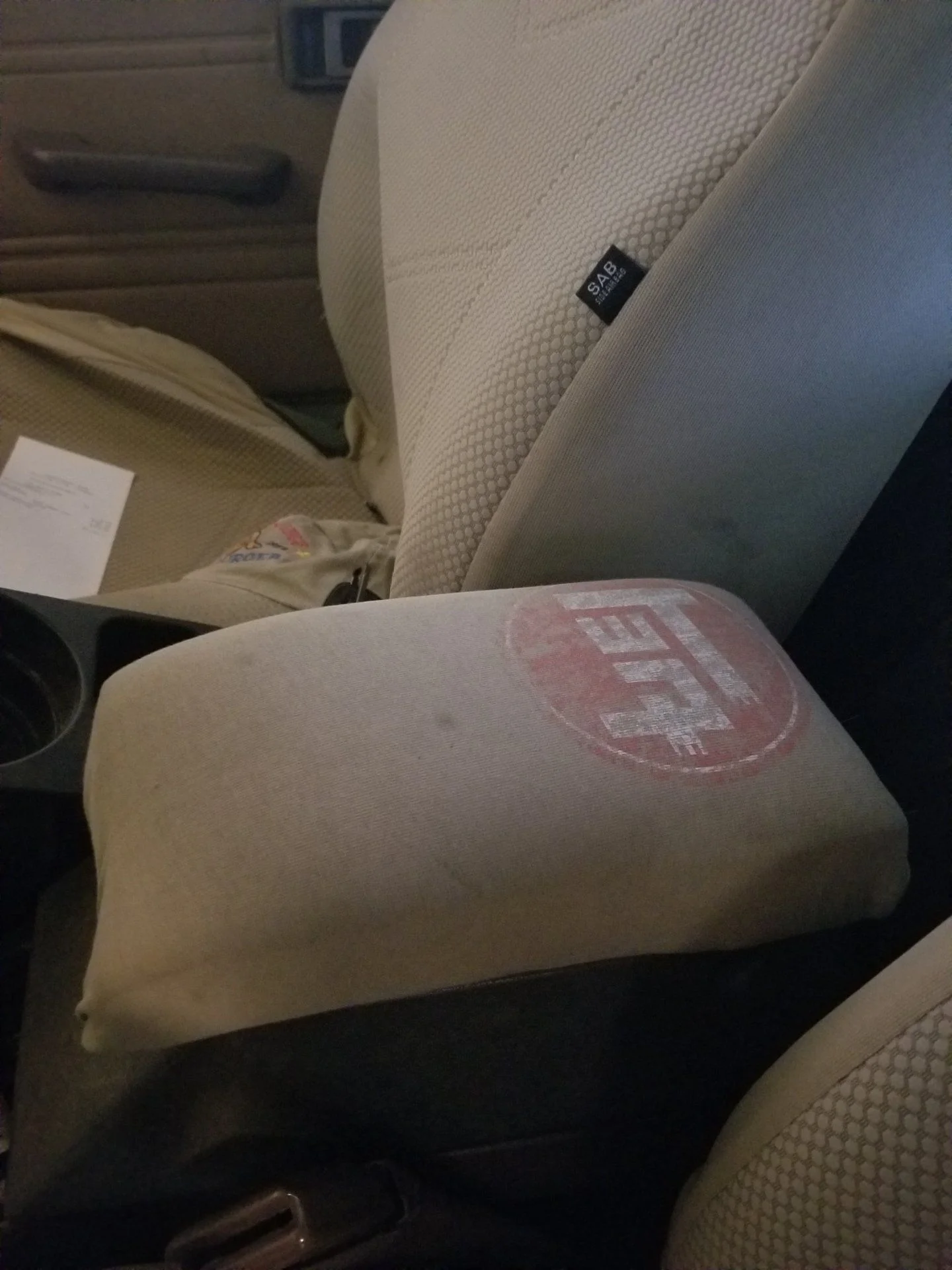

Recovered the arm rest with an old t-shirt and some memory foam.
Removed the rear bumper and brackets.

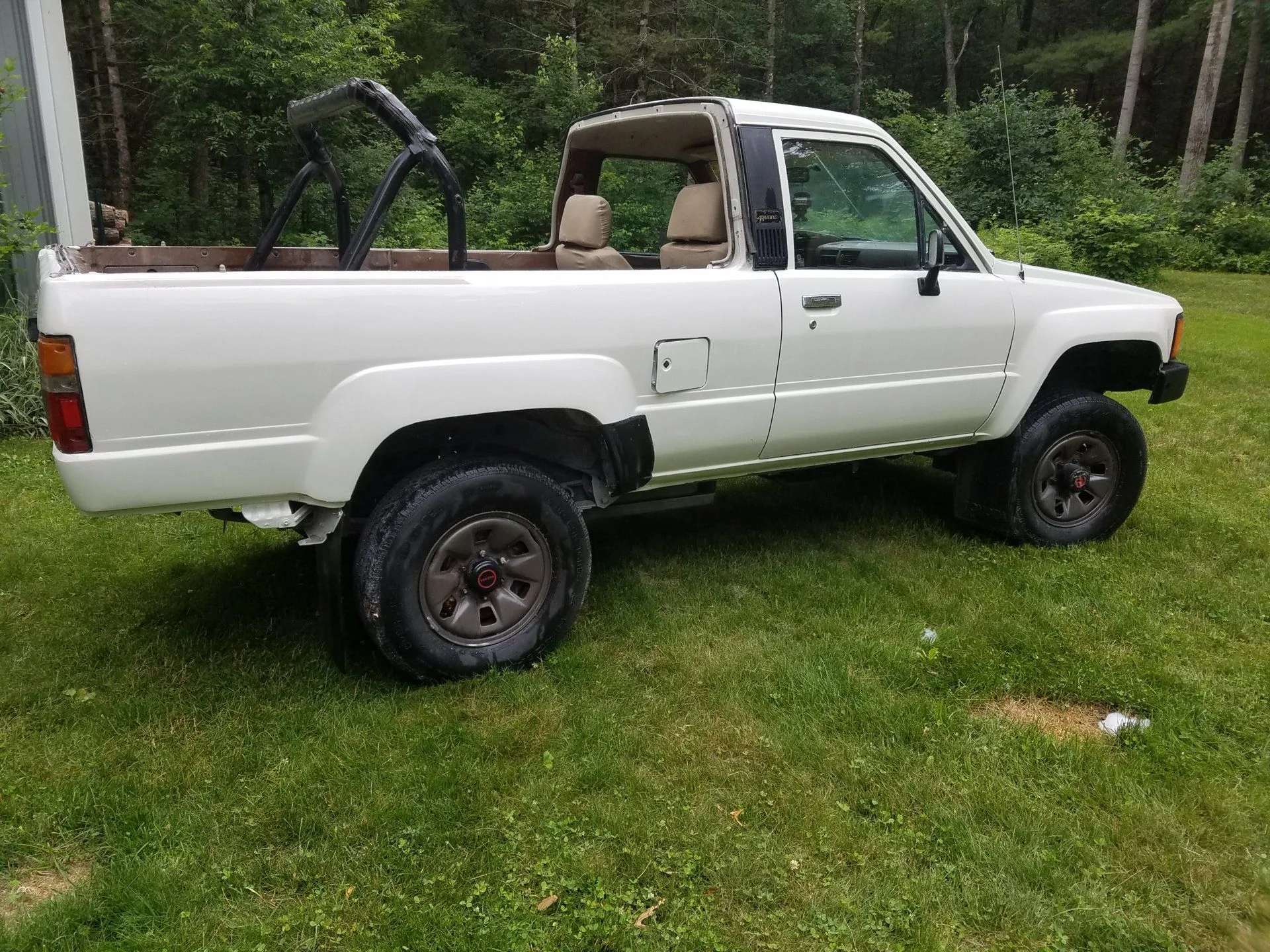

Installed 1” lift blocks to raise the rear level. Installed new shackles.

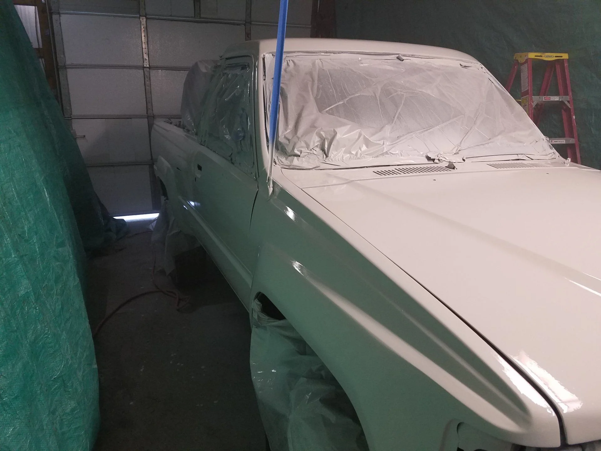

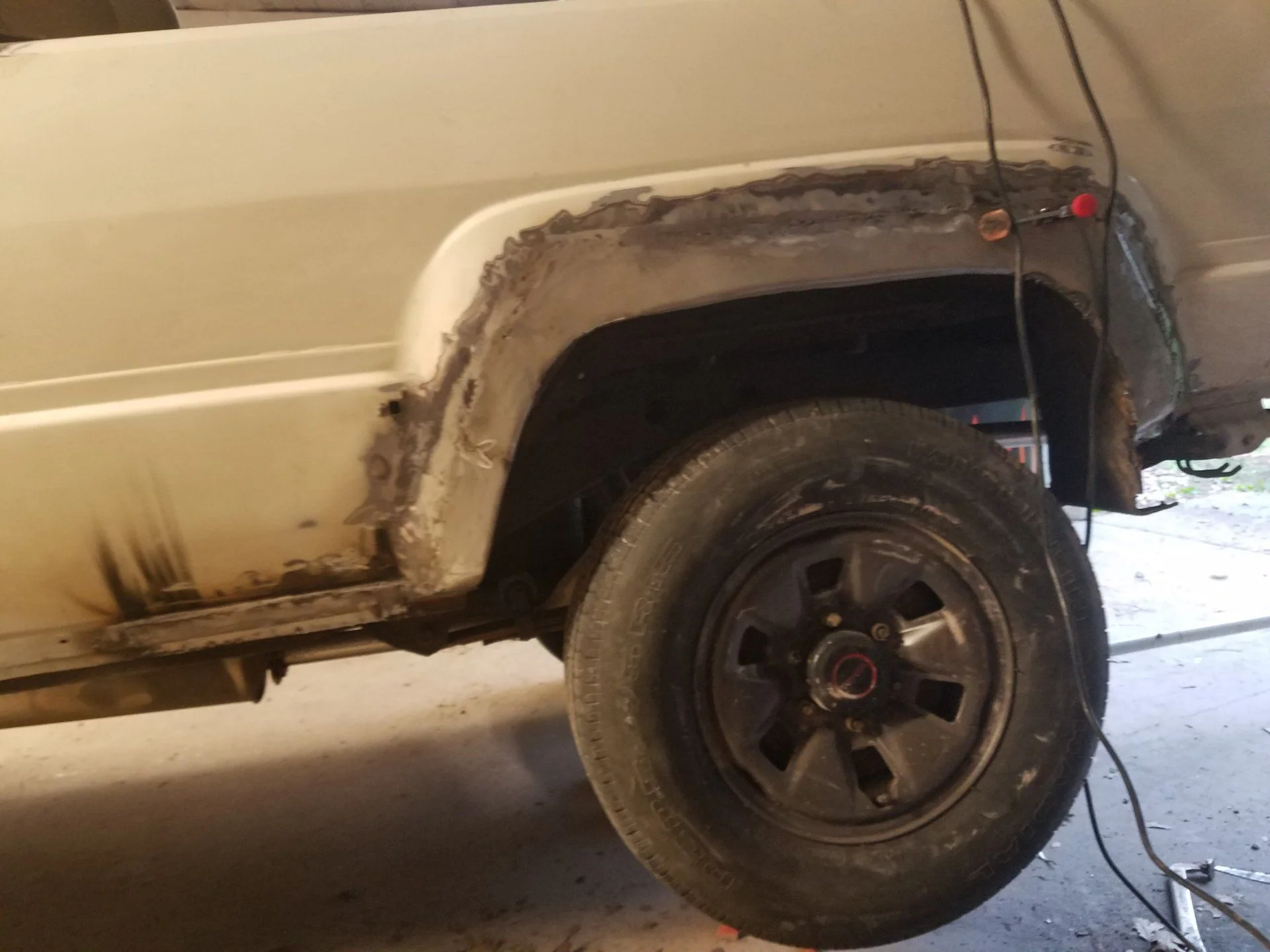

Cut out all the rust in the arches, and welded in new metal. Fixed the rockers and tailgate too. Set up a visqueen paint booth and gave it a quick paint job in 033 white.
Got a new lower valance too.

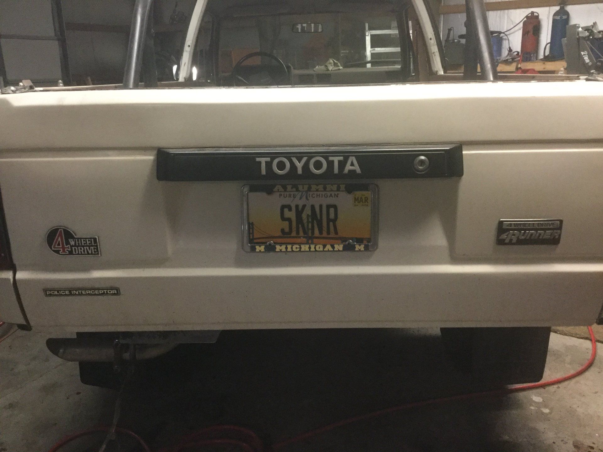

A friend got me a license plate light cover from a boneyard. I had to make new mounts. Light socket was gone so I bought two led bolts. Ordered the 4wd badge from a mud vendor. Ordered a new plate.

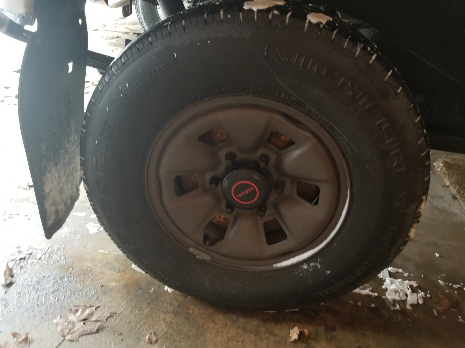

I took both sets of steelies to work, tumbled them in the bead blaster, then powder coated one set silver and one gm rallye charcoal. Bought new center caps for the rear from Mr. T. Cleaned up the front hub covers, rebuilt the hubs, media blasted and painted the dials.

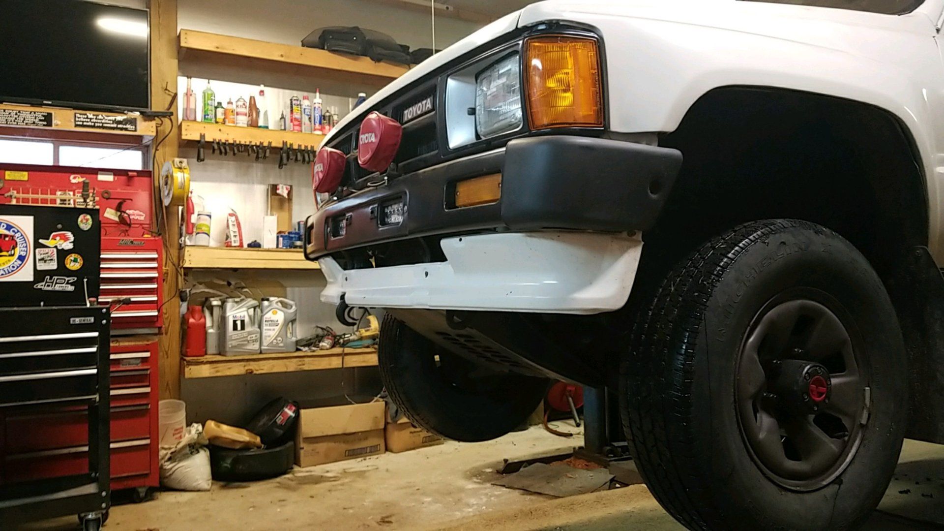

I had a pair of led driving lights I put in the bumper and bought a pair of 5” rounds for a pair of old Toyota kc daylighter covers I had.
Bumper is RA. Grille is painted parts truck. Valence is RA. Skid plate is generous donation from buddy doing an sas.

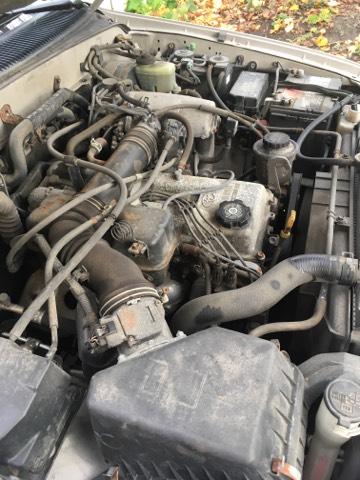

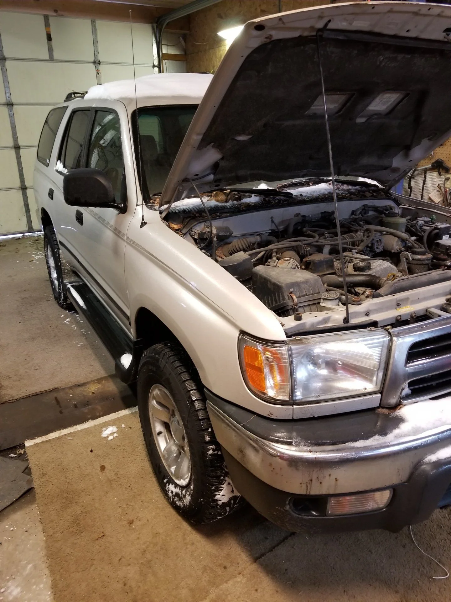

I started the thread because I’m picking up a 3rd gen 4cyl 2wd tomorrow with a milkshake trans. I have enough parts sold that I’m going to get the motor for a couple of hundred bucks.
I wanted to document the 3rz swap from the start.

Got the 3rd gen in the shop. Looks pretty good. Runs great. Trans is junk.
2000 is a coil pack, so 2nd gen 3rz. That should be OK. Good snow tires for the 1st gen, just gotta run the 16 3rd gen rims.
