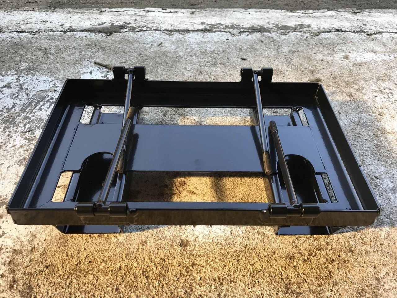

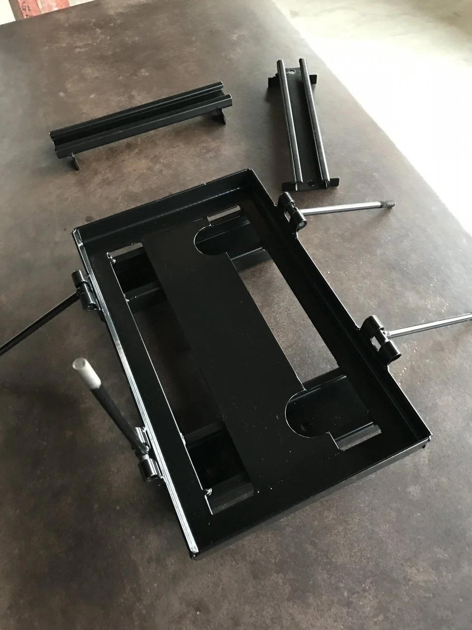

It's amazing how a little finishing make something look so professional. "Back from the Powder coater" is one of my favorite things to say. They burn it at 500c, shot blast it and then coat it. Cost me $30.
Pete

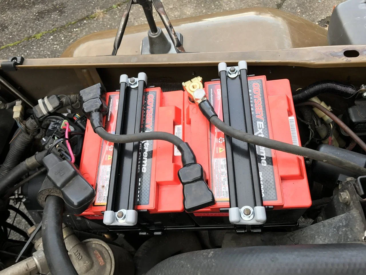

Got them installed. The slim uninstrut worked out perfect for the top cross bars. I suppose I could even use it to mount something small if need be.
Pete
The battery mount, and the install, is very professional looking. Of course, I would expect that from what I've seen in the past of your work.
Don
Thanks for the compliment Don. I try to do as well as I can but as a result it takes a long time to make progress. The hinged hold downs were from the original trays so that helped a lot.
Yesterday I ran a wire from the Espar heater into the cab which will trigger a relay to turn on the cab heater blower automatically when the coolant reaches 30*c 86*f. Then the Espar/battery instal project will be complete. It took over a year to get it done- but looking back over the last year I've:

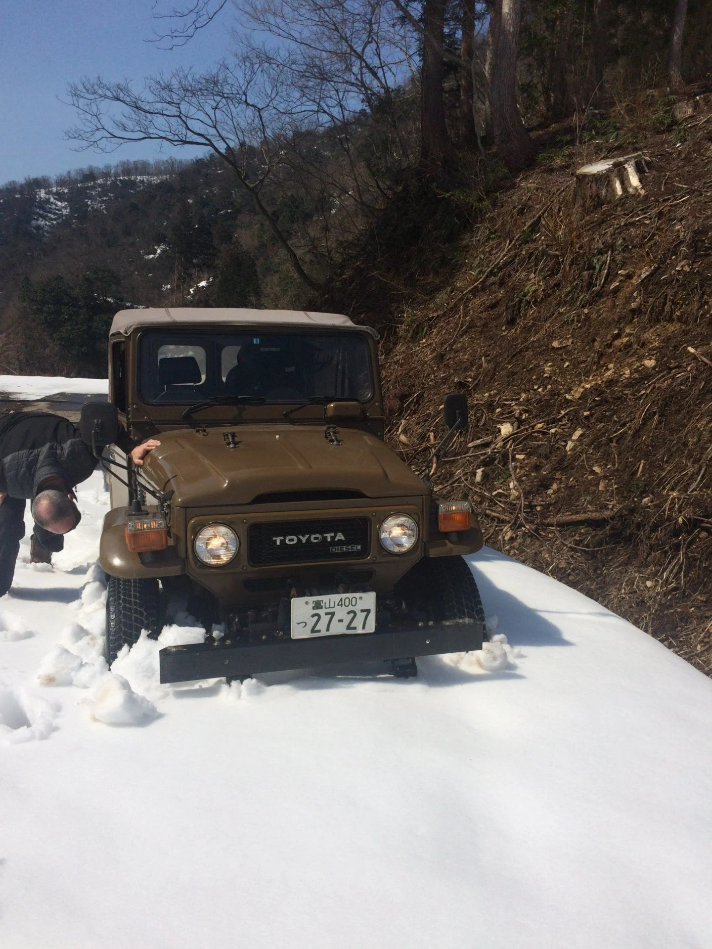

For example I've always wanted a highlift or something that I can pull myself backwards with but I've never bought one just because I'm not sure I'm willing to give up the space. Well I went out today with the kids in the snow I got halfway up the mountain in the front tire fell into a drainage ditch ithst was was buried in the snow. I needed to pull myself back out of the ditch and I started getting concerned that we might be spending the night.
We weren't that far out so I wasn't that worried about it. Just sleep till the morning get up and walk out. In the end I managed to get out with just a shovel. If need be I had the factory Jack And that probably would helped out as well. But I can see how if those methods had to work I would've been pretty relieved of had that highlift to pull myself backwards with so I'm reconsidering……

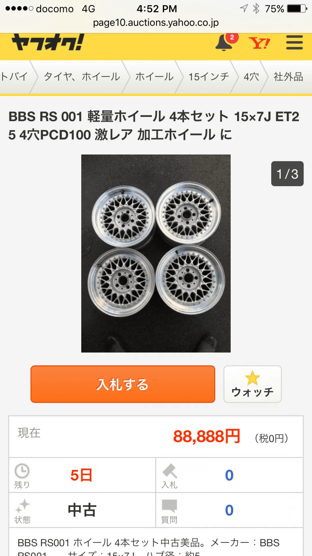

So a little hiccup in the goodness of my cruiser life- my new 16x7 wheels that I painted and clad with 255/85-16 tires were stolen. Along with them went 2sets of wheels for my 73 BMW.
And- one set of the BMW wheels is on an online auction right now. I know their mine cause these wheels are somewhat rare especially in Japan where there there were not many BMW around back in the day- and their for sale locally. There are other clues that make it obvious but- no proof. The only way I could prove they're mine is if I shell out the $800 their asking for them and hope that some of my fingerprints are on them when the arrive- a long shot....

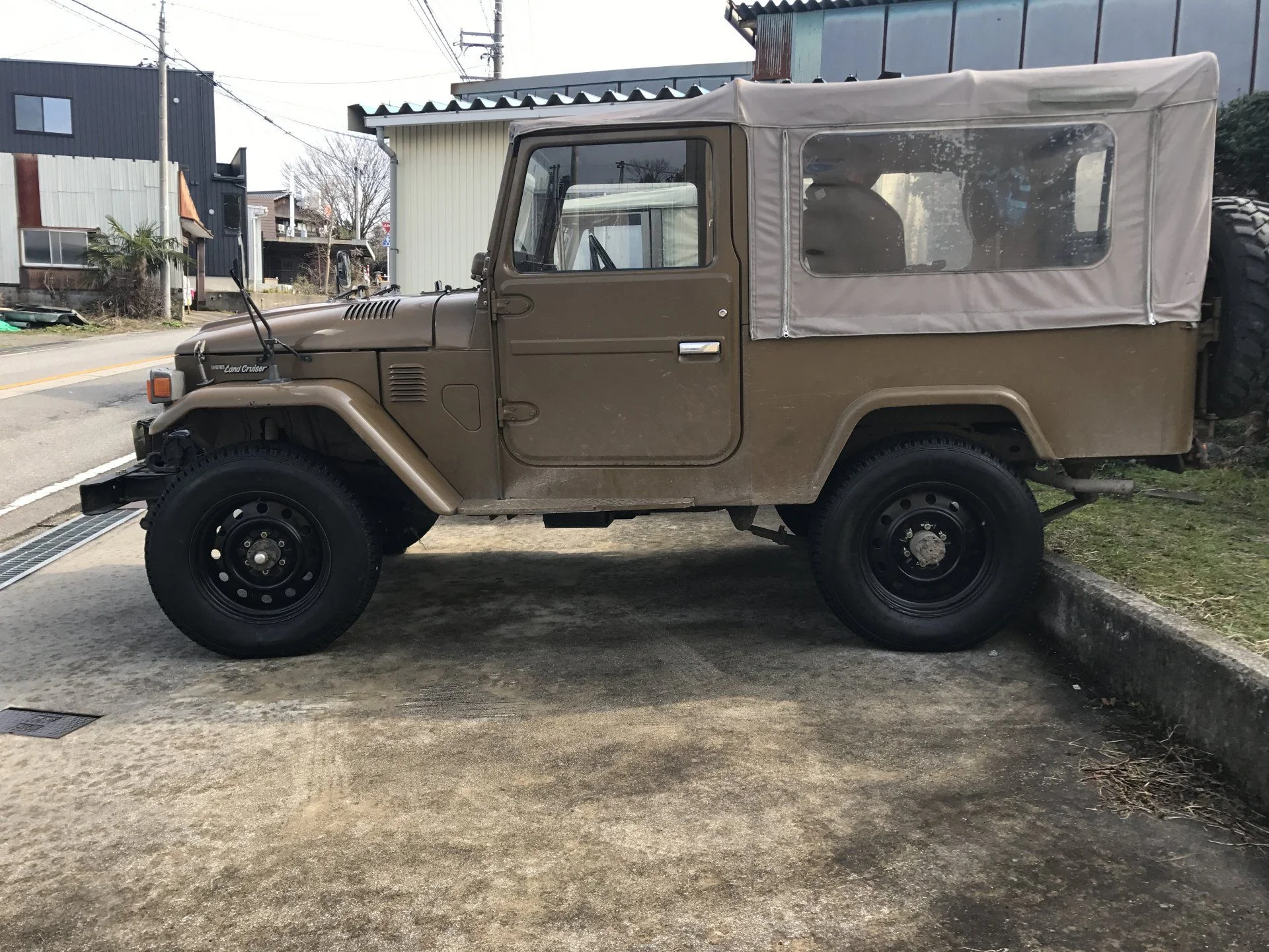

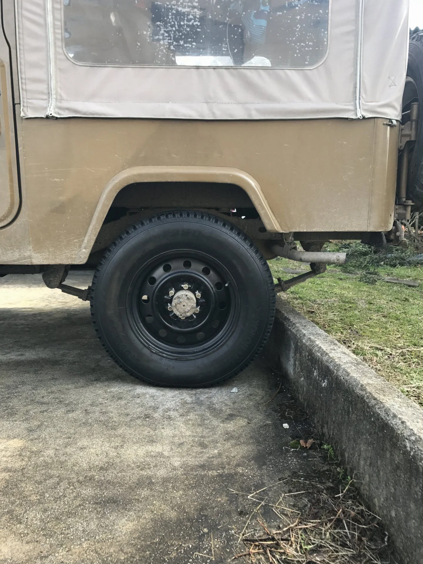

On with the good side I came across the rare wheel set from a Japanese defense force truck. They are 18 x 6" with a 0 offset and take a 215/85r18" tire.
The tire measures out to almost 33" so almost the diameter of a 255/85-16 but the width of a 7.50 so they fit under the fenders and can pass the yearly safety inspection. Here next to my current 7.50 snow tire:
Cool size! Also I could put on a 7.50r18....... at 35x8.5" it's the ulitimate tall skinny tire....
Anyway looks pretty decent with the 3 inch lift I have. And I still have room to fit snow chains. At $200 for the set I think I did all right.

But what the heck on the theft?!?! Is this kind of crime common there? Aren't the police helping you? Seems they would be VERY interested in that auction listing..
Well tire and wheel theft- I have recently learned- is very common! The police can only help me in terms of the stuff in the auction if there is some kind of identifying mark that only I would know and there is not unfortunately.
There looking into it but there's a good chance that the people who are selling the wheels in the auction bought them from someone else. All they have to do is claim that "they don't remember who they bought it from because they buy stuff from people all the time."
Pete

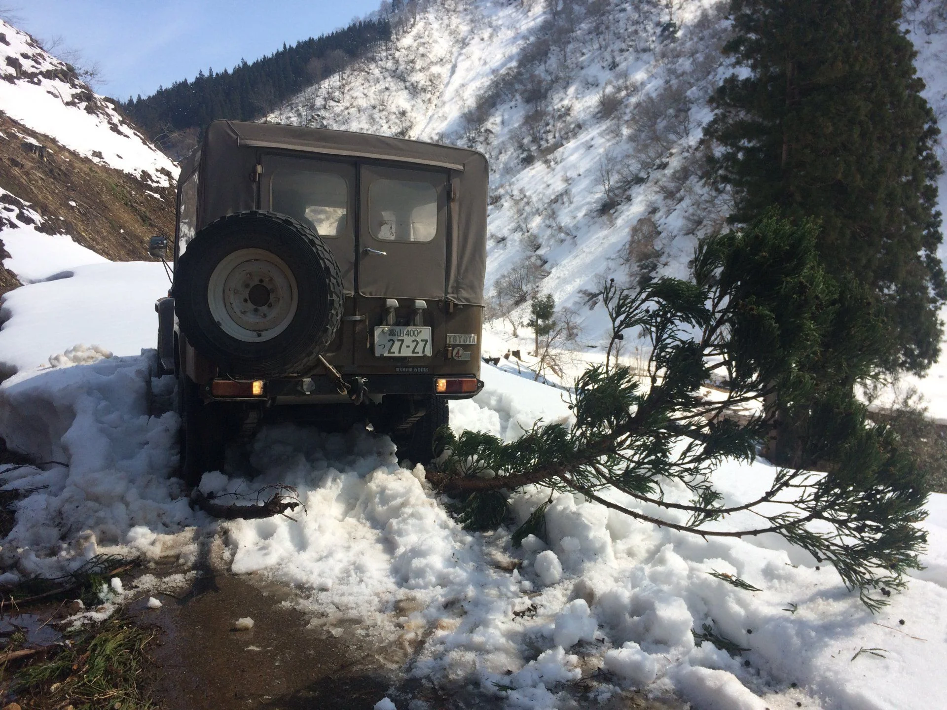

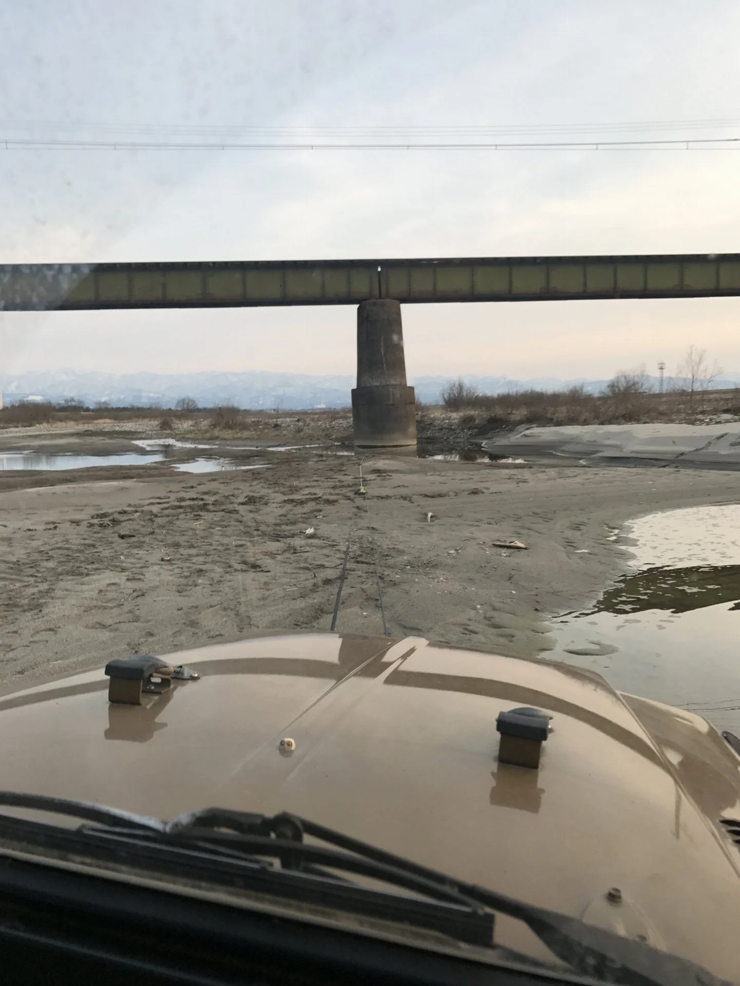

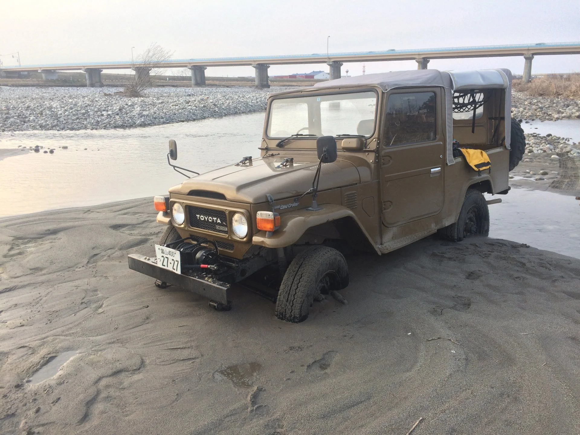

So I put my recovery equipment to a good test today. I carry a 50 foot rope, a 100 foot rope, 125 feet of rope on the winch, a pulley, two straps and three soft shackles. Based on my experience today I'd say my kits complete enough for my needs. I really didn't think I was going to get out of this without shearing the pin (I also carry spare in addition to a hammer and punch )on the winch but somehow I managed.
After a day of getting stuck in half melted mountain snow
I decided to take a quick trip down to the river on the way home. Well it turned out not to be so quick as is often the case I suppose. After finding a way around obstacles that were supposed to keep me from getting down to the river and doing a good run around on all the river rocks I decided to cross over this innocuous pile of sand.
Well I crossed over on the sand and started to sink in immediately stopped. Just the vibration from my little mighty 3b liquefied the sand underneath the truck just like when you vibrate concrete. The truck just sank down so I immediately killed the engine but I was already down below the axles. I stepped out of the truck and my boot just sank. Just look at the the front shackles and you can tell what I'm involved in.
I've been stuck down to the floor in mud. But I don't think I've ever been quite this stuck. It doesn't look so bad but that quicksand is heavy stuff.
I did 2 pulls and re-rigged each pull twice. One pull to the pillar in the picture below got me out of the really soft stuff but just to a small island of dry sand. After I made it to that I tied off to a second pillar off to the right and was able to pull up a sand slope to another dry area that I could drive out from.
So 100' rope around the pillar to a 50' rope to the pulley.
What I learned- synthetic rope is a good thing. The second pillar was in the water- snow melt- i really wasn't interested in going for a swim. I tossed out the rope and it floated downstream. The second rope has closed thimbles (heavy) so I tossed it out over the floating line and was able to pull the floating rope to shore.
Pete

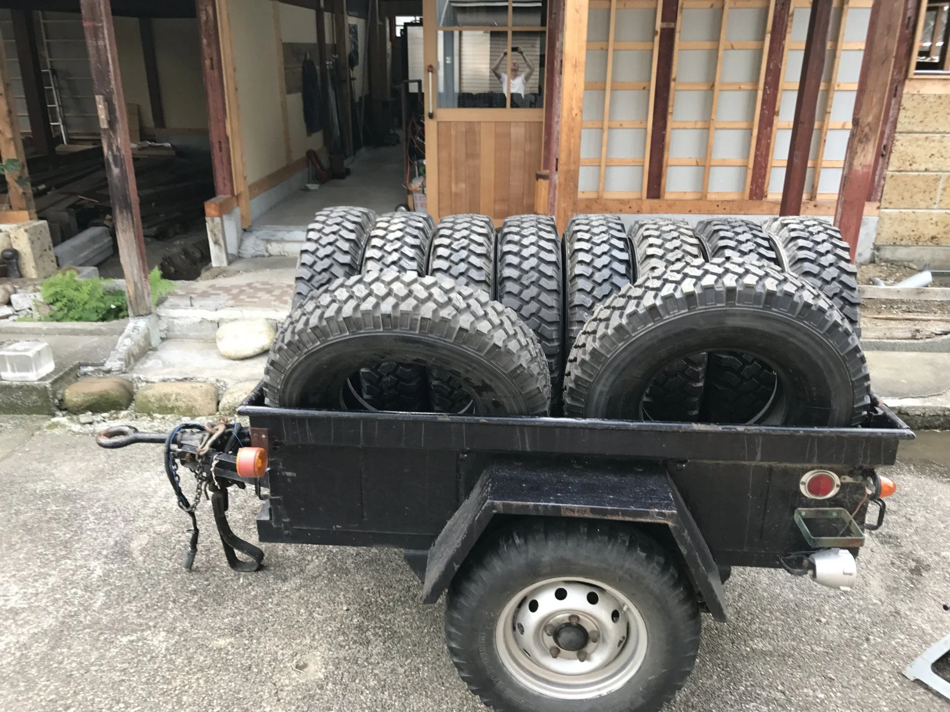

Lifetime supply of treasure/ 10x 8.25 Xzl's

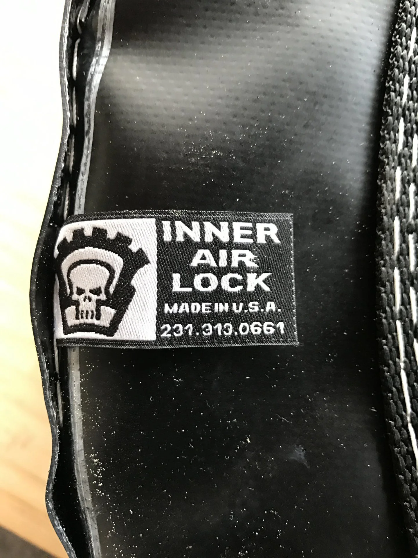

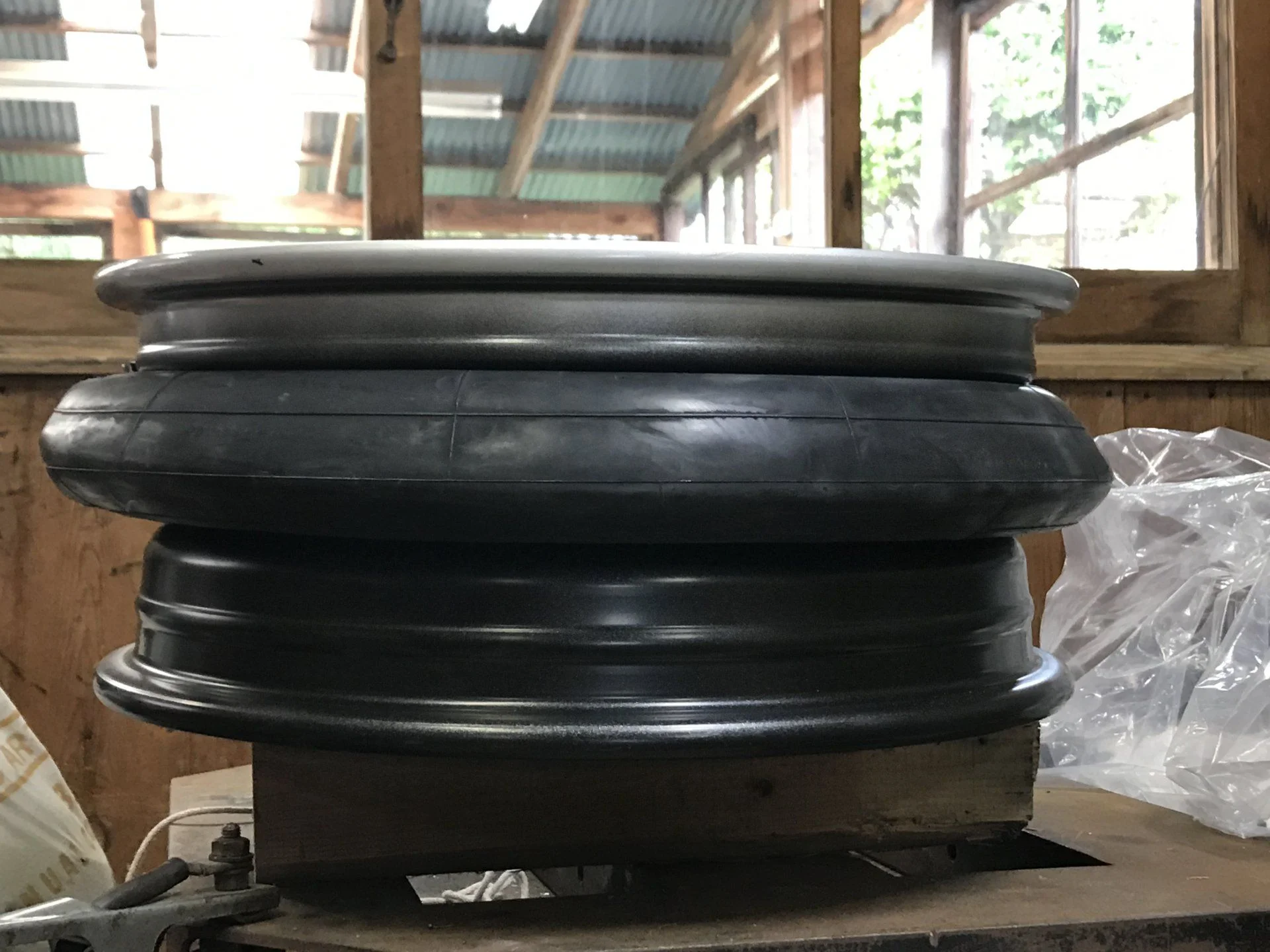

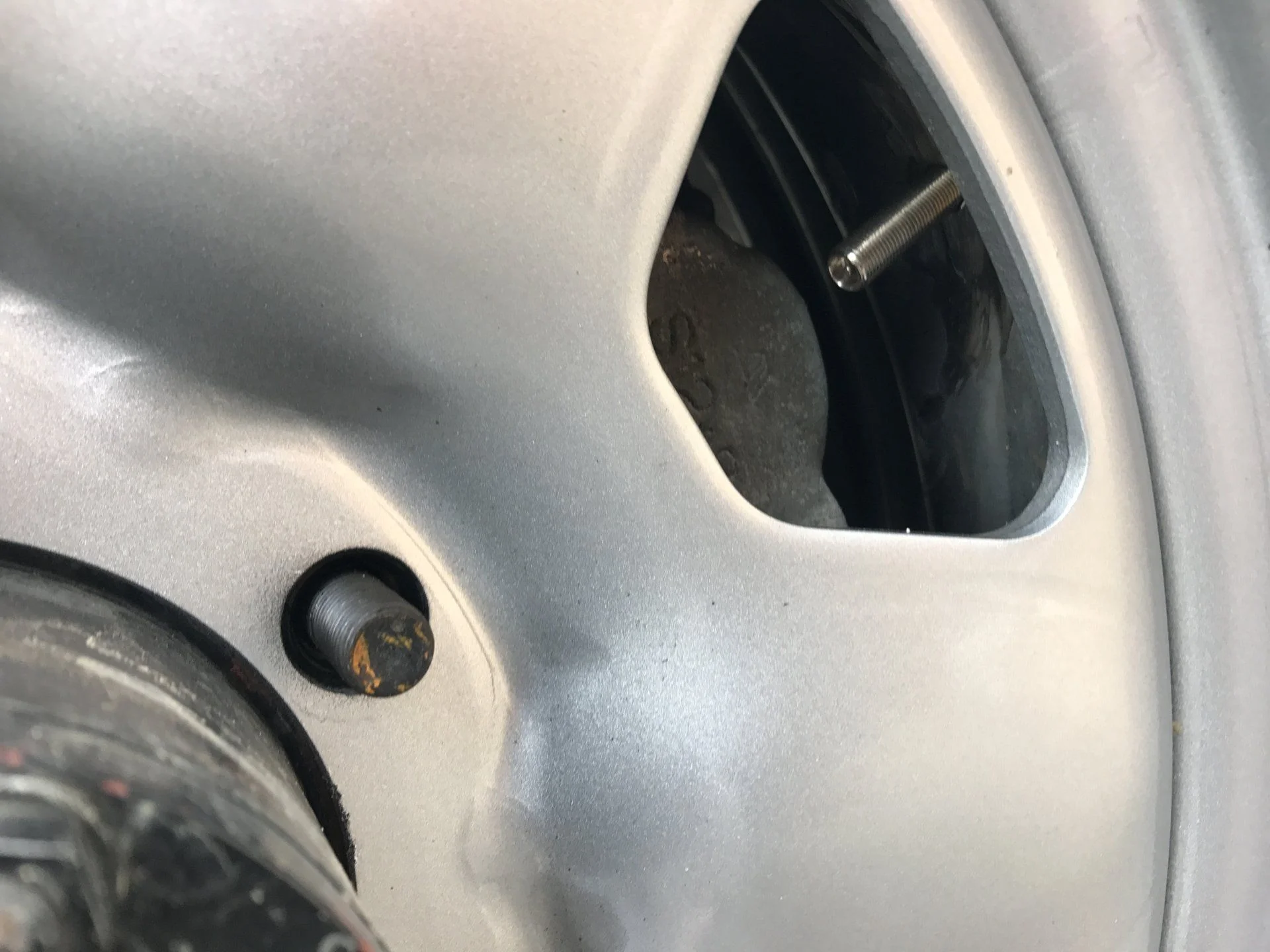

Shawn- The proprietor of inner air make me a custom set for a 6 inch wide rim. The tube is a little bit small looking but I figure since the tube doesn't actually hold weight of the car the truck it will probably be all right.

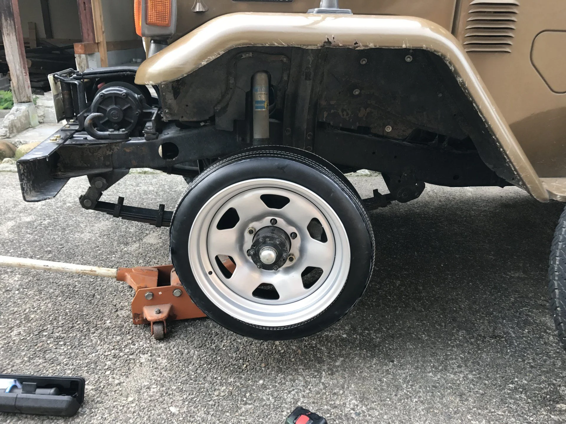

Looks like I'm building a Lowrider.
I couldn't Center the valve stem on the wheel because it would've hit the brake caliper. As it is it just clears and I did have to grind away part of the inner wheel shell to get a flat spot
