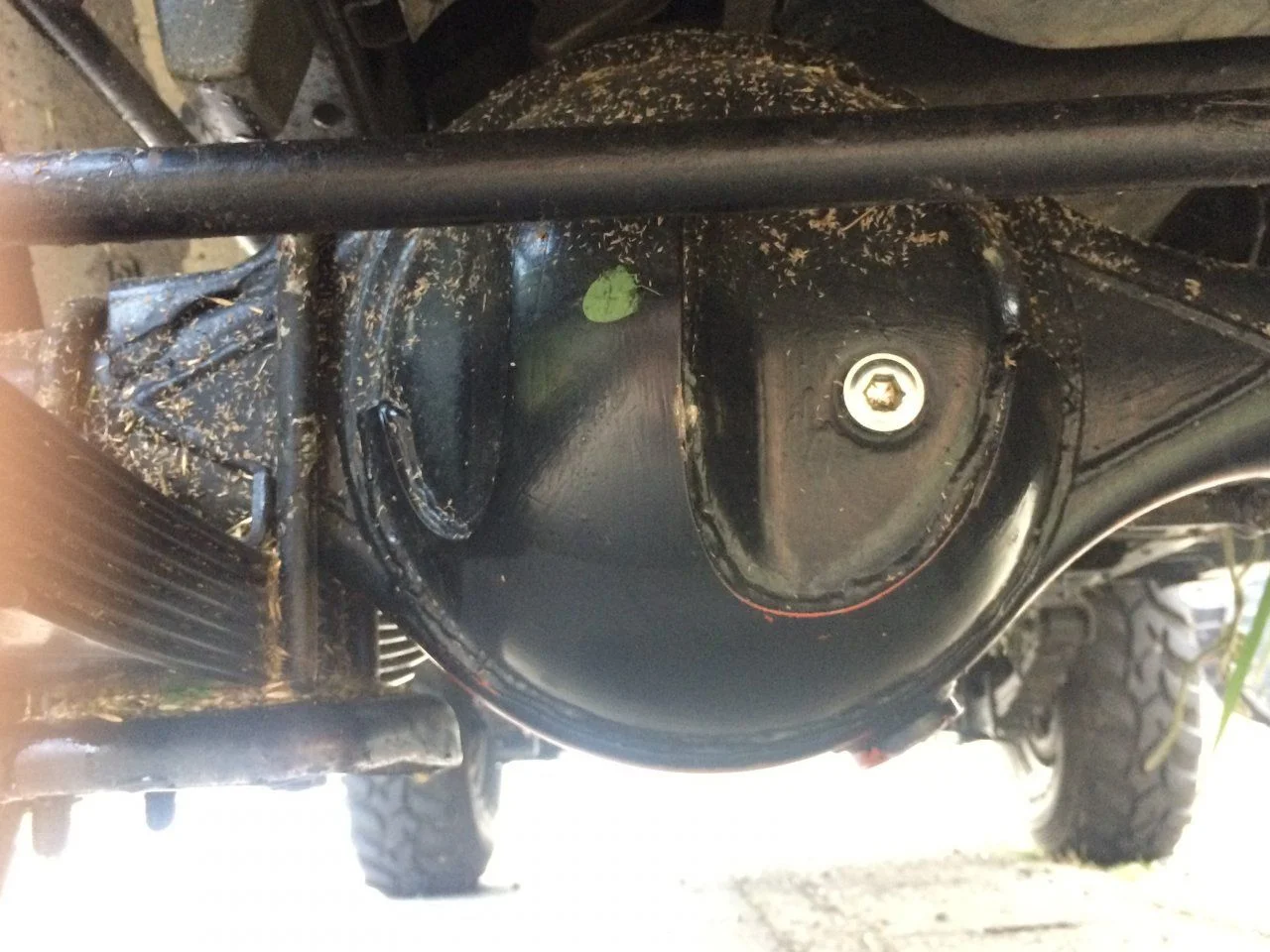

The dif cover does its job. I had a good bump into a chunk of concrete hiding in the grass down by the river and it barely scratched the cover ( left of the drain plug on the edge of the armor.) It would have definitely bashed in the housing without the armor.
It did make me kind of wish I had covered the portion with the drain plug as well. I may add a bar across/in front the drain plug.

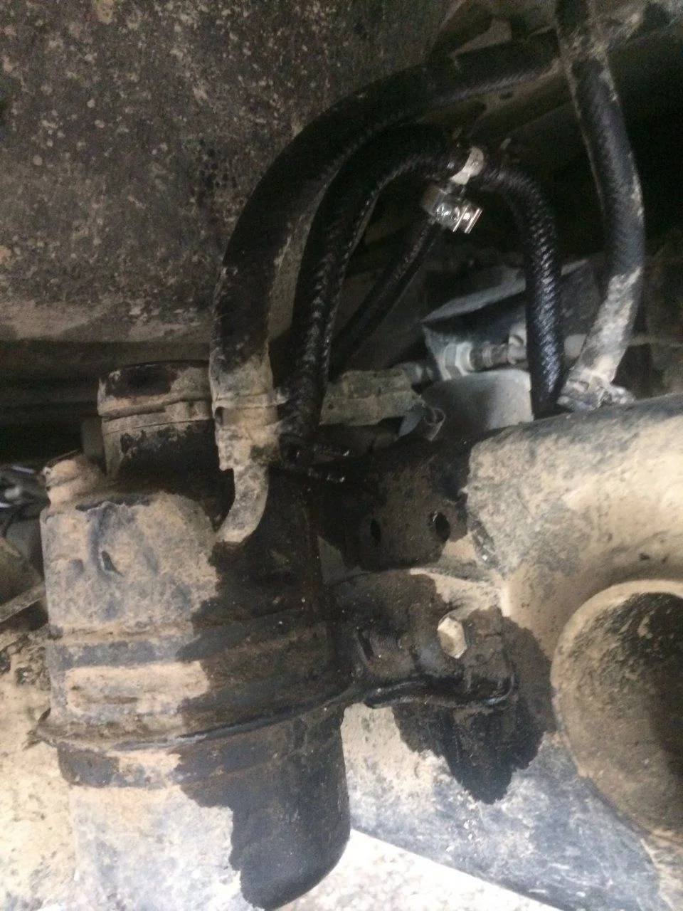

Well this extended my work time by day. So I took the opportunity to extend my rear brake hose with part number 96940-34805.
And extend the front breather hose as well.

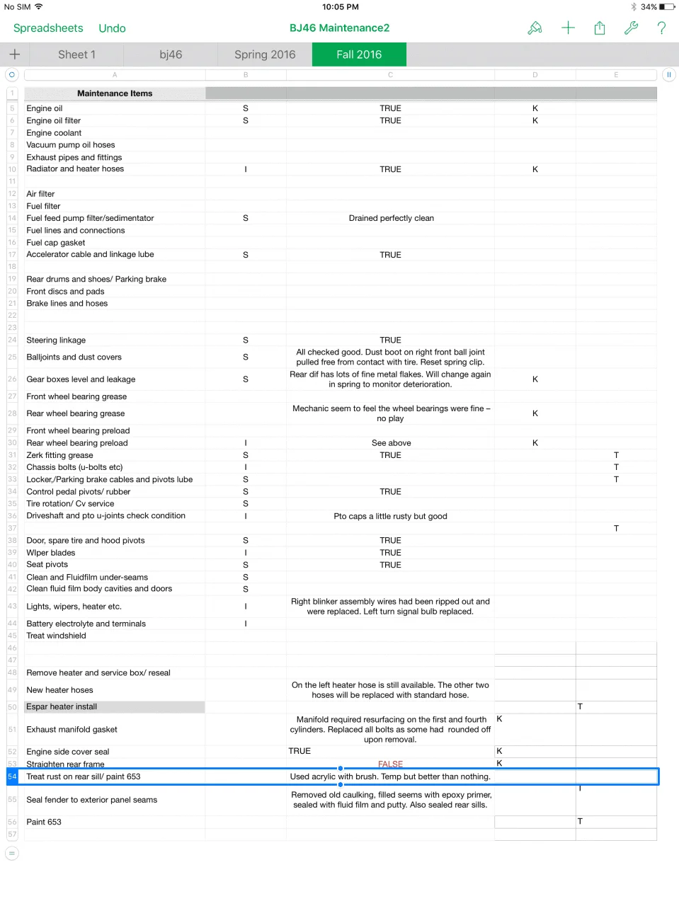

So, it's been a good while since I've many reports but I've been keeping up with regular maintenance:

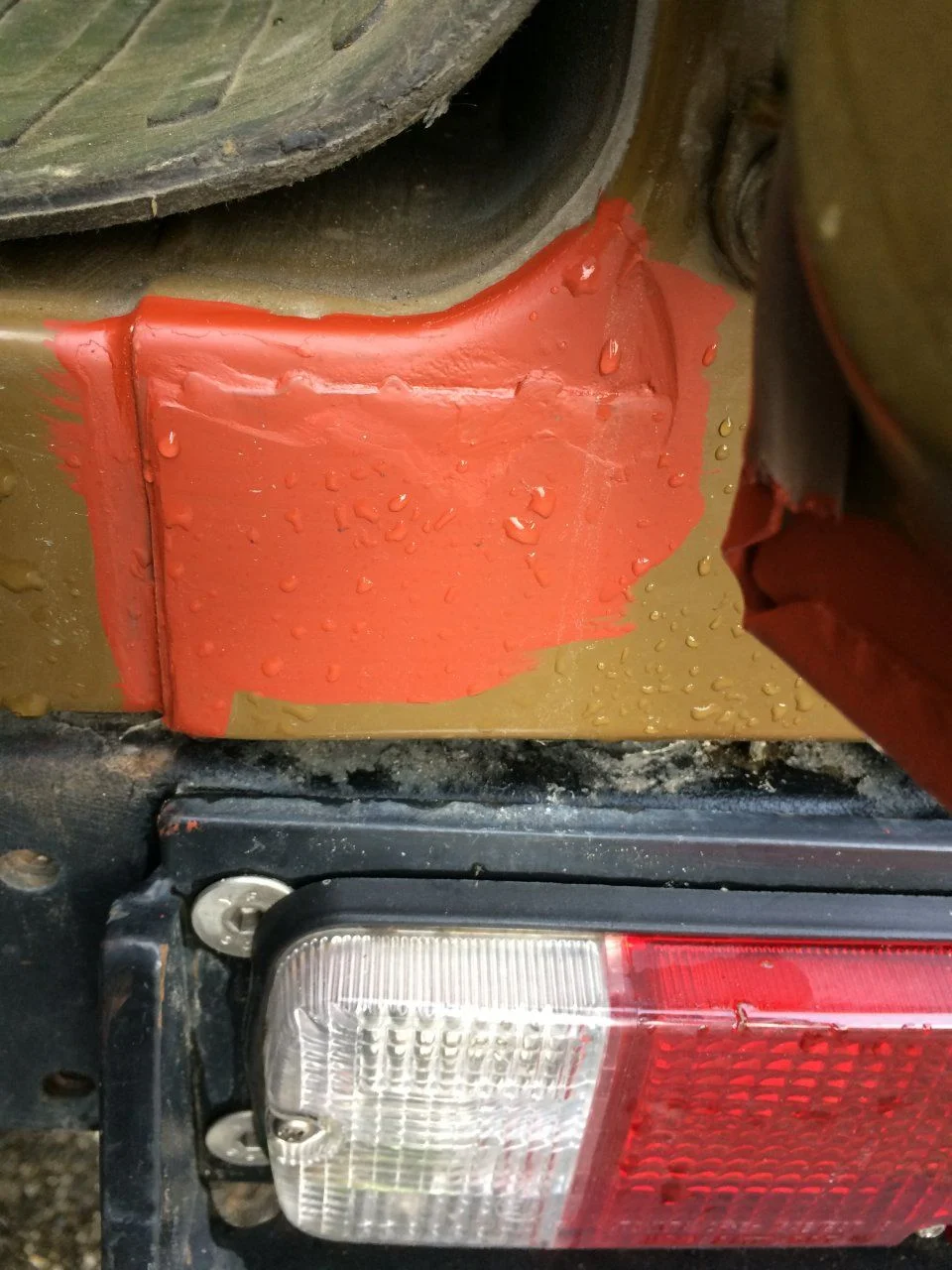

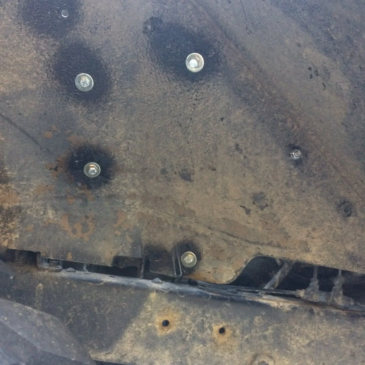

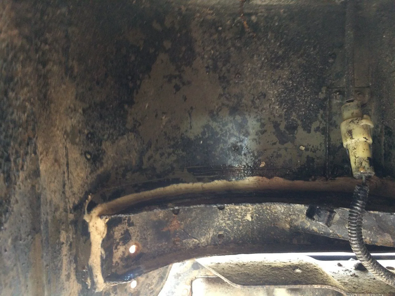

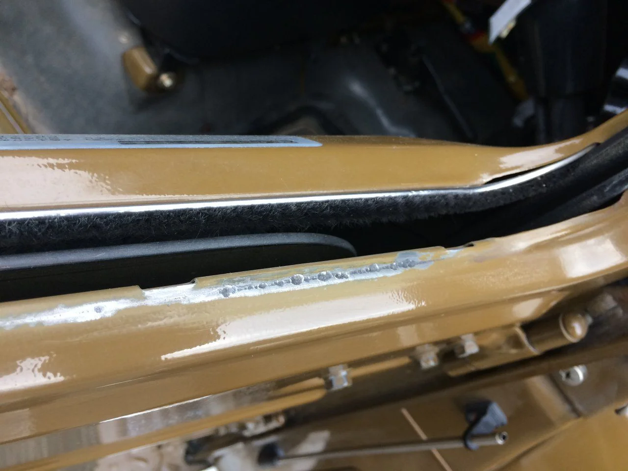

In terms of the body and really taking a maintenance approach. When I find rust I wire brush it away priming with it Red oxide primer. Then brush some 653 acrilic paint for the time being. Eventually when the time comes I'll dive in and give her a good paint job – if the time comes. But for now i'm doing my part to keep the rust at bay.
Also removed much of the factory seen caulking for the wheel wells and replaced it with an oil based putty. I oil the seams every Fall and the putty holds up really well. It's a maintenance based approach rather than applying a long term epoxy coating. But to do that well the seams should be sandblasted.

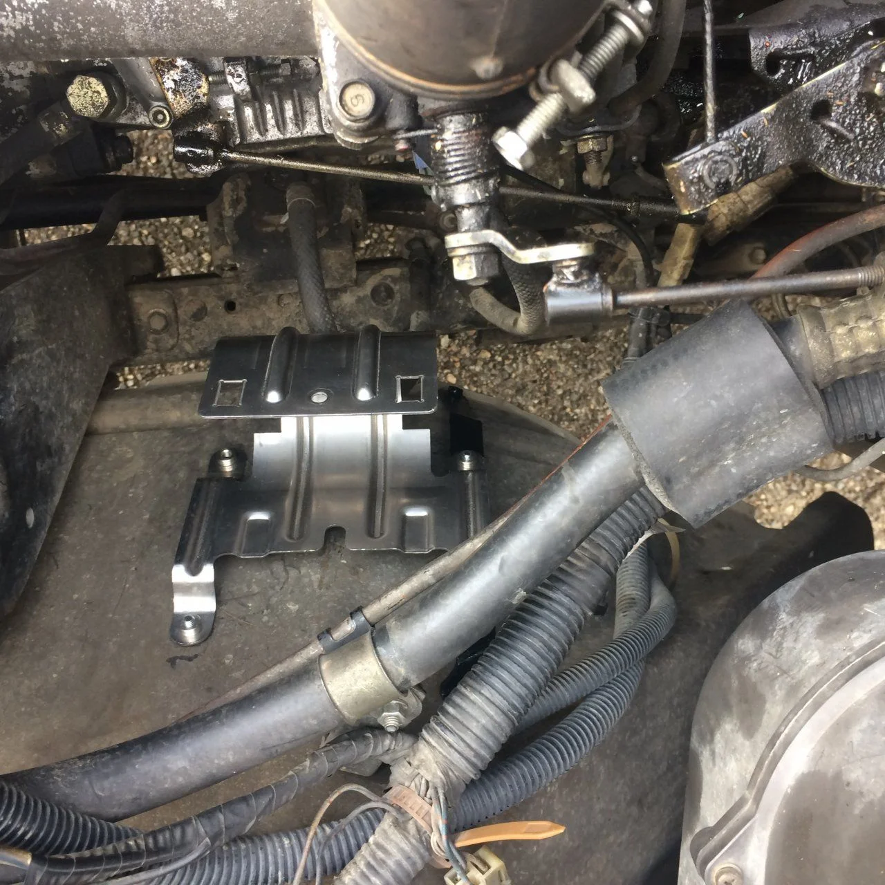

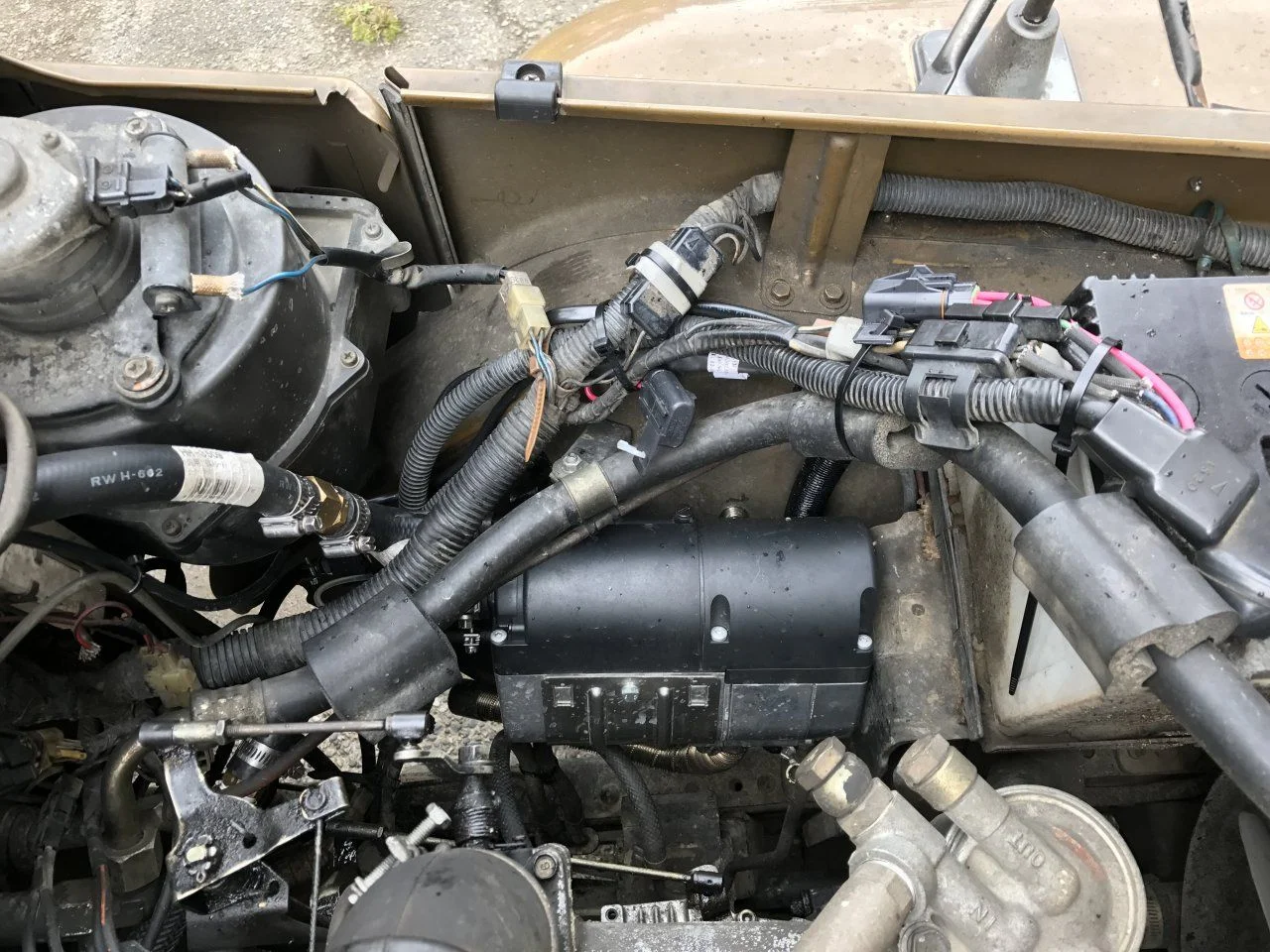

The first issue to deal with was trying to figure out how I was going to interface with the cooling system. Originally I thought I might install it under the air cleaner on the right side inner fender. But I wanted to go to the heater first and then to the engine so ultimately I put on the left inner fender. I also thought this is a better choice because it would be easier to install power steering as well as the turbo I have on the shelf.

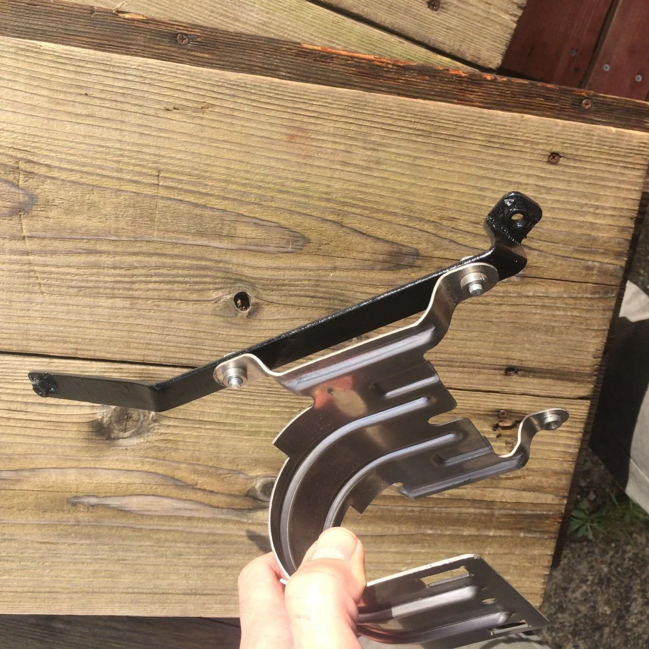

First up was getting the bracket fit up to the fender. The first thing I did was add press in nuts to the bracket and then I fabricated and additional bracket to fit it to the fender. The 4th photo shows the for bolts where they ended up in the wheel well.
Here's a shot of the unit installed:
I thought about running exhaust over to heat up the oil pan but I didn't want to have it vulnerable in anyway to snow and branches and other stuff that gets packed up under the engine from time to time so I kept it short and sweet.
The intake hose took up nicely alongside the battery and draws air from the front corner of the apron.

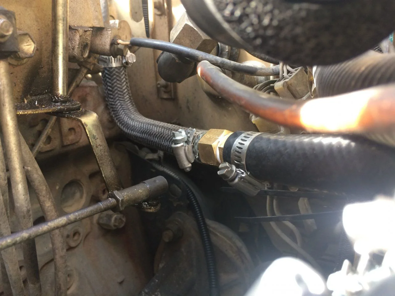

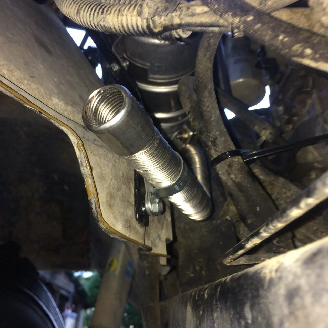

The inlet and outlet on the Espar are 20mm and the lines on the truck are 16mm so two adapters are required. I simply took the fitting on the block and rotated 180° to face down words to feed the Espar. For the section I used a 16mm elbow and a 20 mm 45° hose.
To go from the Espar to the heater valve are used a 20 mm elbow and section of standard 16mm heater hose.

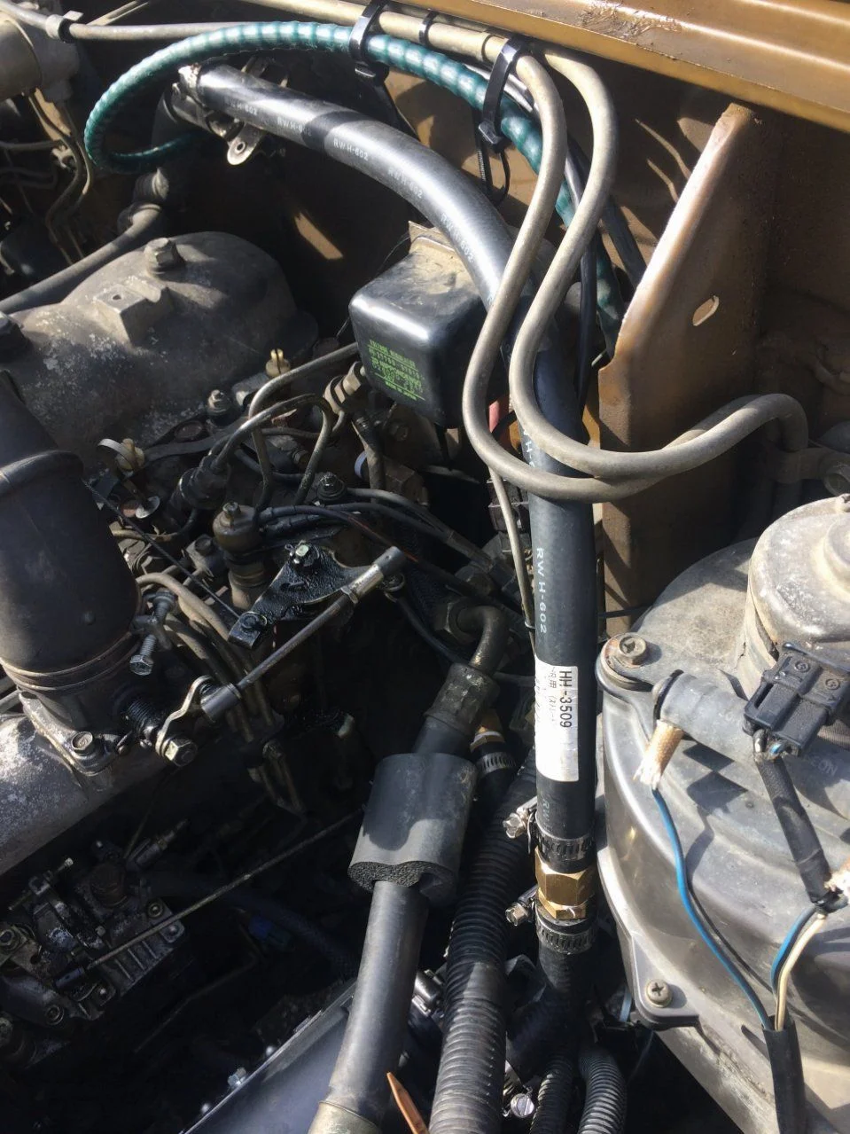

I tapped the fuel line with a 8x8x5mm T just after the sedimentator. I had read here on the forum that it was absolutely necessary to draw directly from the tank however the documentation show the tapping the fuel line was acceptable method.
It's pretty cute little fuel pump that comes with the kit. In fact the kit overall was pretty impressive.

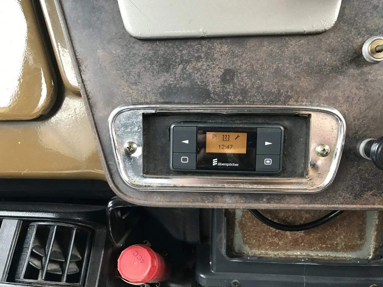

I also purchased a seven day timer to run the unit however I didn't want to see the modern electronics in the cab. The timer is great. They let you set three program schedules. Monday through Friday, Monday through Saturday, or any single day of the week. I have a scheduled to heat up my truck every weekday morning starting at 5:30 AM. Then comes on again every weekday afternoon at 3:30 PM. Of course you can turn on and off at will as well. In the winter months I turn it on every time I get in the car and basically it provides instant heat from the heater in the cabin. I freaking love it! This is by far one of the best modifications i've done to the truck in terms of making more pleasurable to use.

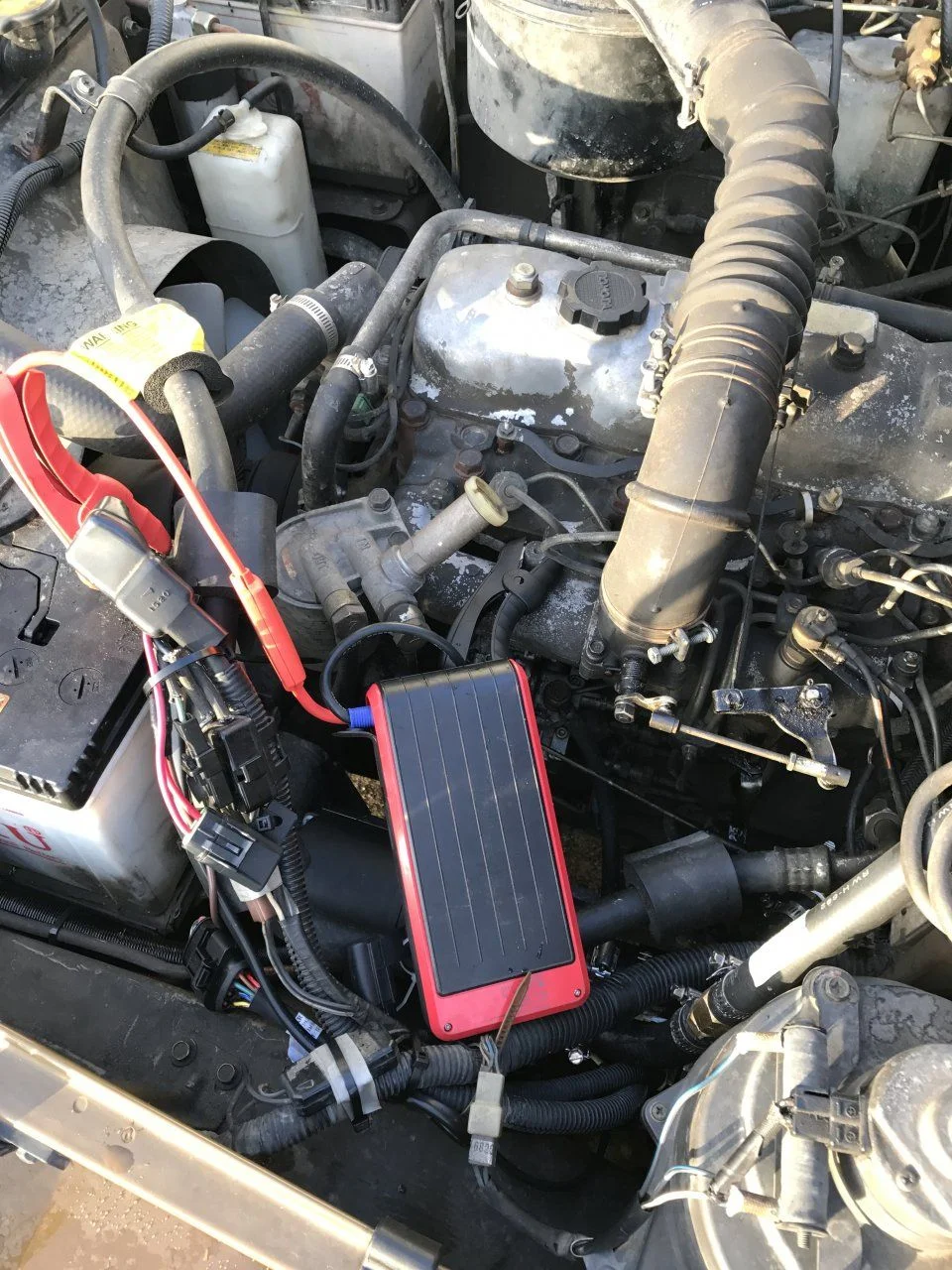

Well I would come out in the morning And the heater was not despite the fact that I had programmed it The heater automatically shuts down at a pre-programmed voltage. I programmed it for 20 V and what was happening was that the batteries just weren't able to keep up. They were showing their age. In fact I stranded myself several times and had to try out my power all goliath 24 V lithium jump start battery. I must say I'm very impressed with this little item. I bought it just in case I got off of the woods by myself and did something stupid like left the lights on. I've been will jump the truck three times without recharging the Powerall.

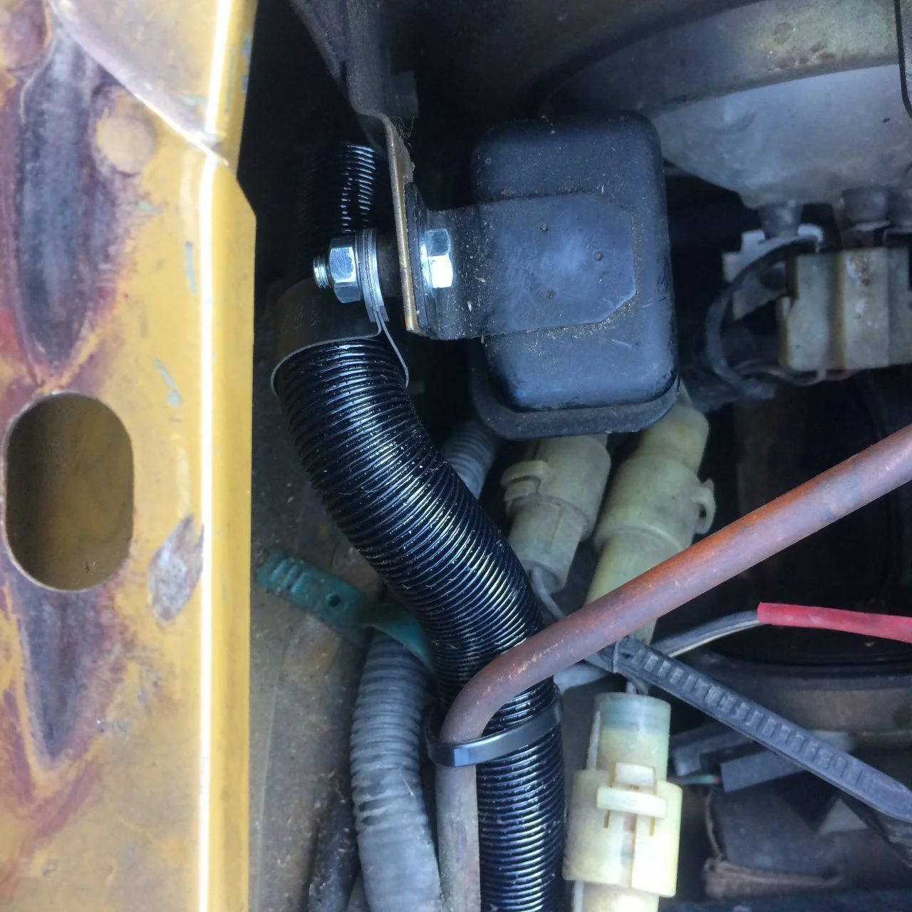

The only thing left to do to complete the install of the Espar is to add a relay to automatically start the fan blower in the cabin. The Espar has a circuit that will switch on when the coolant reaches 30°C. I'll run that switch to a relay that will turn on the blower motor. And that will mean that every morning when I get up and climb in my truck it will be super toasty and I'll be very happy.

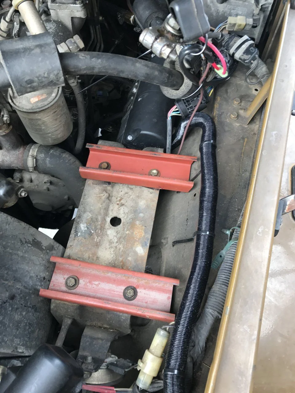

So I wanted to get as many amp hours as possible while simultaneously grouping both of the batteries over the left side. This will leave room for me on the right side to install my 24v compressor that I picked up cheap on auction where the second battery was. I love to drop pressure in the tires when I go off road but usually I don't simply because it's a good drive to the nearest gas station to pump tires back up again. Hopefully I'll be solving a problem in the near future.
Anyway for now these two batteries were absolutely the largest two batteries with the highest capacity they can fit together on the left side in the engine compartment. They measure 195 mm in width and combined 340 mm in length. Each is rated for 540 Cca and 42Ah.
I started off like this:
I
And this is how far I got towards the end of the day today:
It just just just fits.
