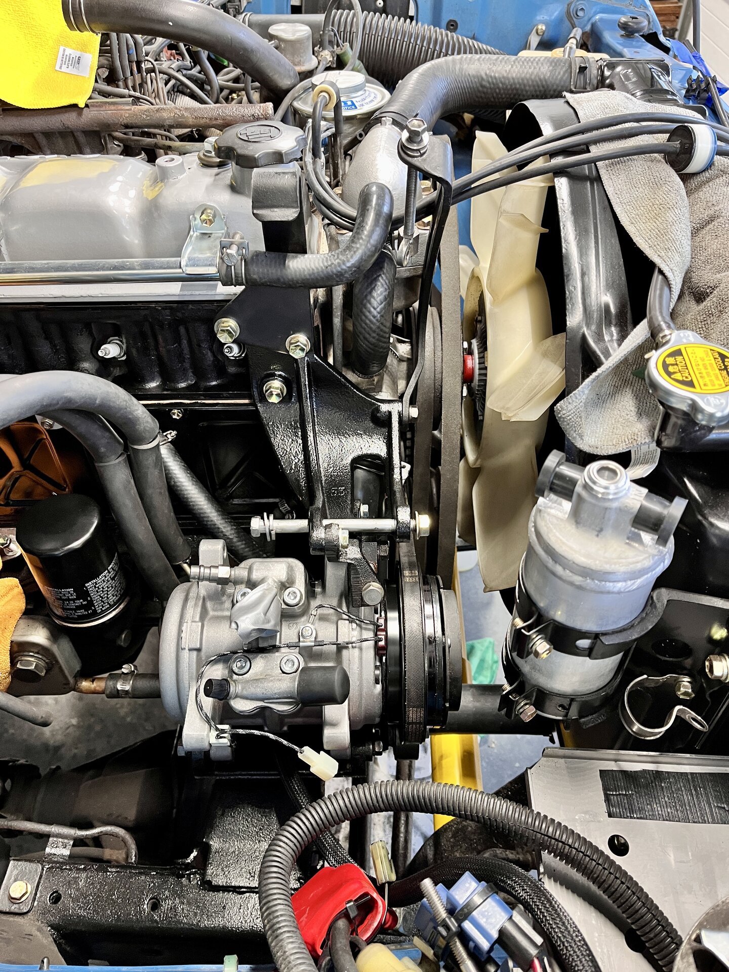

Is there any point in using the recharge refrigerant that has the stop leak additive?
Is 8-10 months too fast compared to other user's experience? Maybe I need to have an A/C guy find and repair the leak?
My A/C was converted to R134 early 2022. By November (maybe 8-10 months later), the refrigerant had leaked down enough to stop working due to low pressure. I refilled tonight, once I realized the pressure circuit was open, and it's working well. I read in another thread that leak down is fairly common converting R12 to R134 due to the smaller R134 molecule.

Yeah, it's a very fast leak. Was almost completely gone by the time I drove it again. I am going to replace all the o-rings and the drier. I am guessing at this point it has to be evacuated before recharging. I am trying to decide if I get something like the harbor freight vacuum pump (air supply separate) or if I should take to A/C shop. If my efforts with the o-rings (and valve replacement) don't fix the leak, then money at shop is wasted. If I recharge with moisture in the system, is there any chance something will get broken?

I recharged with dye this time. Every serviceable connection is leaking and the compressor is too, darn it. I am buying a rebuilt compressor from JT Outfitters. How hard is it to rebuild these compressors?
