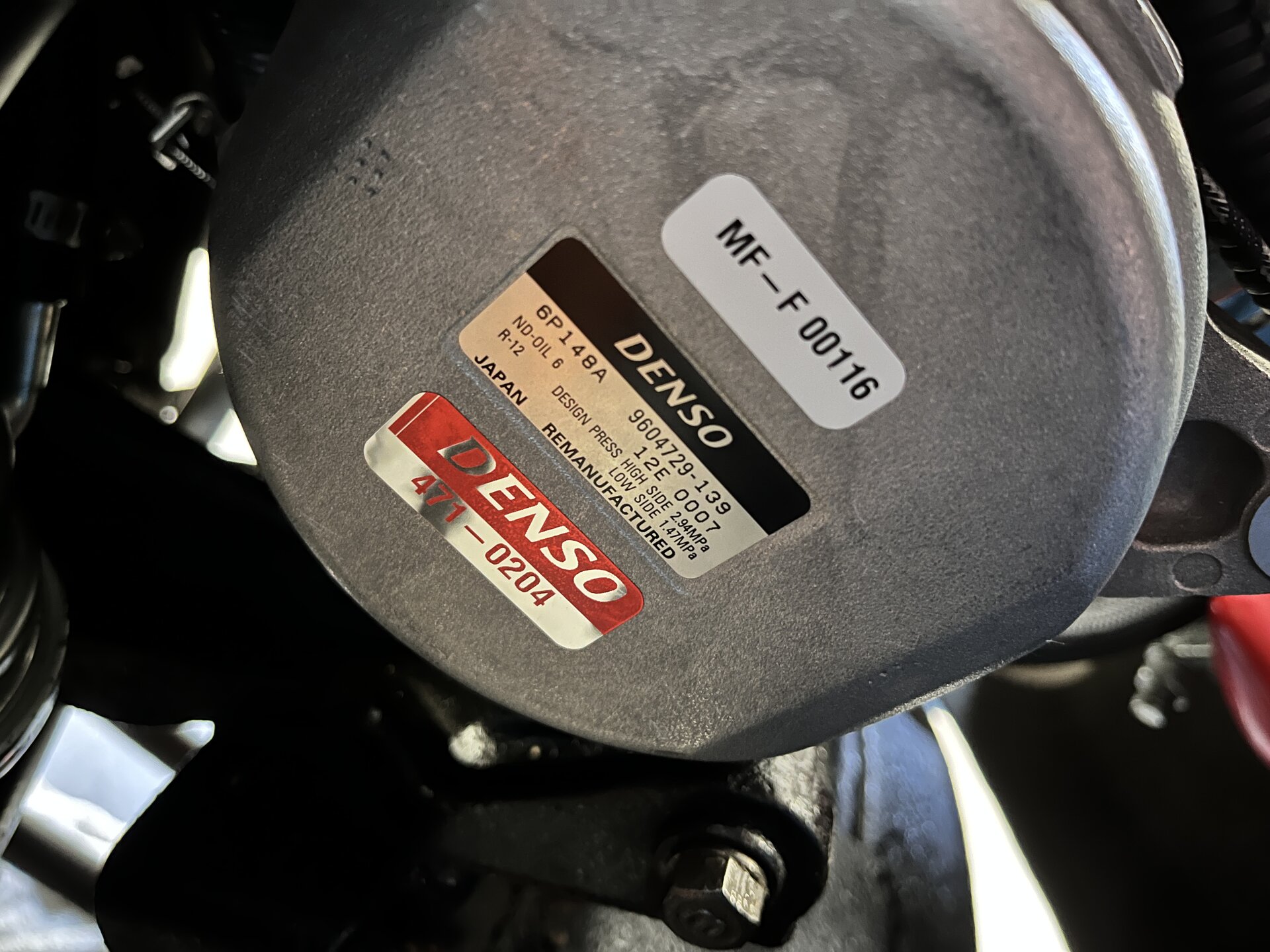

I had also read somewhere that later compressor brackets are different, but the 471-0204 fit beautifully in my '83. Amazon said it would fit so I was not worried. ;)

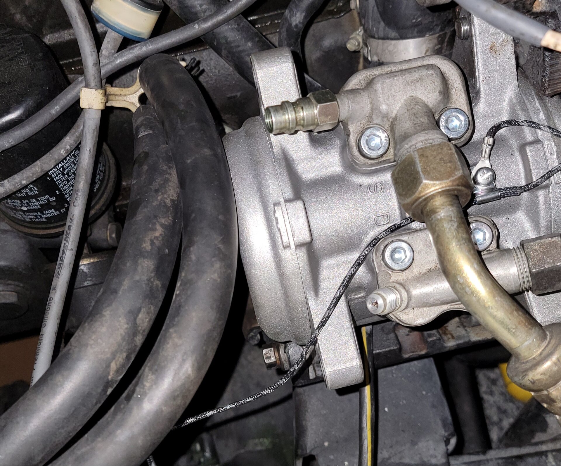

I bought the manifold gauge set from harbor freight and their venturi vacuum pump. My ac compressor only has a quick disconnect on the low side. It's a threaded connector on the high side (see picture). I connected the manifold set by using the quick connect to low, and threaded onto high. Not sure that is going to work. The low side seemed loose, and I don't think threading on the connector can actuate the schrader valve on the high side.
The low side port already has an adapter fitting on it. The high side is still the original R12 connection.
If the low side has a loose fit unscrew the adapter and put on another.
There are various adapters out there. Long, short, angled, etc. Some of the adapters have a Schrader valve that works alone. You pull the old one out of the old R12 port. BUT......some need the old one left in the R12 port and the adapter is setup to push it so just pay attention to the type you get.
If you can't get any of the charge port adapters to work for you, you can always have an A/C or hose shop put a charge port in your hoses. Anywhere that's easy for you to get to.
