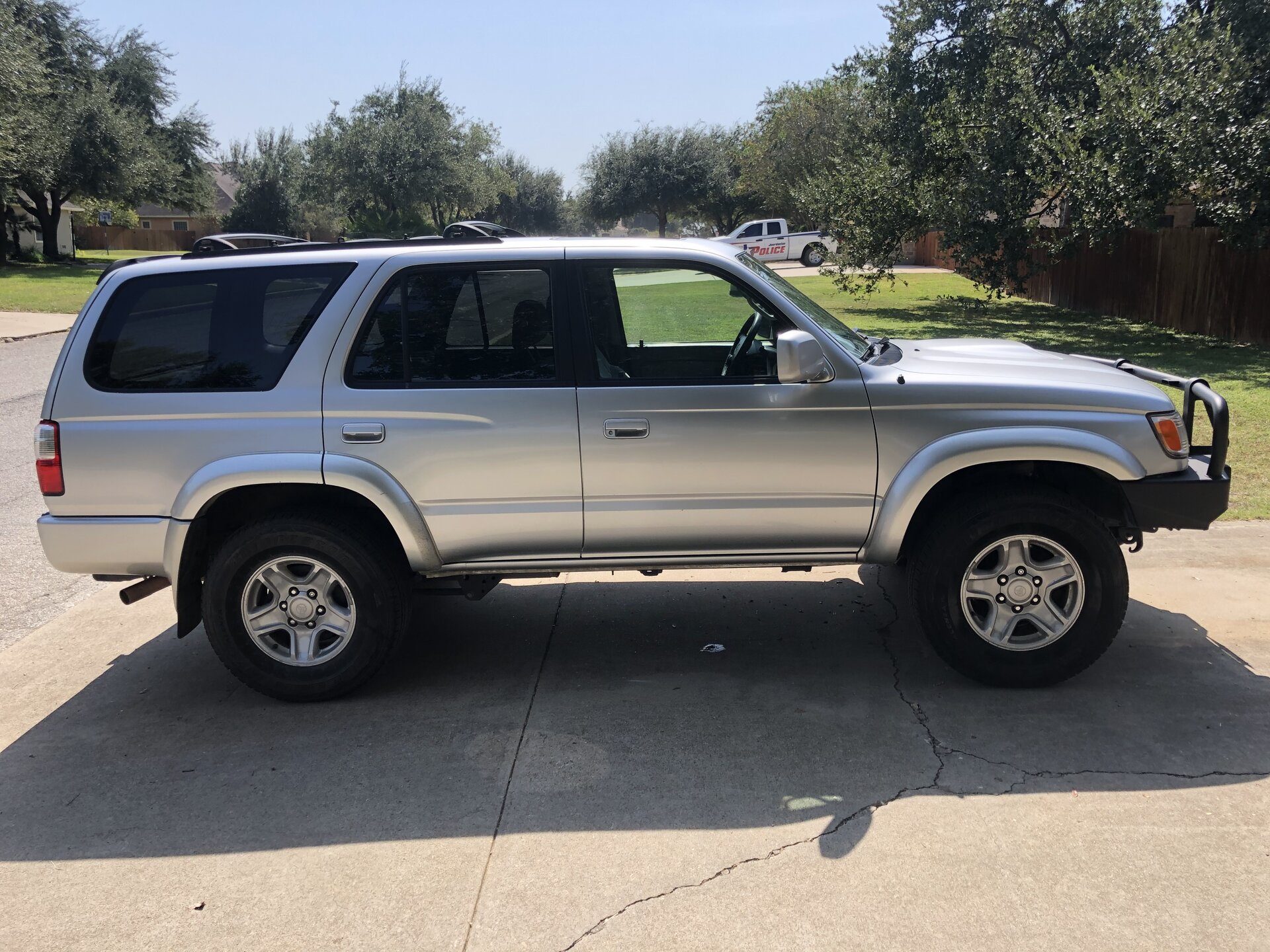

I can second that. 3rd Gen 4 runners are fun and have a good power to weight ratio. They’re also easy to work on (all the Toyota SUV’s are actually). Maintenance may be less expensive too. The Achilles Heal is the “milkshake” when the radiator fail’s internally, mixes coolant and trans fluid, and then kills your trans.
I miss that thing.

The third gen 4Runner is about the same size as a 80 but lacks a solid front axle 😉
I think the 3rd gen is about 5" narrower. I could be off though. There are a lot of upgrades to the ifs available. Since it has a taco front end a solid axle swap is also a pretty easy addition. I think the rear overhang is less too. Ive had a couple 3rd gens, the size difference was noticeable to me. I realize the 100 is bigger, but the v8 I think would make it more useful for hauling stuff. The 4th and 5th gen 4runner is almost exactly as big as an 80 afaik.

3rd gen 4Runner is definitely smaller than the 80 series. It's a great car. I thought it's Achille's heel was the lower balljoints. Terrible design, although for most people not a big deal. Hadn't heard of the radiator milkshake issue. Another reason to buy a manual (if you can find one!).
