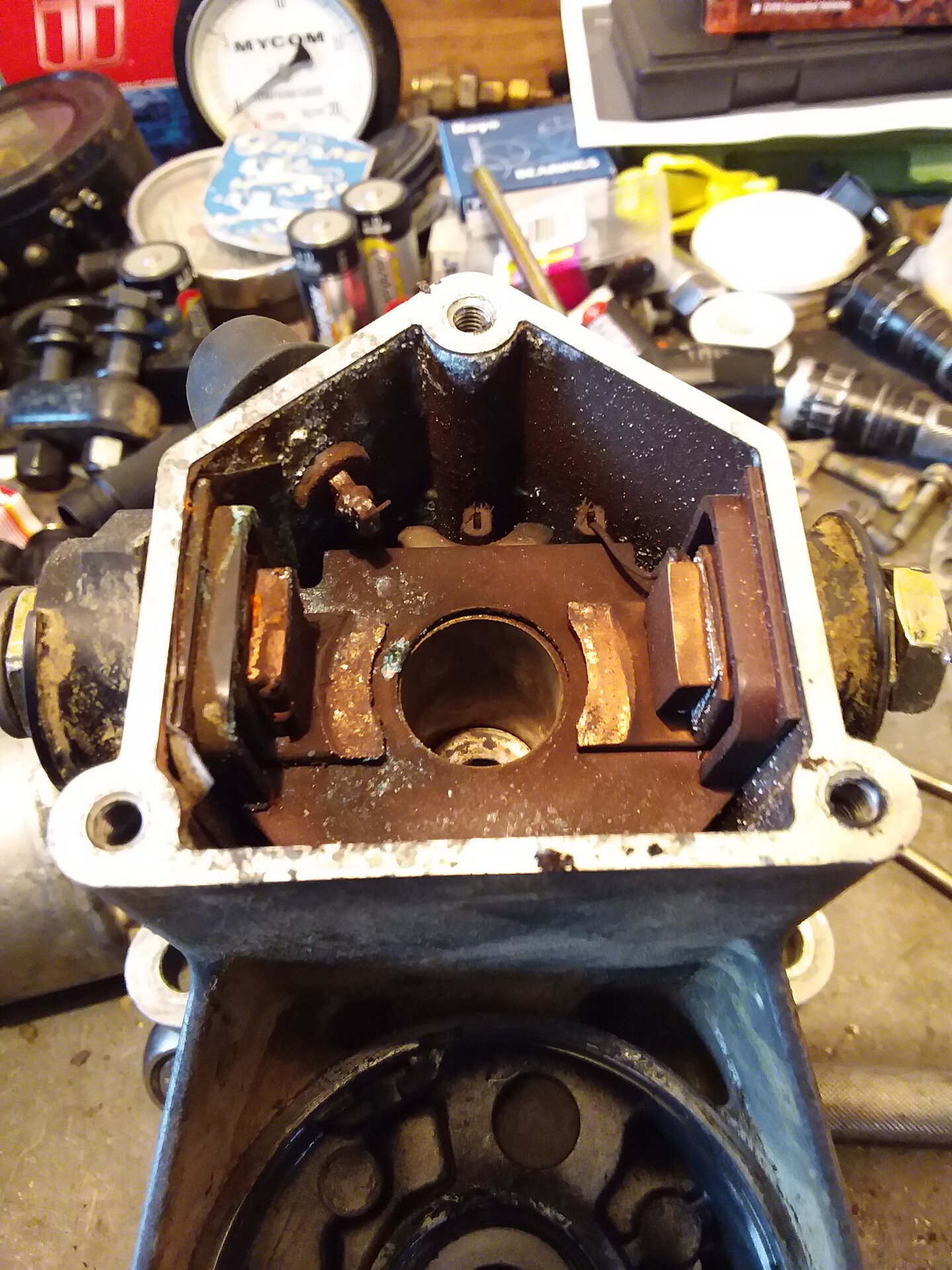

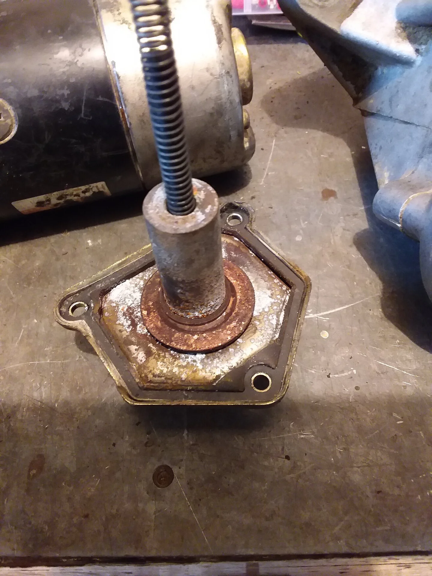

Tried to start using the piece of wire but no luck. Ended up removing starter motor and found heaps of rust and corrosion in solenoid. Probably due to all the river crossings over the last 10 years. Have ordered new Taiwanese starter motor
