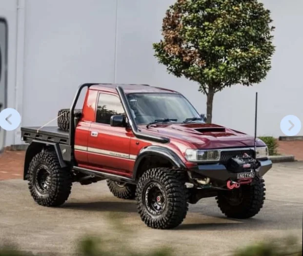

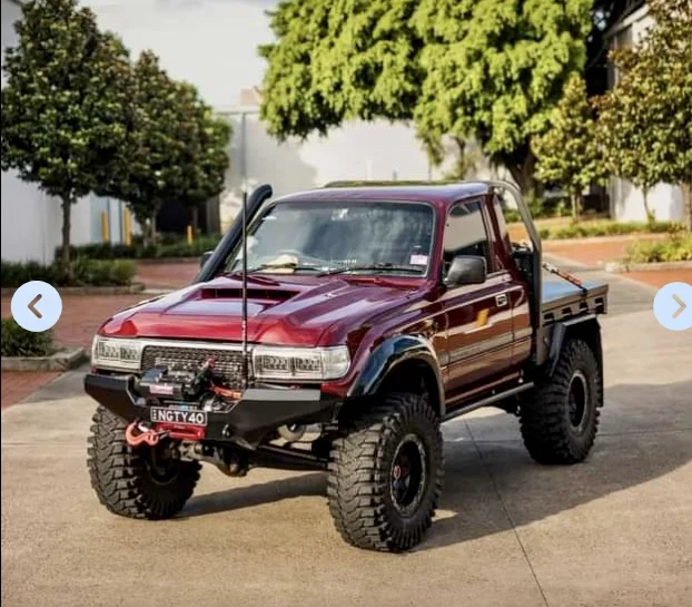

Lets add some pics of this one since it is pretty sweet. It is stock 80 wheelbase (112”) but I think with 6” more it would look perfect and work better as a Ute.
Cheers
That one looks nicely done for sure.
I agree another 6" would give better balance and a more useful tray if your want to carry a load
That looks amazing and at the same time looks like an RC model. Probably just the pictures giving that affect.

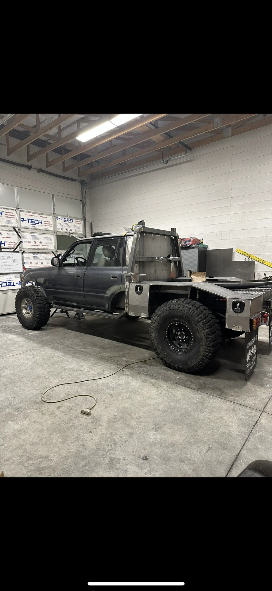

It's along the lines of what I was day dreaming of a few years back l. 4 linked rears, long radius arm front, extended wheel base, auxiliary transmission. Dual cab 6x6.
Most 6x6 use some variation of load sharing springs/bogie axles like a heavy truck.
I think with independently 4 linked axles you can potentially see some crazy driveline angles between rear diffs.
Situations like ramping over a mound or ledge, or dropping into a creek or washout you can have a situation where one rear axle is fully stuffed, the other in full droop. With 15" shock travel, vertical relationship between pinions at the back can change by 15"
Add some articulation and rear steer from independent 4 links that are articulated in opposite directions, I think you need some stout CV joints with a high range of drive line angle, and a long slip yolk.

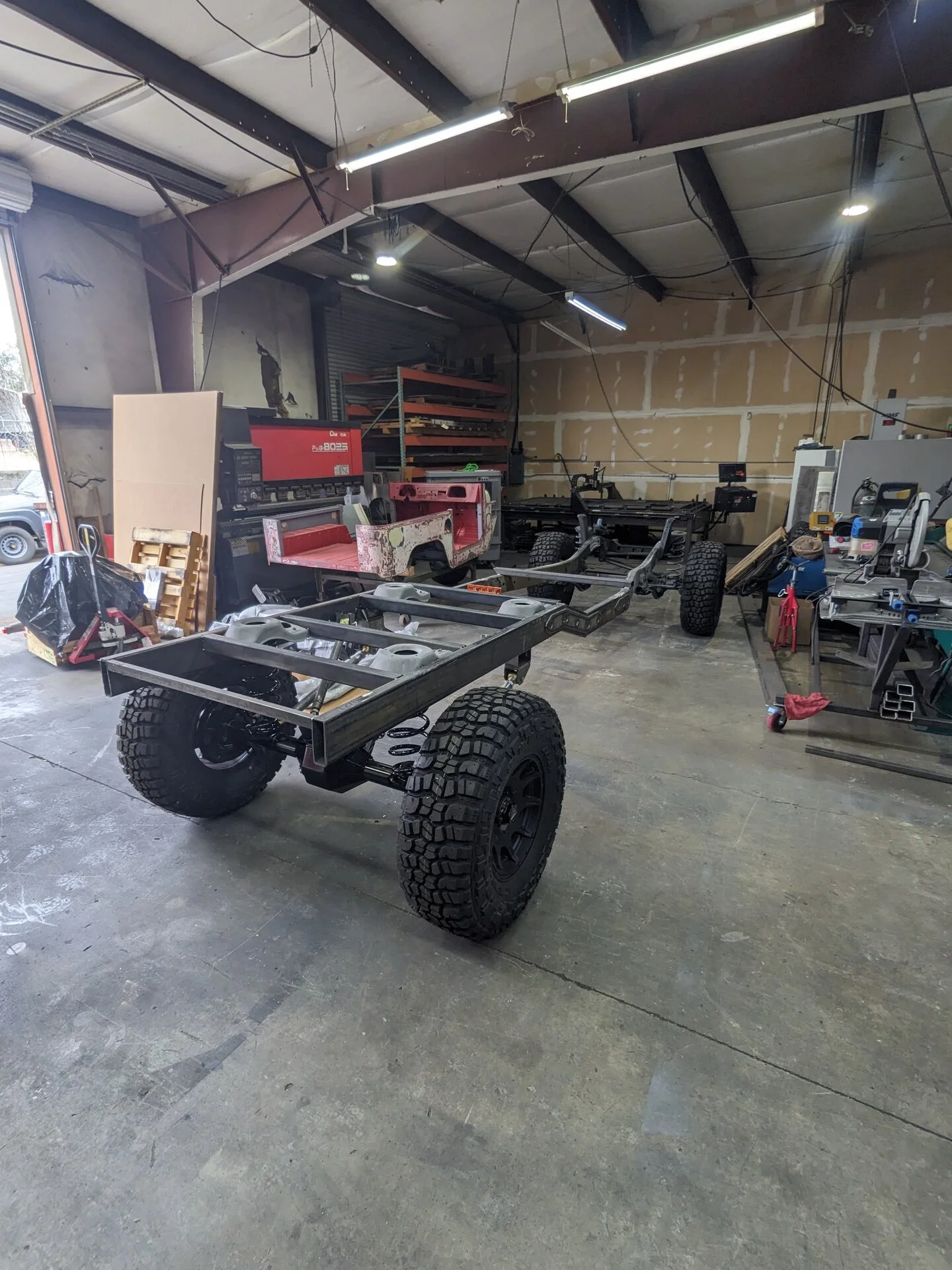

Waiting on the Front/Rear pass through axle now. So off the rack and on to other projects now.

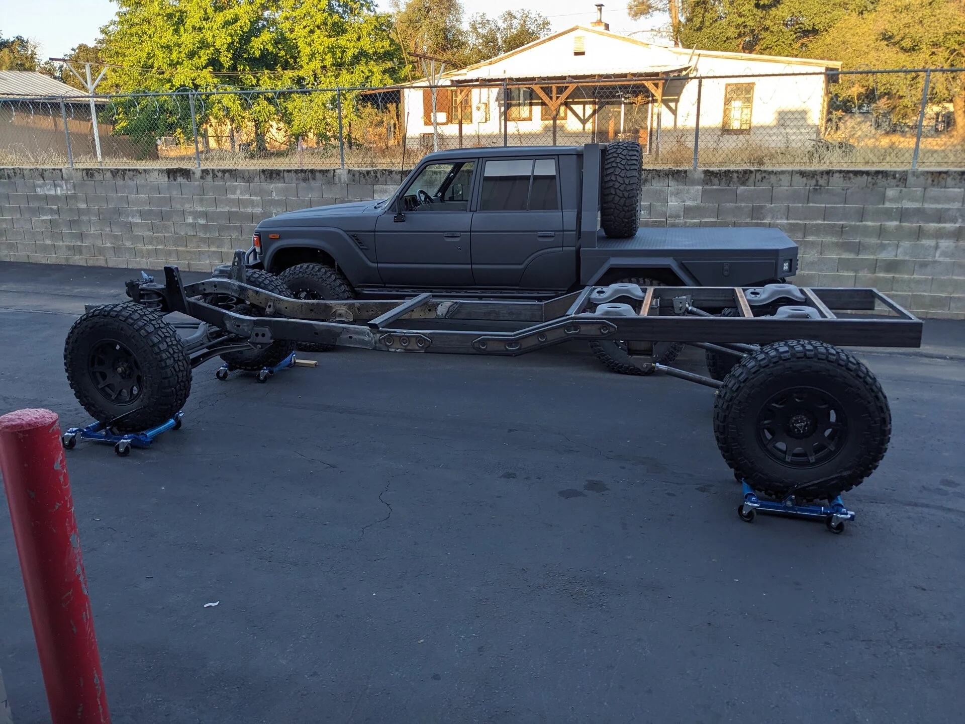

Thanks! 12v Cummins, zf6, np205,3 link front, 4 link rear, 14” coil overs, f550 axles, custom frame and 120 gallons of diesel onboard to get me to Argentina!
Whoa… you’re set. lol. I thought the stretch would be a perfect time to go to a Dana 60 out back. Evidently I thought too timidly. 😂
