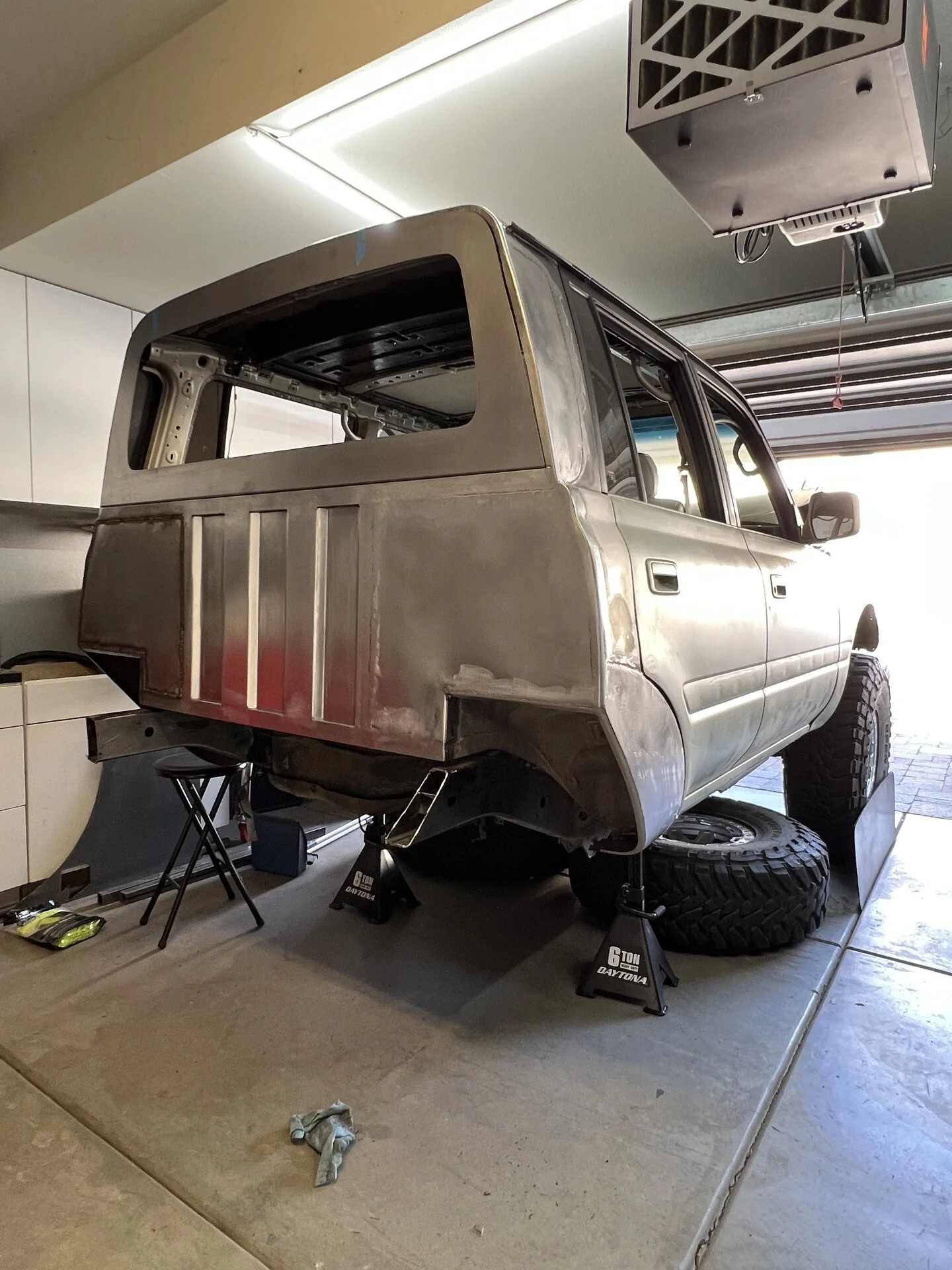

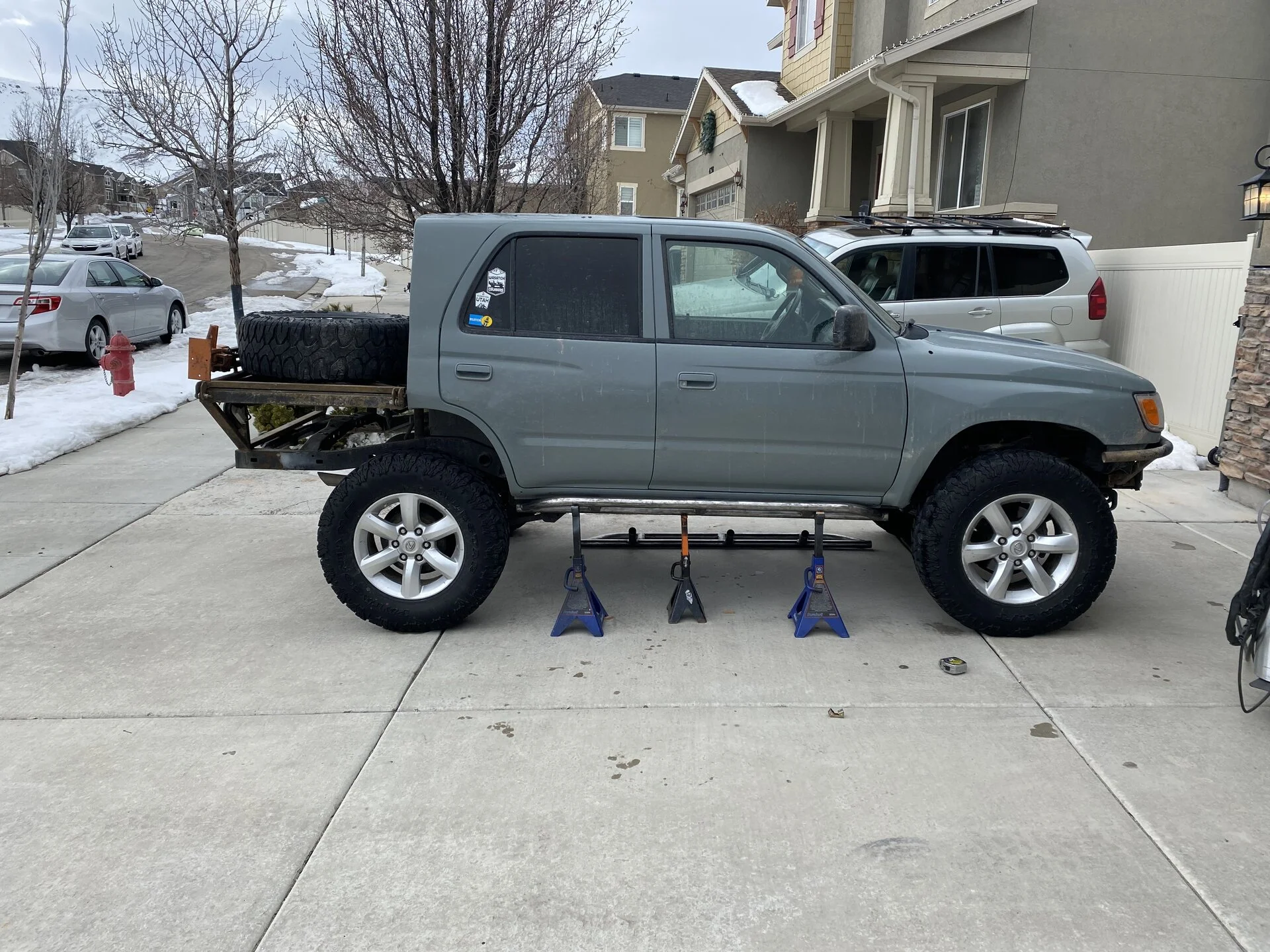

I chopped my 80 a year ago and it’s been sitting in my garage idle, up until a month ago. Took some time off work to get it completed.
Lots of hate from the idea but I’m building the rig for my own personal enjoyment and seeing how far my skills can take me.
You guys can follow along on my IG:
Jameson (@ronin_metalworks) • Instagram photos and videos - https://instagram.com/ronin_metalworks?igshid=MmIzYWVlNDQ5Yg==
Current state: (also, don’t mind the frame. It was hacked off without any sort of precision, just so it wasn’t in the way of the body. New frame rails/extension are already made)

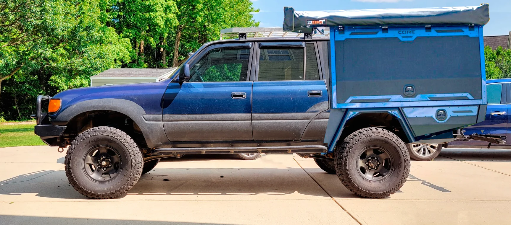

Looking great! Here is the one I’m building. I have a 148” wheelbase with a 6.5’ flatbed and 40’s. If you need frame rail I used 1/8” 6x3 A500 structural tube and it grafted on nicely right where the transmission crossmember bolts to.
@RoninMetal did you make that rear wall/bulkhead, or is that a kit?

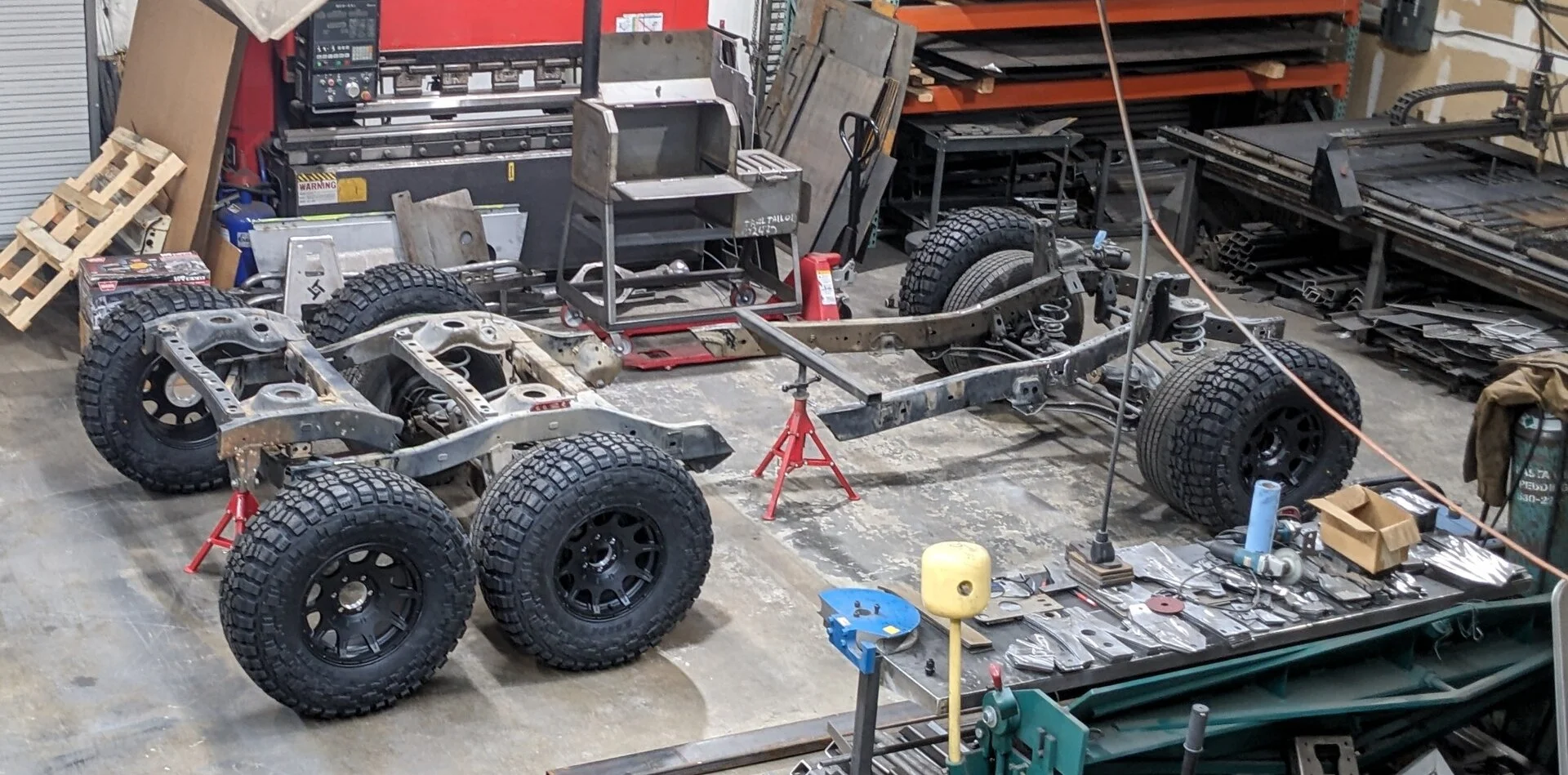

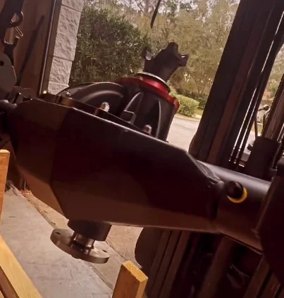

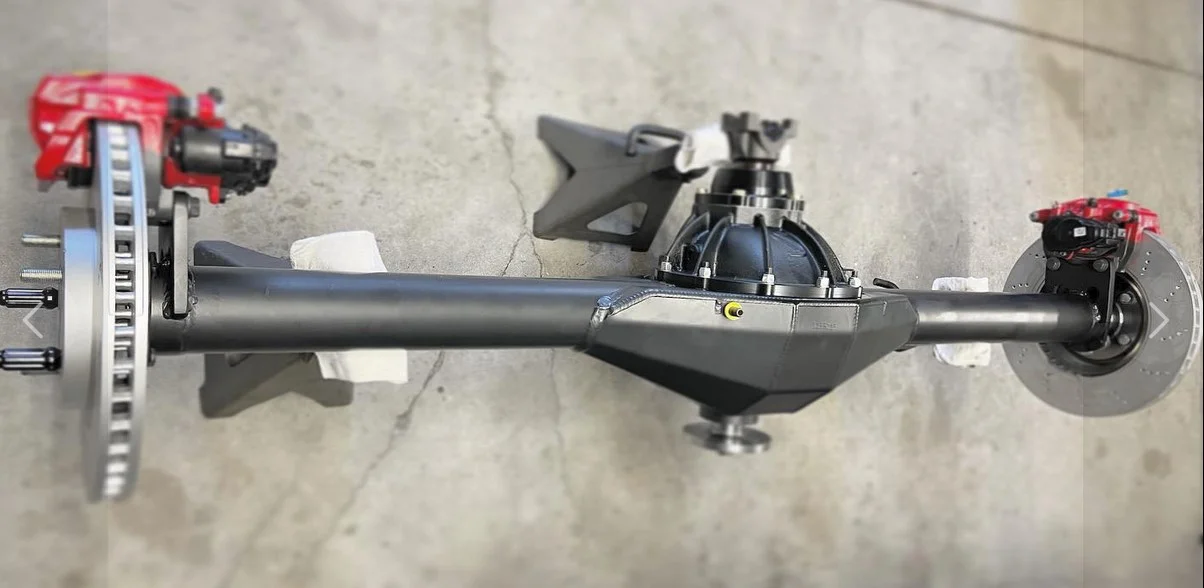

Both rear axles are driven. Making a passthrough pinion setup.
Rear back axle is E-Locked
Front back axle is Tru-Trac posi to allow for slight slip and allow for straighter driving and easier on the differential. Front back axle is a Ford 9" with a 35 spline pinion and axles alike. 300M material. Ring and pinion is custom made and just under 10".
4.10 gears
With the triangulated set up and longer arms I should get a bit more flex than most have in the past. Will have 15" of shock piston travel
Most of my builds are for overlanding. My rock crawl days are few and far between anymore.
4.10 gears

It's along the lines of what I was day dreaming of a few years back l. 4 linked rears, long radius arm front, extended wheel base, auxiliary transmission. Dual cab 6x6.
Most 6x6 use some variation of load sharing springs/bogie axles like a heavy truck.
I think with independently 4 linked axles you can potentially see some crazy driveline angles between rear diffs.
Situations like ramping over a mound or ledge, or dropping into a creek or washout you can have a situation where one rear axle is fully stuffed, the other in full droop. With 15" shock travel, vertical relationship between pinions at the back can change by 15"
Add some articulation and rear steer from independent 4 links that are articulated in opposite directions, I think you need some stout CV joints with a high range of drive line angle, and a long slip yolk.
I used to have a collection of videos and photos of various 6x6 in action. There's some interesting variations.
The ramp over thing brings them undone in a few ways. You can have a situation where you have no load, no traction on one rear axle (both tires). The tru-trac posi might be an Achilles heel in some scenarios.
There was an Aussie 6x6 conversion company that advertised a large amount of rear suspension travel, but if you looked closely all their pics highlighting suspension travel, trucks had no rear (diff-diff) driveshaft installed 🤣
