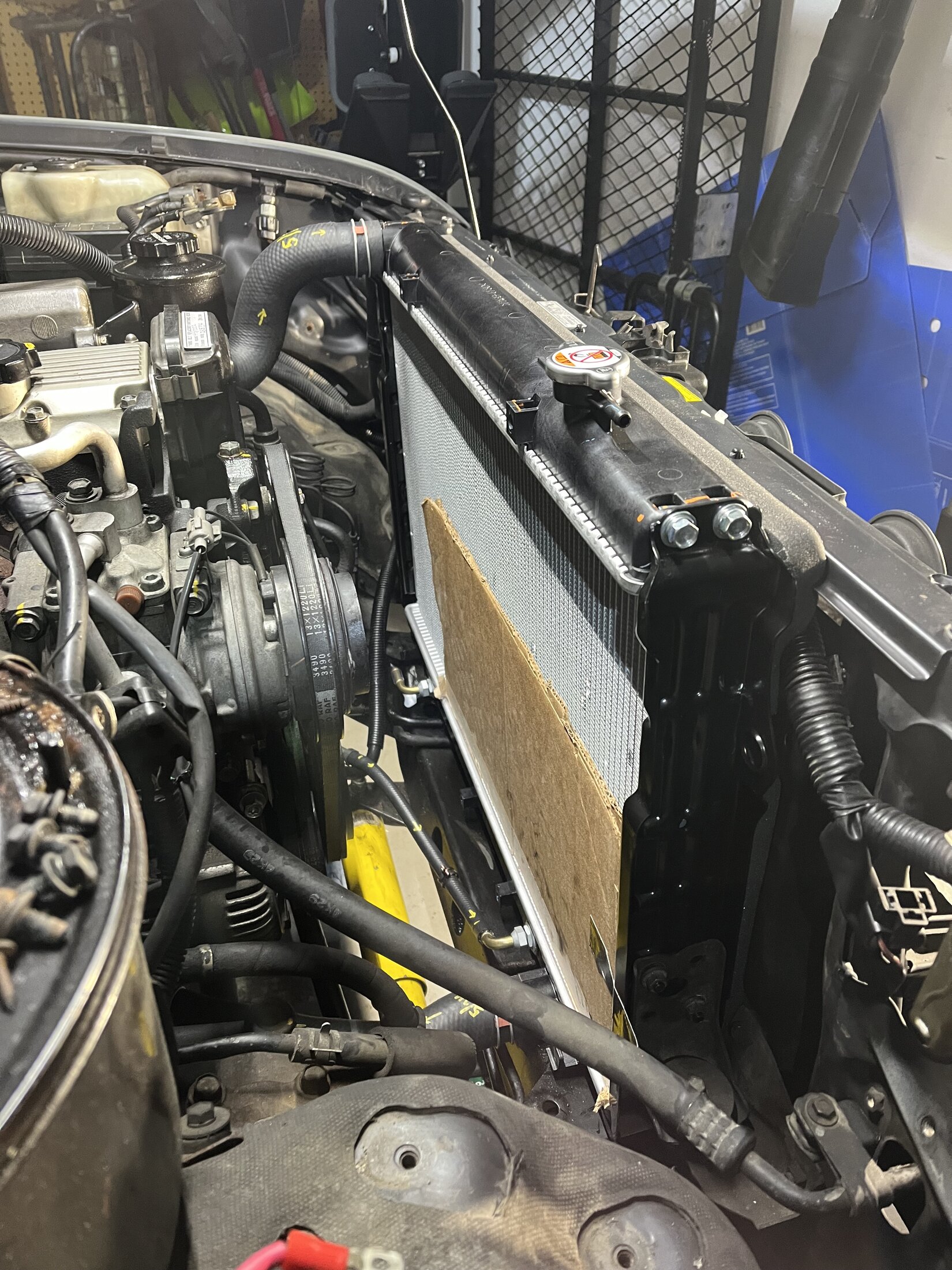

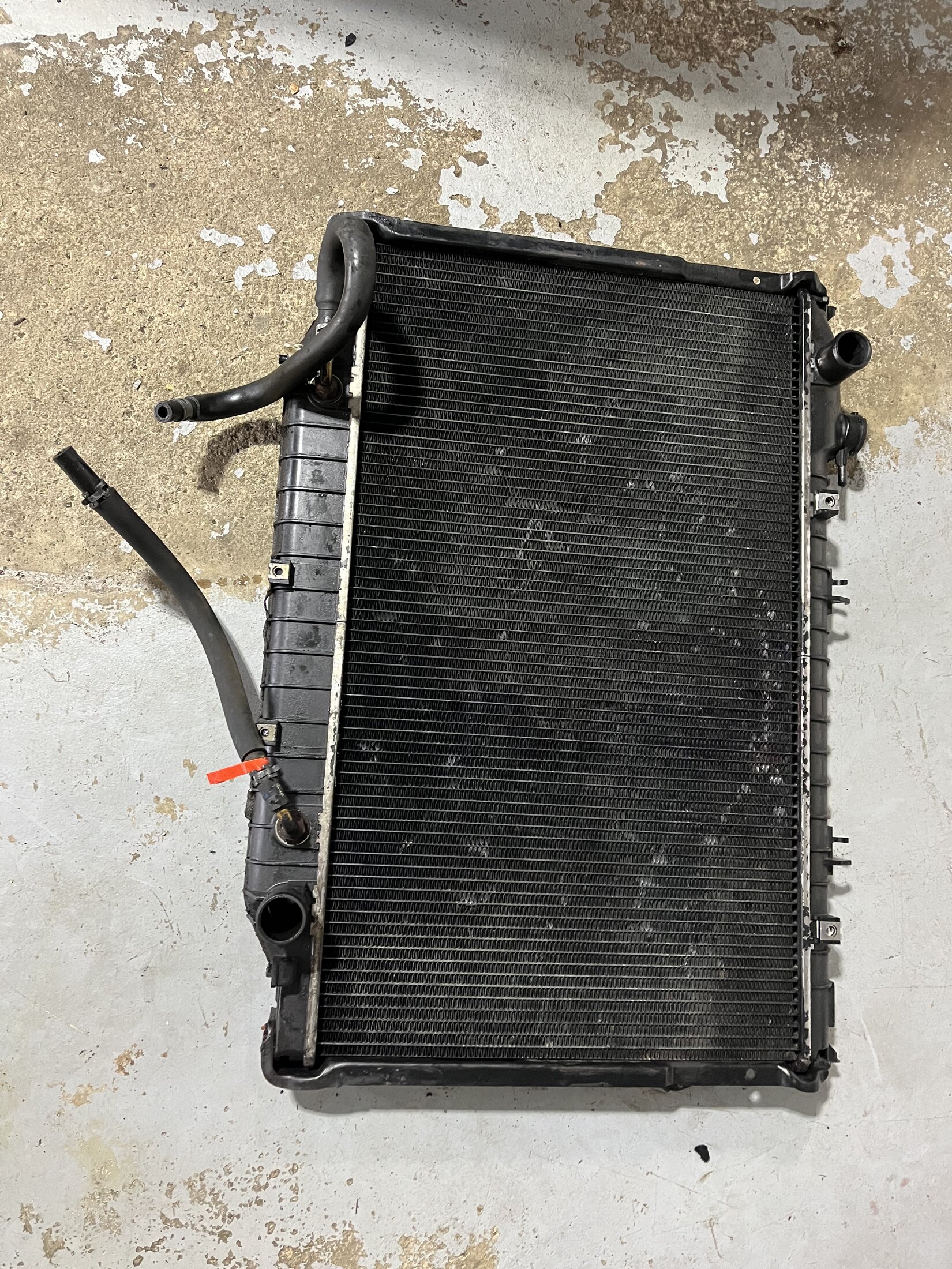

I just replaced my old radiator and installed an aftermarket tranny fluid cooler (wholesale automatics). I traced the lines from and to the transmission. In the picture, hot fluid enters on the left and cooled fluid exits on the right. In my case, the exit is connected to the aux tranny fluid cooler and then goes back to the transmission. I put some orange and blue tape on the lines further back, sorry I don’t have pictures of those lines. Hopefully the pictures help.
I tapped my transmission temp sender on the front of the oil pan closer to the dip stick. but the tranny output line prior to the radiator cooler should also work,,,
With a 1997 US spec FZJ80 with the A343F ATM there are two ATF coolant lines running along the left side of the block, the top hard coolant line is the one leaving the transmission going to the right side of the radiator, the bottom hard line is the return.
If you look at the bottom photo above you can see a soft cooler line (hose) running from the vehicles left to right (hose with small yellow arrows), that's the top line when looking at the two lines as they run together along the left side of the block. HTH's.
