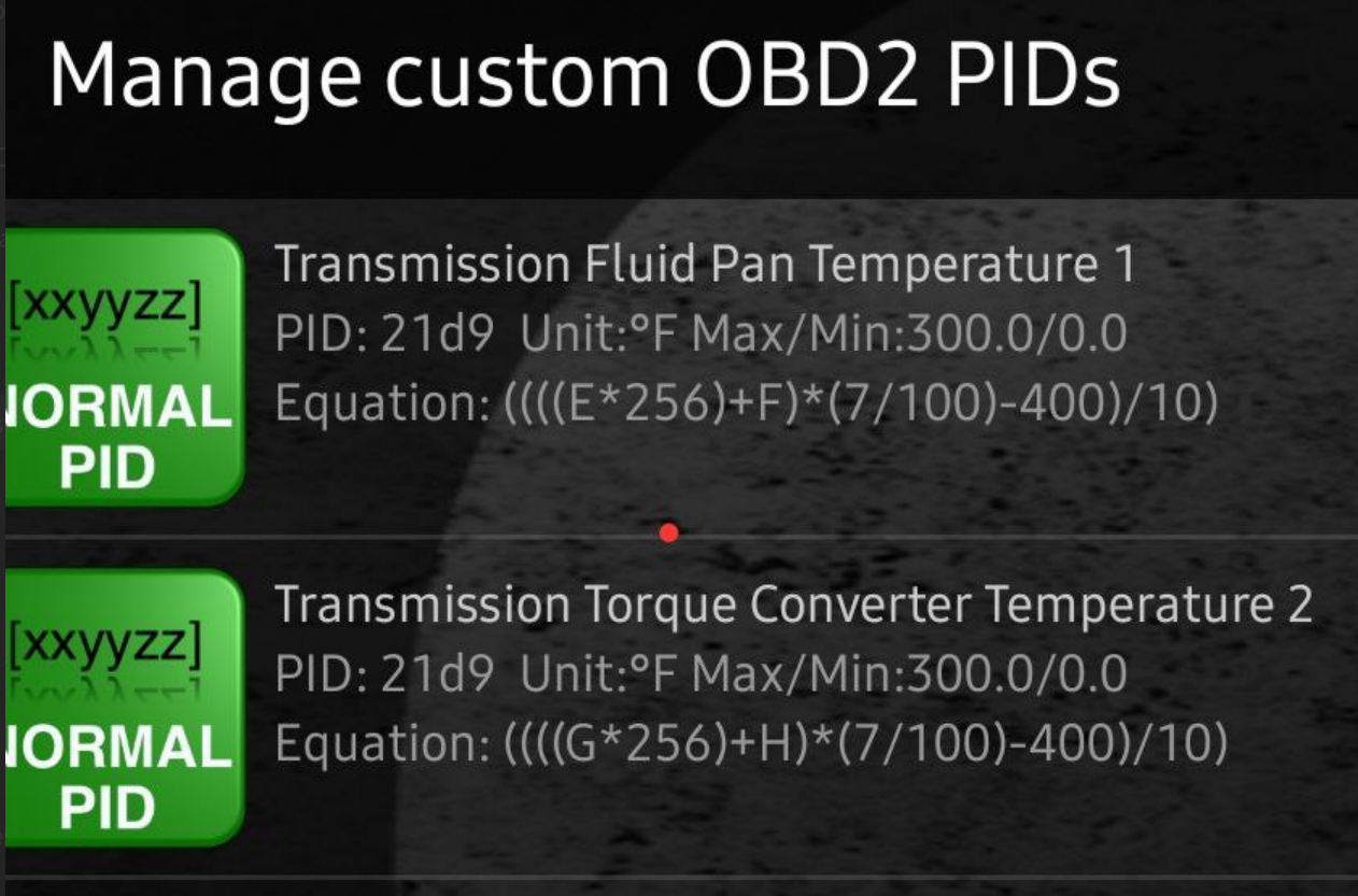

Anyways I have attached my Torque Pro Transmission PIDS here - Here is the formula if you just want to copy it.
Transmission torque pro pin For the first one.
21d9 for both
TRANS PAN Temp
((((E*256)+F)*(7/100)-400)/10)
2nd pid
TORQUE CONVERTER TEMP PID
((((G*256)+H)*(7/100)-400)/10)
These temp work perfectly good for my 2000 LC/LX as well as my 2007 Tundra.
21d9 for both
PAN Temp
2nd pid
TORQUE CONVERTER PID
Yeah, I copied those and tried them but neither worked for me. I put one in from a 4Runner and that seams to work. Maybe I will try those formula though. Thank you for the rapid response.
