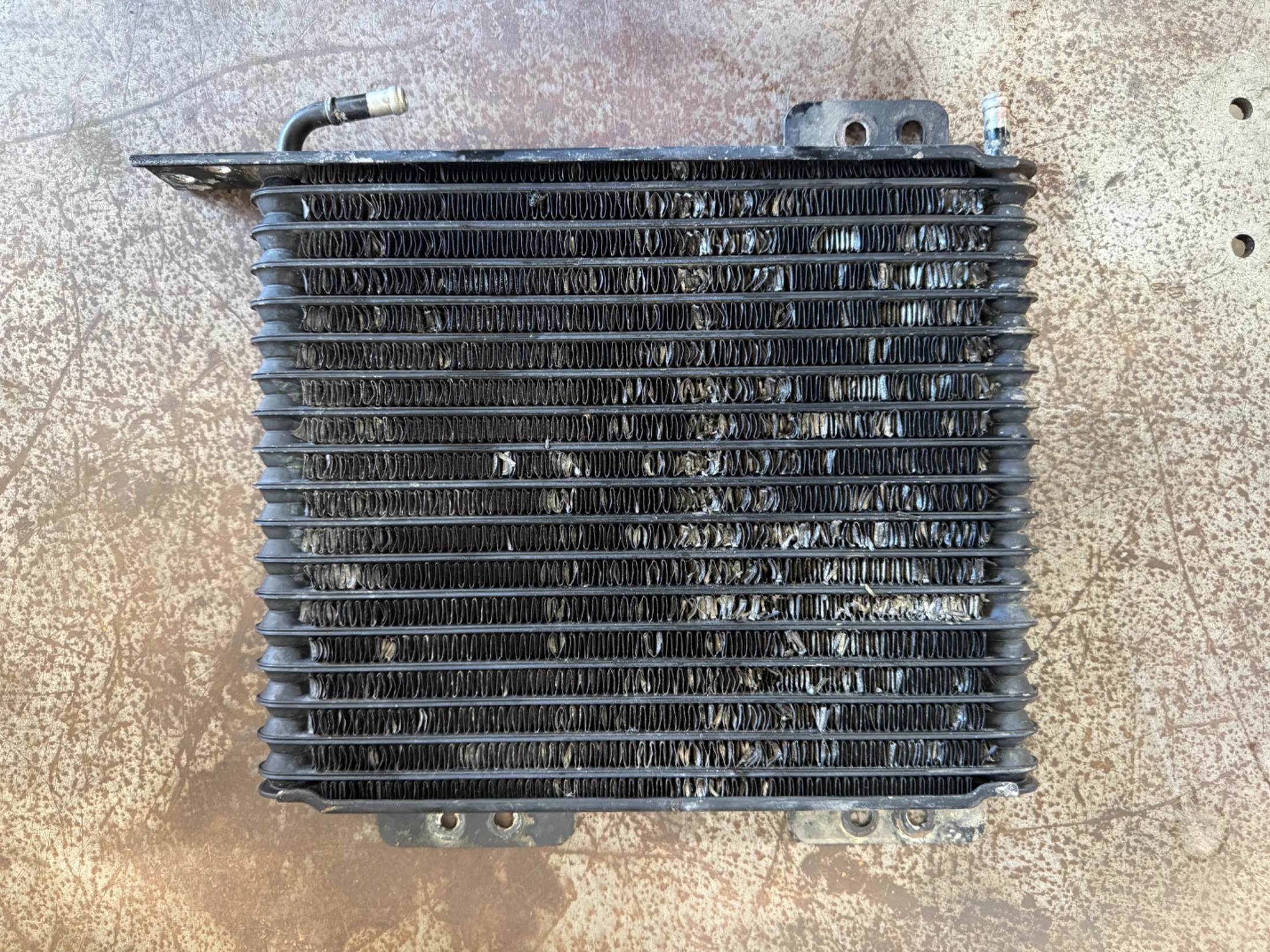

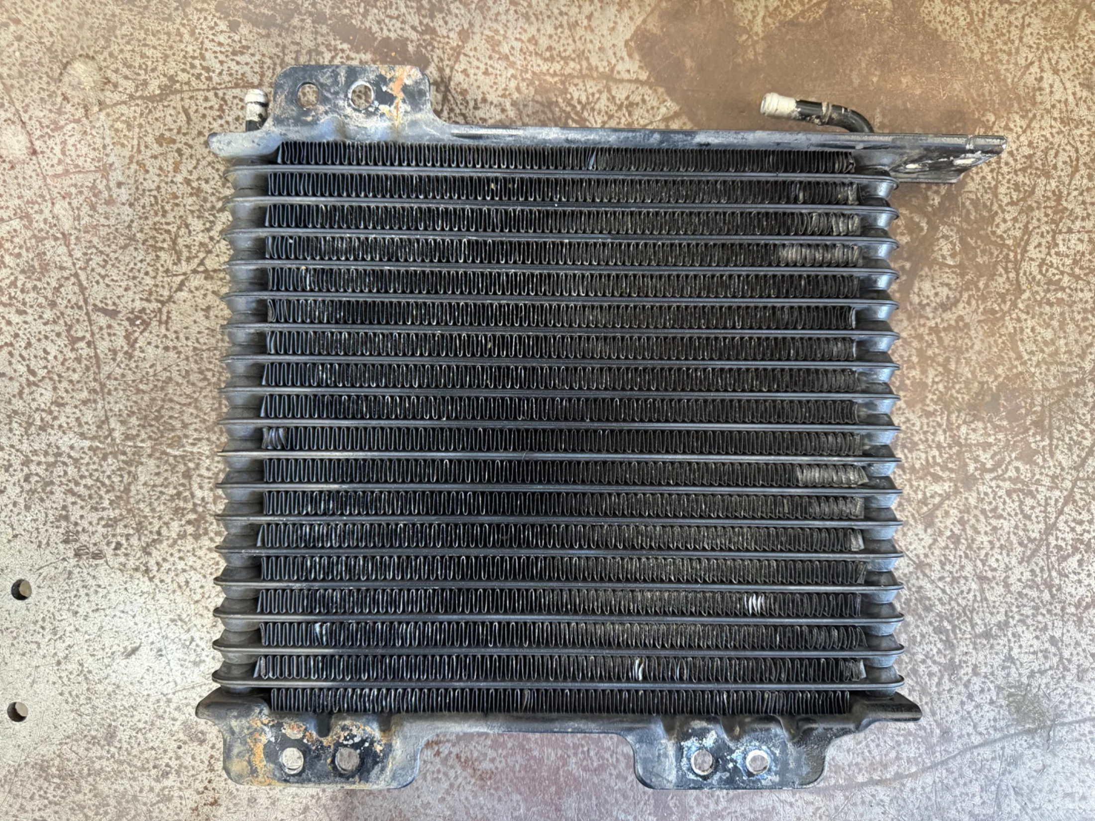

Is there any value to keeping my factory transmission cooler around? I'm upgrading to a 24 row Setrab unit.
Some of the front fins are soft, the rear fins seem fine.

Why? That's vrtually the exact same dimensions as the OEM cooler.
OEM cooler is only 17 rows.... size doesn't = cooling
The 34 row is literally twice the cooling surface

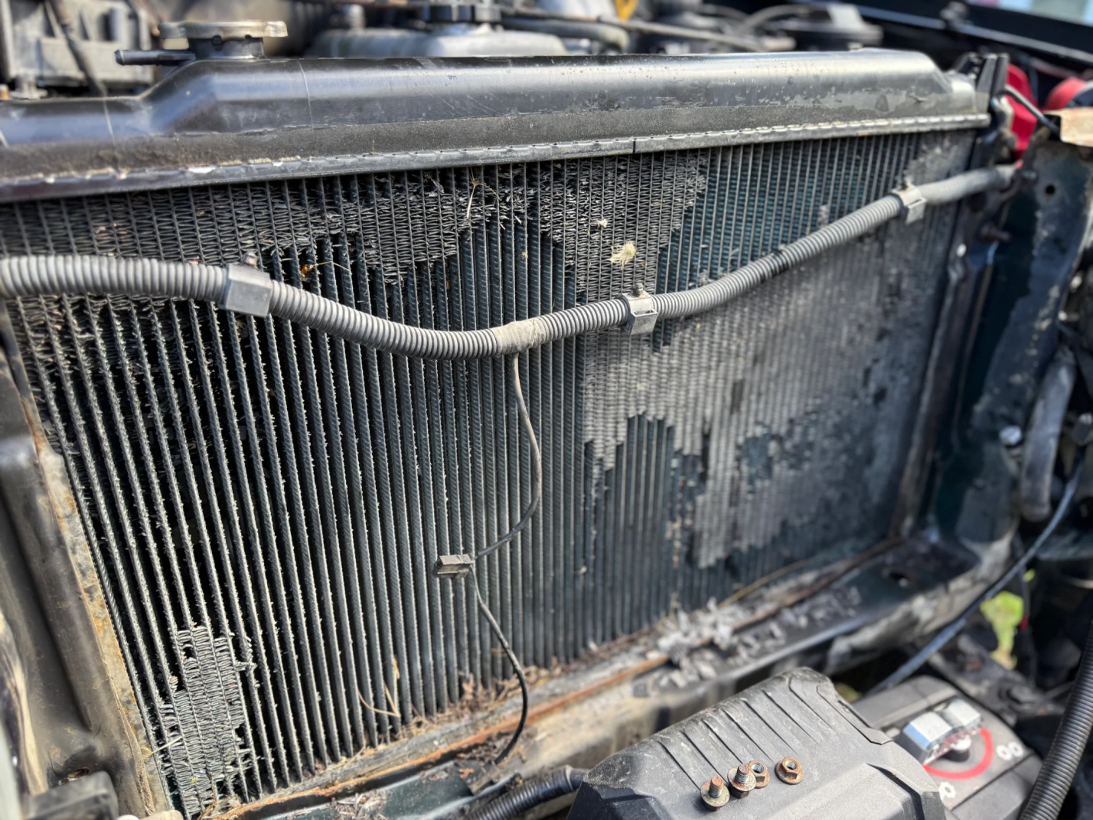

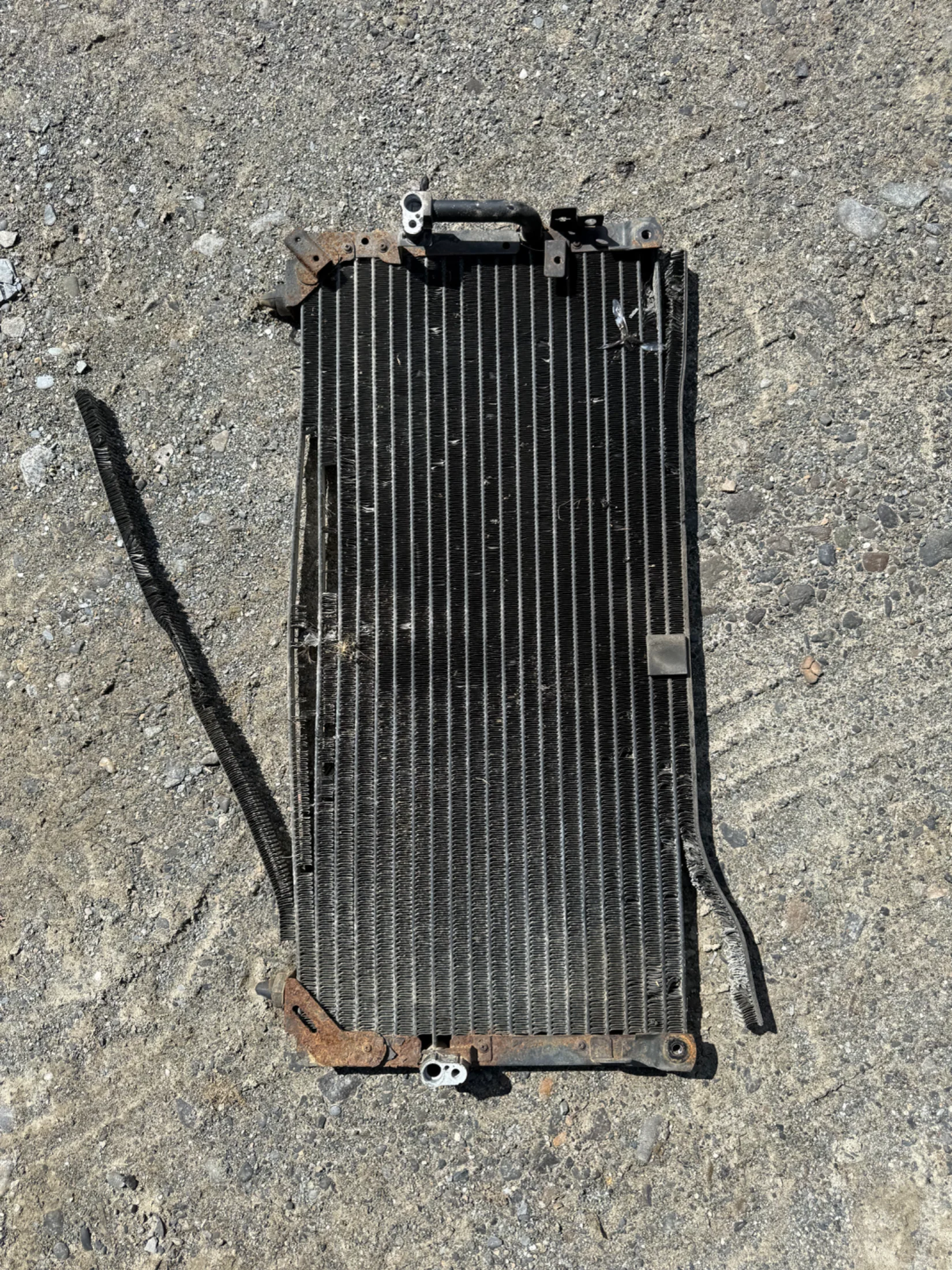

Here are the factory radiator and AC condensers I am also replacing...

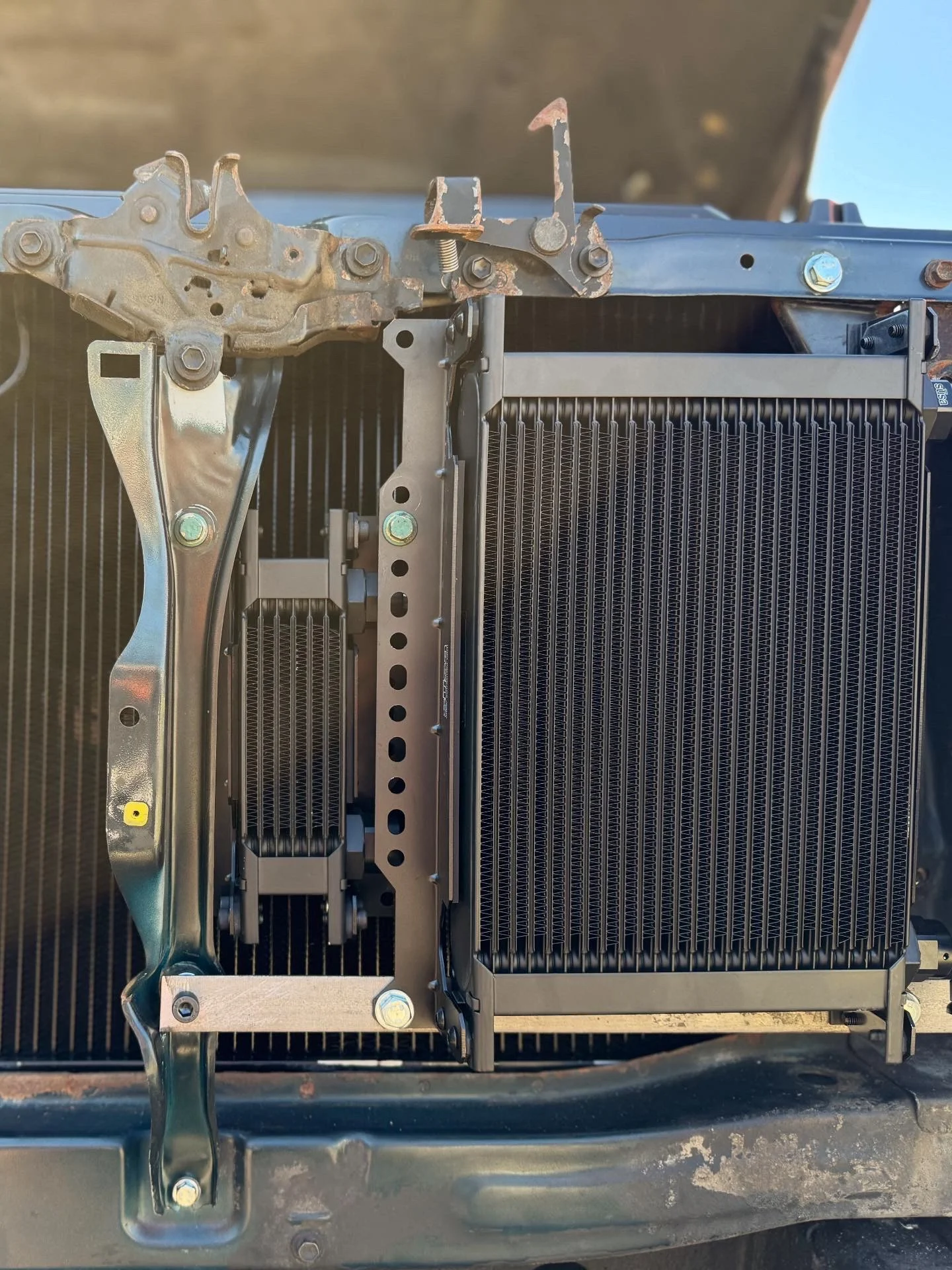

Can you post a pic of the new trans cooler? I have a Derale stacked plate and fin cooler on a shelf waiting to go into my new build. It’s 2” thick, 19 rows and 10” between ports. I’m no engineer but it seems comparable to the stock cooler.
I looked up the part number you posted but their site lists all series 6 coolers with PN’s beginning with 50-xxxx.
It's on its way so no physical picture but dimensionally they're the same. The Setrab just has twice the passes. I've used Setrab in the past on multiple race cars and trust their quality.
That’s a lot of cooler, almost twice the area of my Derale 13403 which is rated at 37,000 btu’s and up to 26,500 gvwr. You might run too cool during winter up north.
That's a great point, but I already have a solution.
Thermostatic bypass valve
I like the 30 row aftermarket coolers. Fits perfectly
I went searching after I posted my question and did see that exact ad on eBay. Seems like over kill. I have on the shelf waiting to go in a 19 row by 2” thick stacked plate cooler. How thick is the oem cooler? Much closer to 1”. I tossed the two I had so don’t have one to measure thickness off. The 19 row should add cooling capacity over the oem unit. 30 rows is about double the capacity. The OP knows this and plans to use a thermostatic valve to keep the trans from running too cool. I ran hard in high temps with the oem cooler for ten years and never saw 200deg and during 30-40 degree winter days 140 always. The thermostat adds complexity that I don’t want to have to deal with. A buddy of mine runs the same 19 row cooler I have on the shelf and his temps range from 160-200 living in So. Cal. Seems about right.
