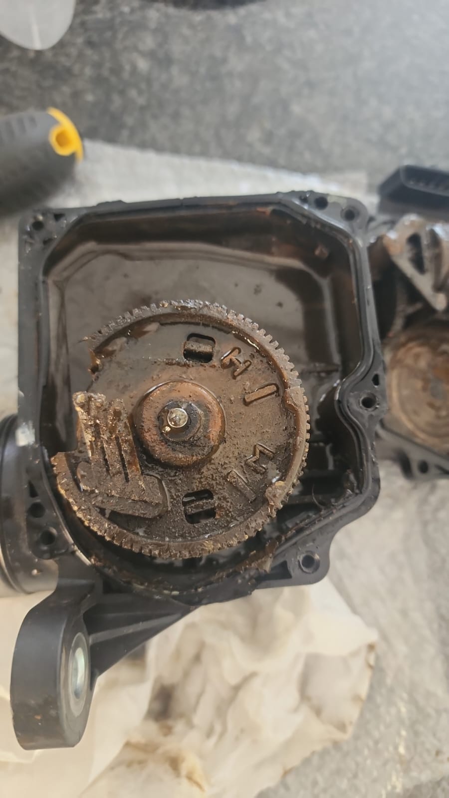

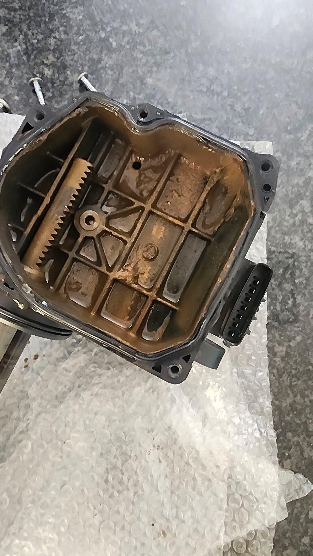

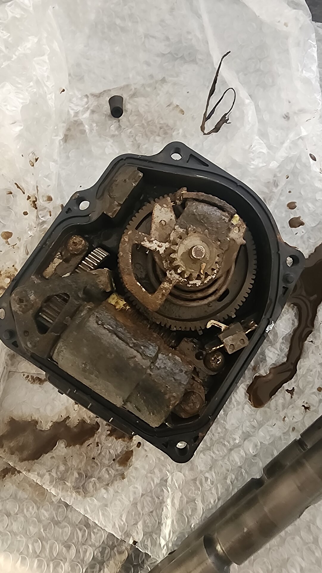

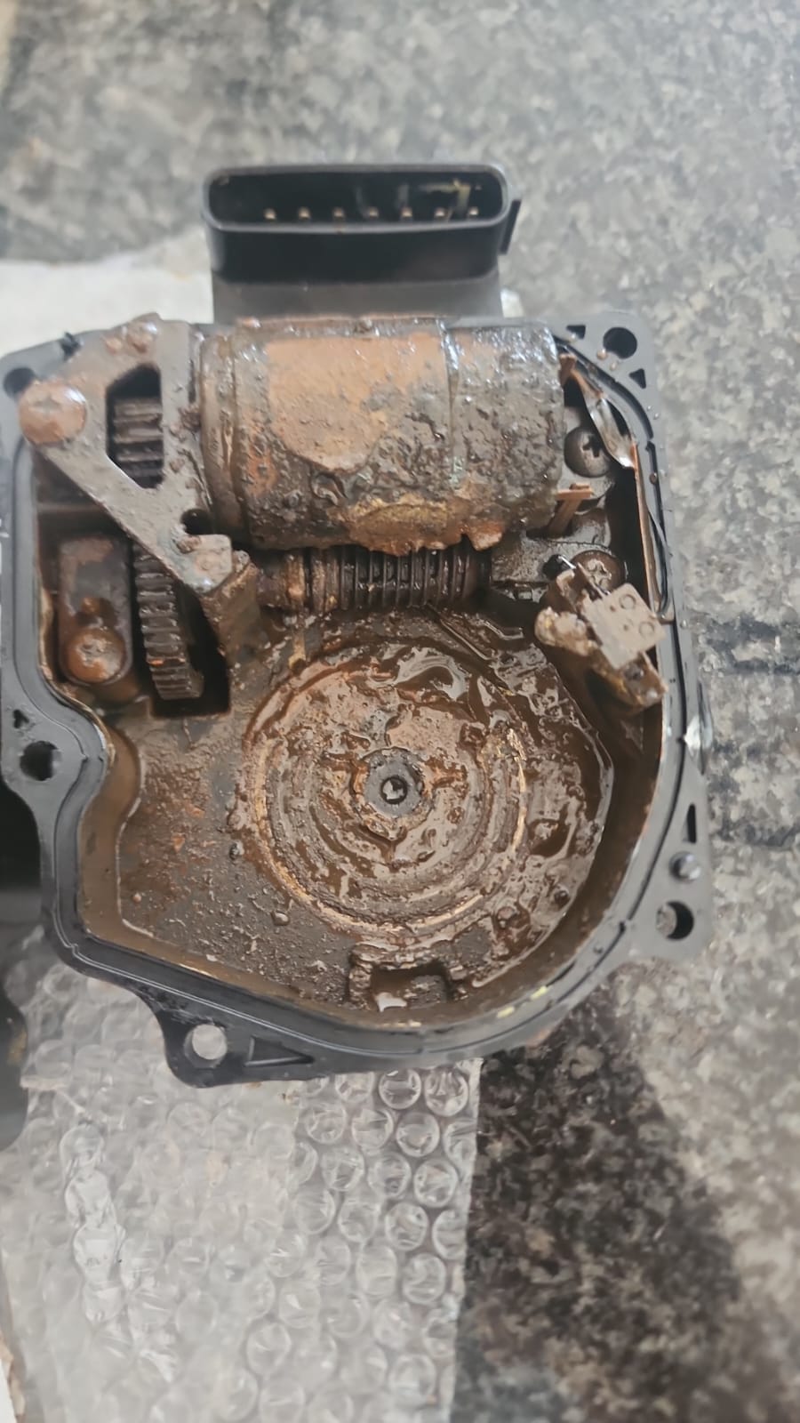

Now on my 3rd transfer case actuator failure in less that 4 years. I finally managed to confirm that it's due to water and contaminants (lots) entering the actuator somehow. Other threads here indicted that breather line could be the cause and found it was somewhat perished.
My question though is could this amount of water & gunk have entered through the breather alone and if not, where could this be coming from. I have never waded through any deep water with the verhicle and only wet driving ever done was though rain and normal size puddles.

Did you replace the entire actuator assembly previously or just the motors? Were they like this or just rusty previously? Did 4Lo and the CDL both not work previously or was it just the CDL?
There are only 3 ways I'm aware of for water to enter that housing.
  1. through the breather tube entry point on top of the CDL actuator motor
  2. through the seal between the main actuator housing and the actuator motor or a crack in the actuator housing itself
  3. secondarily through the transfer case itself, as the T-case vents into the CDL actuator. (I didn't think it vented into the 4WD actuator motor though)
Your actuator motor looks terrible. I've seen some rusty motors which obviously had moisture intrusion, but that's a soupy mess. You wouldn't necessarily need to ford a river to get that kind of mess in the top (CDL) actuator motor - if the breather tube had come off or just had a big split then you'd have a fine mist of rain water constantly being sprayed across that breather spot and allowing water and road dirt to seep in over thousands of miles. The pics definitely look like there's water involved... I can't tell if the rest is just oil or dirt or both?
It looks like both actuators CDL (top) and 4Lo (bottom) are a mess which means whatever moisture was entering most likely made its way into the transfer case too, so you should definitely change the fluid in the T-case.
Honestly with that mess I'd want to drop the transfer case to do a full inspection. I don't think the transfer case vents into the 4WD actuator motor housing... if it does then yes it could just be a bad or disconnected breather tube letting moisture in and enough water migrates through to the transfer case and then the lower 4Lo actuator motor housing. But it could also be a crack in your housing or something else letting moisture in. And if there's been water in the transfer case for a while, personally I'd want to open it up and make sure it's all cleaned out and try to inspect everything for rust or significant wear before replacing the t-case oil.
Once you're done I'd run a new breather tube from the CDL actuator motor vent all the way up to the firewall and replace the breather vent at the top. I don't have a pic handy but I believe the t-case breather is somewhere on the firewall just below or behind the master cylinder, however you could run a new line to anywhere you want so long as it's near the top of the engine bay. Just make sure you get a Toyota one-way breather vent for the top of it so hot air can escape but moisture can't get in.

Appreciate the reply,
So the full actuator assembly was replaced both times (I unfortunately never saw the first failed unit myself) and not just the motor units. The second one I have in my possession and have seen the new unit on the car myself. That obviously required the TK to be dropped. On both occasions there was no water present inside the TK and everything inside was found to be in proper working order.
This last time around after having no real feedback from my Toyota dealer /agent regarding the possible causes I took the vehicle to a gearbox specialist whom, after dropping and opening up the TK confirmed that it had no defects ie no water found inside either.
The gunk inside the actuator unit was definitely water, particals of fine dust and grease. You're correct in that it was both CDL & 4LO that was contaminated. Initially the car would not engage CDL only but then progressed to 4LO light flashing intermittently. Finally the car just wouldn't go into gear when shifting into D or R.
I'll be replacing the CDL breather vent line as per your suggestion next. Also thinking of doing periodic inspection of the motor units to see if any moisture might have gotten inside again.
Thank you again for the advise.
