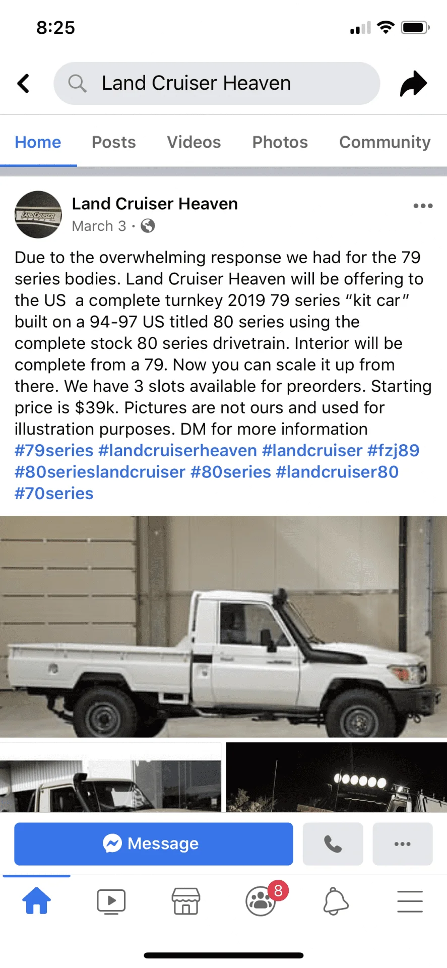

Land Cruiser Heaven is reportedly offering completely built trucks, but I do not know if they have accomplished this yet.
You may want to ping Frank and check in.
Interesting
Maybe I'm crazy, but $39k seems low. I guess that "starting at $39K" is pretty vague in what you actually get. I suppose this is one way to get a 79 in the US.
I think that is a VERY reasonable price point for a complete truck.

If I'm not mistaken Proffitt's was charging considerably more than that years ago and that was for a gas burner. If $39K is a fair price point, I'm way over budget.
Yeah I thought of you on this Charles. I don't know if that $39K is the "we put the body on the frame and give you a VIN" portion or what it entails but still seems cheap. They do diesel conversions starting at $20k. 1HZ starts at $15k
You are buying an 80 series (unless rebuilt will have at least 150K miles), frame modifications, body modifications and were all those 79 body/bed combos
I think @Onur is right, it appears a lot may be sourced in SA. They say sourced with 1FZ and manual.
Although I will say I have NO idea the quality of their work. $39k could be a stellar price for that work, or a nightmare just beginning.
Onur would need to confirm but I believe a new 1HZ from Toyota is probably close to $12-14K.
There is just no way that any business can offer a turnkey 79/80 for 39k , a private person with the right connections and time to wait for the right donor deals and free labor might be able to get close to that number but anyone at an hourly rate that needs to make a profit can’t even come close to that.
