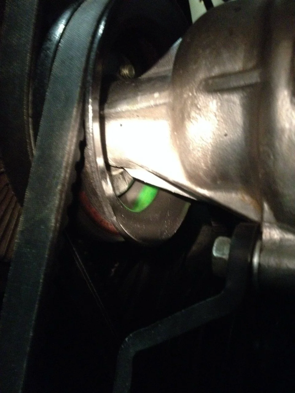

Help with a coolant leak problem, please:
Installed a new OE Toyota water pump, all hoses, radiator, heater valve, two years ago... Less than a 1000 miles.
I'm chasing a strange coolant leak that I can't duplicate. Pressure tested at 13 psi. No leak. No loss of pressure. I 've run to operating temp. No leaks with engine running or stopped...
Not going out the tail pipe. Don't see coolant in the oil.

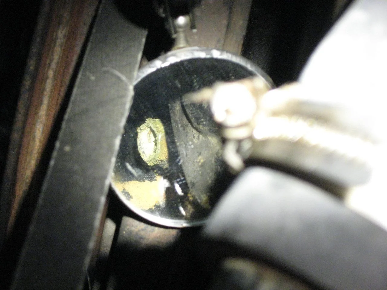

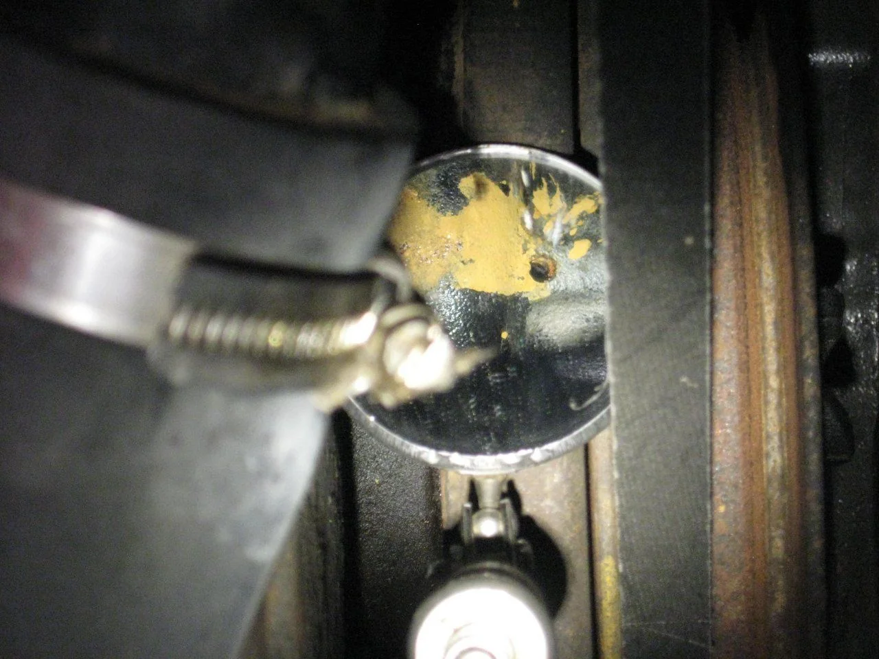

But I will occasionally overnight, find a dried puddle of coolant under the front of the motor and found this (see pix) from the weep hole? But it's always dry when I check it. (I've checked the weep hole with engine cold and pressured to 13 psi, and at operating temp).
I can't find evidence of coolant loss anywhere else.
I guess new pump could be bad? If yes, why the intermittent leaking? Bad seal?

If the weep hole is weeping your water pump bearing and or seal is going. In my experience they don't self mend and fail spectacularly on me soon after they start weeping. Was the pump NOS or a rebuild? Are you running your belts super tight? 1000 miles is a terribly short lifespan for a water pump.
Pump was New in the box, purchased from American Toyota. I think I got one of the last ones available... Belt is adjusted properly, and new HD Gates.

I guess the hidden purpose of this thread may be to talk myself out of denial . :p
But if the seal were bad, it should leak under pressure?
Q:
Wonder if it's possible to leak from the backing plate and 'wick' up the bottom of the pump to the weep hole?
