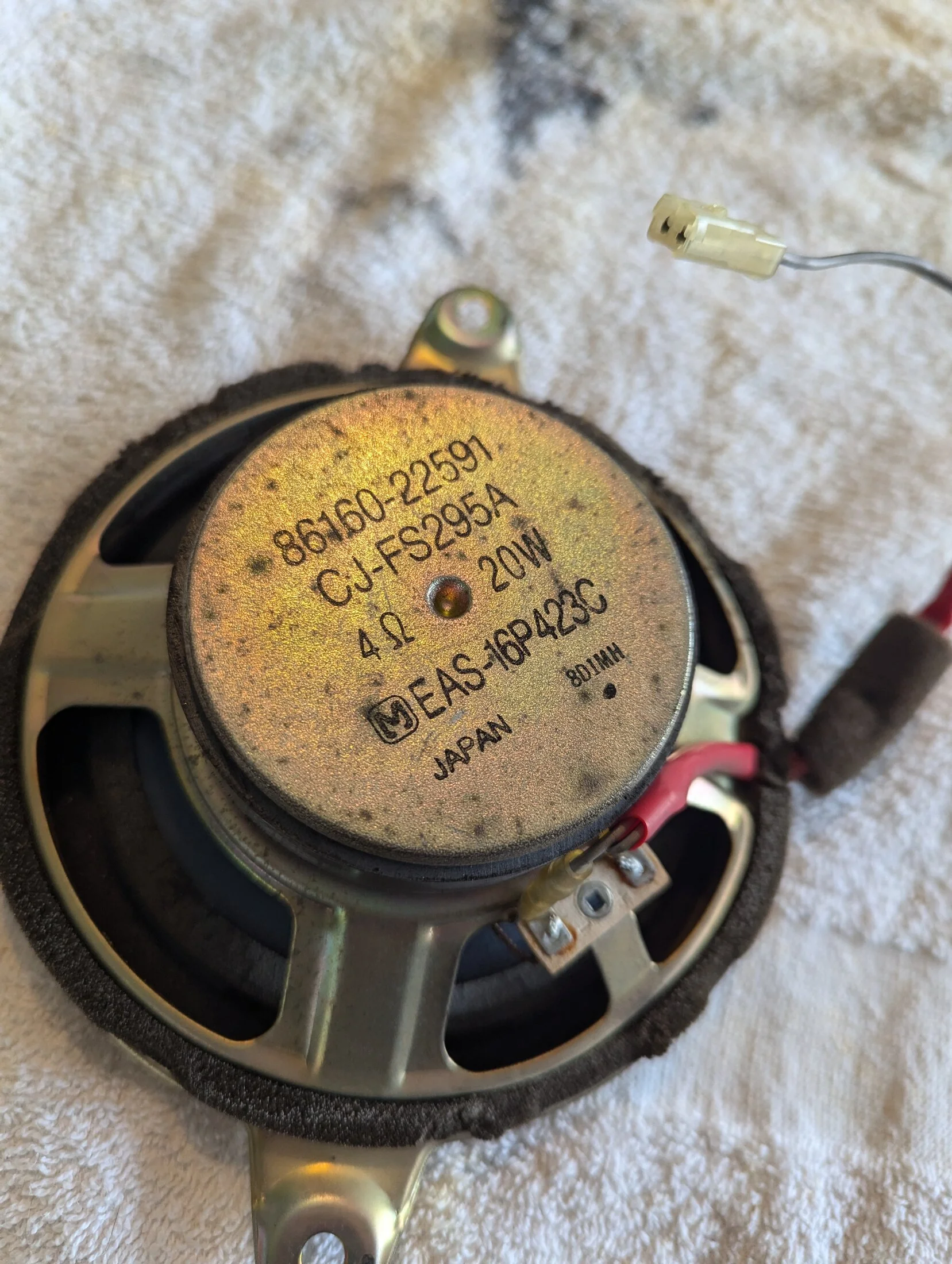

I recently picked up an 1999 HZJ77 and the trunk speakers are rotted out. They are roughly 6.5 inches. Before pulling the trigger on a replacement, I wanted to see if anyone here on the forum has done this before.
Any issues with the 24v system? I know some of the electrical system is wired for 24 volts. (Learned this the hard way when replacing headlights) But my wiring diagram is in Japanese so it is difficult to read.
Is there an aftermarket equivalent to the speaker that fits correctly? It seems most aftermarket speakers have three or four holes for bolts, whereas the OEM has two. Not opposed to doing a little modding to get it to fit but just wanted to check.

I replaced mine, they're in my build thread. But my system is 12V not 24.
Requires use of the tabs on the ring of the old speakers - at least the ones I used did.
12v vs 24v will make no difference WRT the speakers. They are passive and powered only by the head unit, not the battery / alternator. You'd only need to be concerned about the car's voltage if you're replacing the head unit or an aftermarket amplifier or powered subwoofer.
12v vs 24v should make no difference WRT the speakers. They are passive and powered only by the head unit, not the battery / alternator. You'd only need to be concerned about the car's voltage if you're replacing the head unit or an aftermarket amplifier or powered subwoofer.

4 ohm, 6.5” speakers are fairly common aftermarket, though you might try to find some on the lower end of the wattage needs, so you aren’t trying to drive a more high powered speaker (thats designed to receive 100watts or more) with the relatively small internal amp of your headunit.
If you want to avoid distortion at higher volume, you may want to consider adding an aftermarket amplifier and possibly a new headunit. They do sell 24v headunits, but you would have more variety if you used a 24v to 12v stepdown converter.
That said, plenty of folks on here are happy with the results by simply changing out their speakers for ones that aren’t made of 30 year old paper cones!
