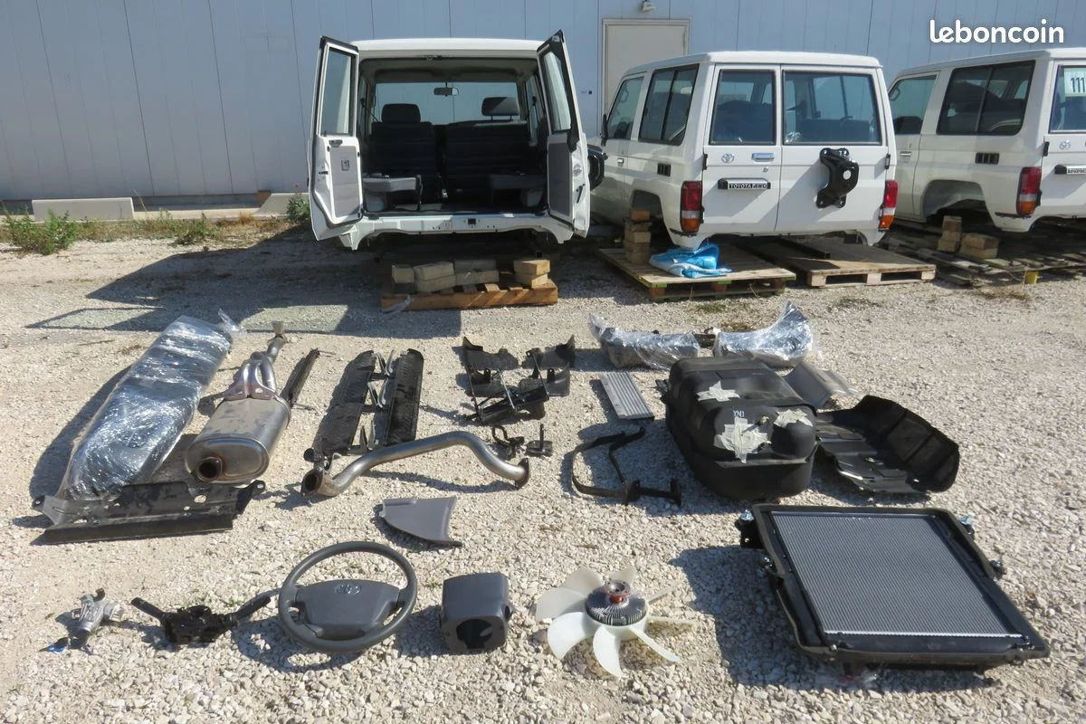

Over here we can find brand new modern GRJ71 body (like everything body and interior) for sale (probably from companies using the chassis+engine as base for a military thing) and people are using them to "restore" older LJ70 or HZJ71 in swapping the bodies.
But do they come with airbags? A lot of middle eastern vehicles are sold in places where there are no modern safety regs
Seems like they have driver airbag but not the optional passenger airbag (but a 2nd big glove box !).
And here is a Land Cruiser specialised garage that just used one of those to restore a HZJ71 :
