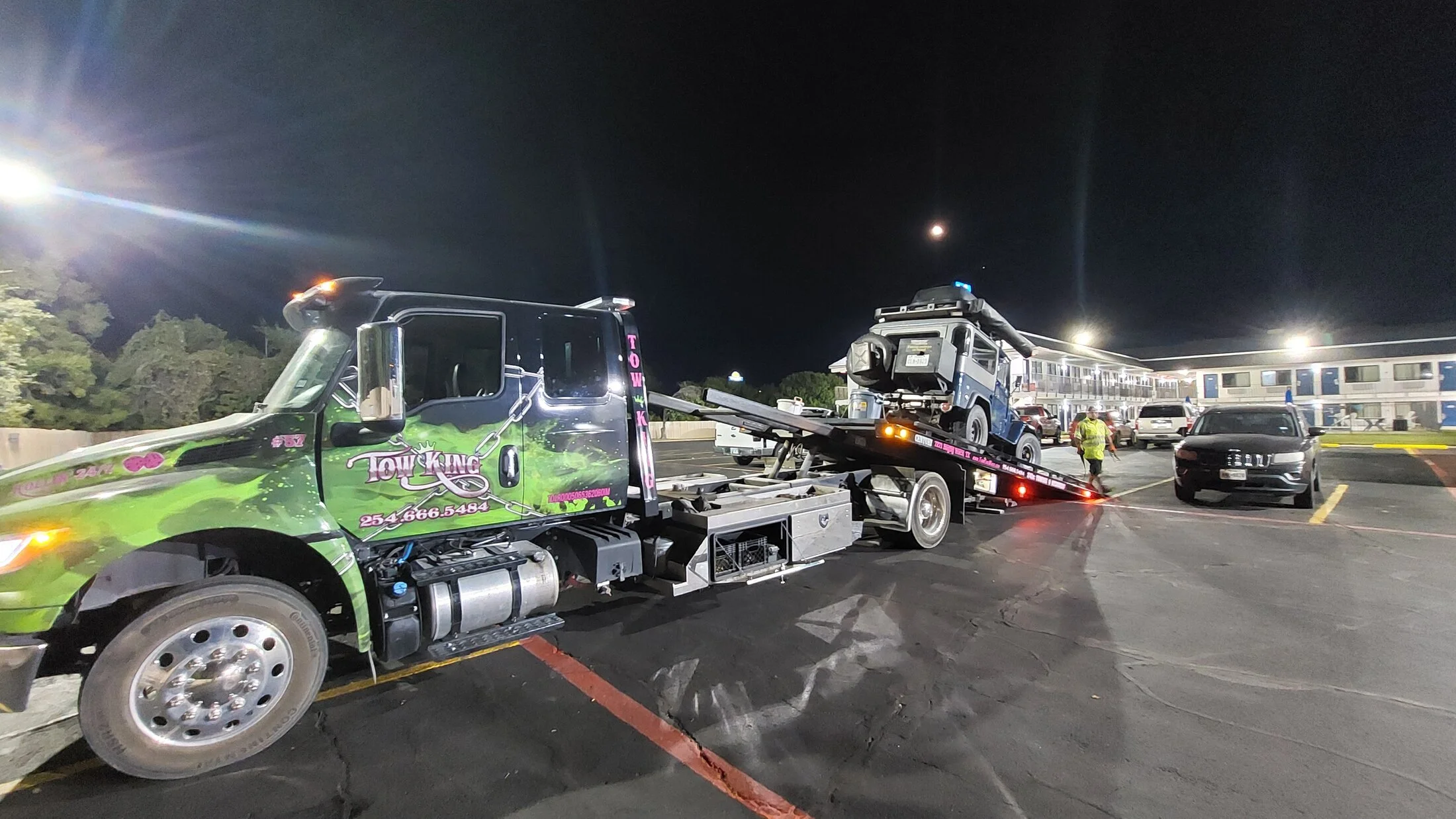

I'll go back to stock, but this works great. I sure wish that I would have done this first... We ended up towing the truck to a motel and I got it on the road the next morning.

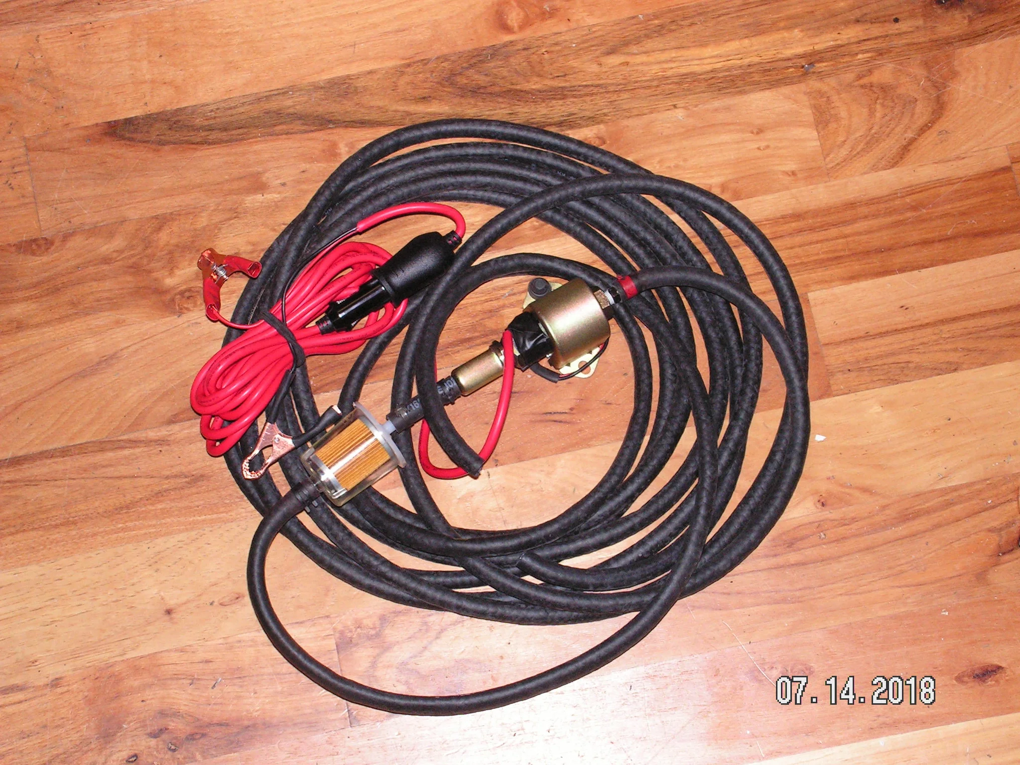

Glad it worked out for you. My electric fuel pumps are very handy, beats holding up 5 gallon cans, especially when you get older. I have made up about 10 of the for friends and family. My older sister has used hers to do Diesel for her truck. It is fused, filters the fuel for trash and water. I buy a 25' roll of fuel hose off ebay for like $25. 5' goes on the suction side and the other 20' to the delivery side. The water proof switch is like $5 and the 12' fused cig lighter extension cord is $10 plus a $3 filter and $2 for the battery clamps on Amoron. I usually keep it in the tool box under my drivers seat with a starter, dizzy cap, an old plug and coil wire
